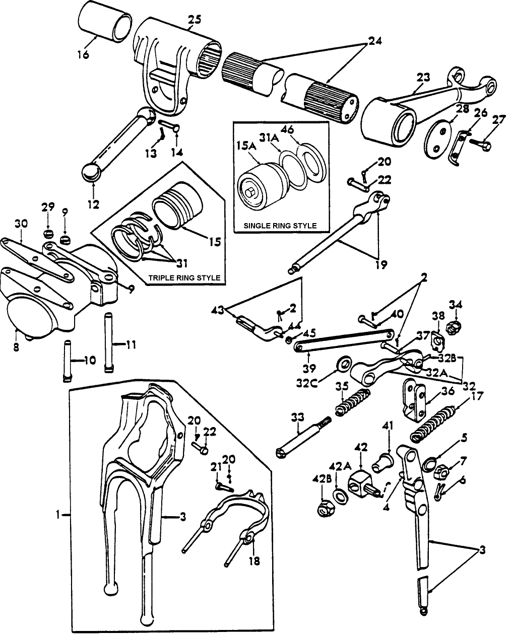

Found the parts from Yesterday's Tractors still don't know how to get the top plate off. The book I have talks about removing the side plates to disconnect some fork from the control valve?? I don't have a schematic or exploded view to work from. It appears that the pin I need to remove cannot be taken out without removing the top as the pin is to long to slide out enough to release the "Draft Control Spring Plunger" from it's fork. I think this may have been intentional to prevent possible dropping of the pin into the gearbox if the cotter pin came out.

As the directions told you, remove the side round inspection covers, reach in and spread the control fork that hangs from the top cover down tot he pump.. this control fork will be hooked to a 'T' shaped part which is connected tot he control valve. If you don't spread the ford and remove if fromt he t-valve.. you will break it then be in for a might fine repair job.

Here.. I did your homework for you.
Here's a schematic of the valve, and a schematic of the lift control fork on a 9n which will be very similar to the one on a fergy. Heck.. the fergy valve even still carries a 9n (ford) part number prefix. The t valve sticks out o fthe pump, and the control fork hangs from the top cover..
soundguy

Thanks the pic was a big help it allowed me to identify the control valve. I got lucky in removal of the top and don't think I did any harm to the valve or crosspiece. I couldn't see what the forks hooked to and don't think I spread them coming out. Finally got it back together and fought the forks on, only a few cuts.
when reassembling the top portion the replacement part was a little different in the plunger rod is stepped up so I had to open up the hole in the triangular guide to 11/16". I think the heavy top spring may have been broken in the past which is likely what caused the plunger to break. The on on the tractor is closed on one end only and the other end is open and rough like it has been broken. If anyone has a Fergy would you look at the spring and see if both ends are closed.
