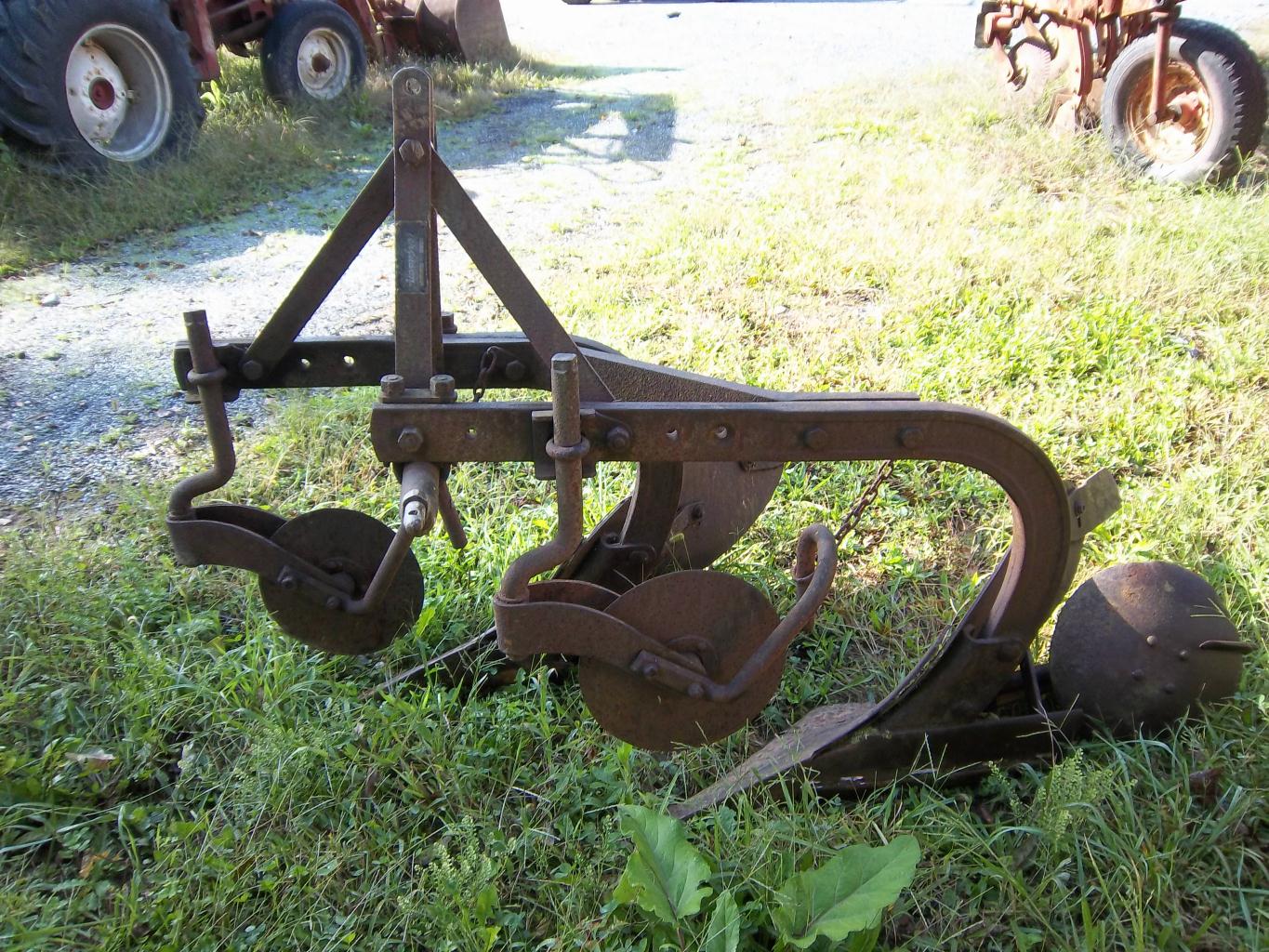

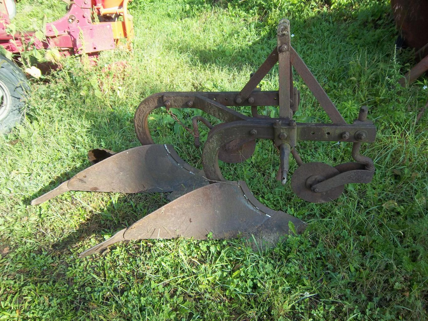

I've been looking for a two bottom plow and came across a Ferguson 12-AO-28 plow. It's located at a local dealer and they want $450. Do you think it's worth it? I could sandblast/repaint it for around $100. Also would my 4310 have a problem pulling it? It will be used to plow about 3 acres once a year in a shale type soil. Thanks

Cant see the bottoms (shares) but it looks like it will work fine check for craks and welds Price is high though approx $275-350 round here

I was thinking of offering around $250-300. By the picture it looks like it has been sitting for awhile.

That price seems a bit high to me as well. About 4 years back I purchased a Dearborn 10-152 plow (2-12") for $150. The plow is in good shape and had decent paint but no Coulters. Since that one seems complete and assuming in good condition except for rust and paint I would agree to offer $250~300.
I don't think you would have any problems pulling the plow with your JD. I think the usual measure is about 1hp per inch of plow. I am not familiar with you type of soil though.
