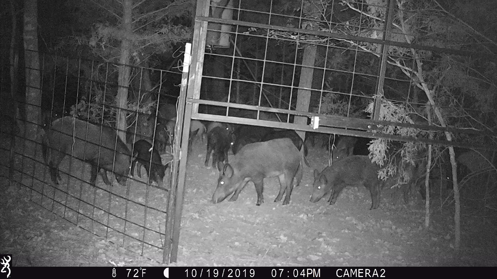

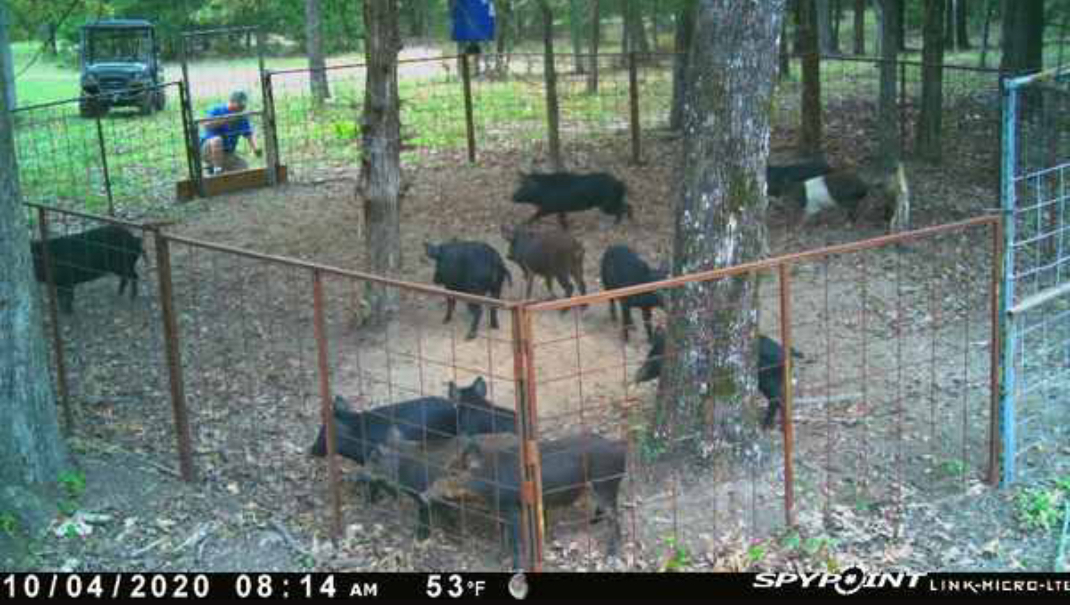

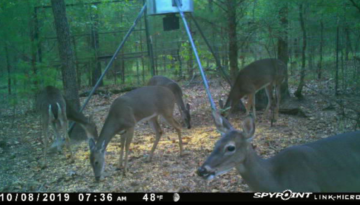

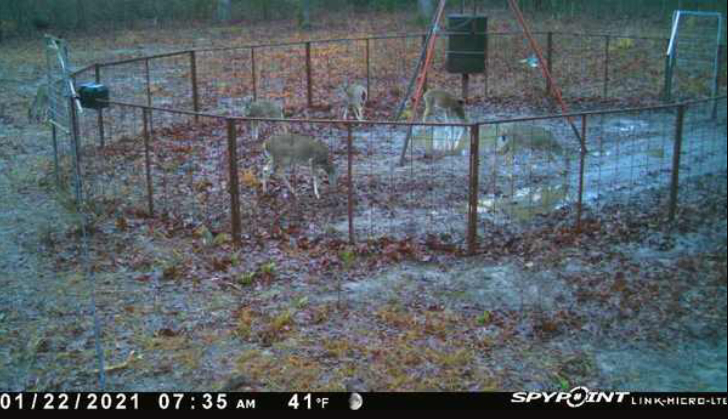

All of the little traps I have made seem to become ineffective pretty quick as they become wise to them before you can catch many.

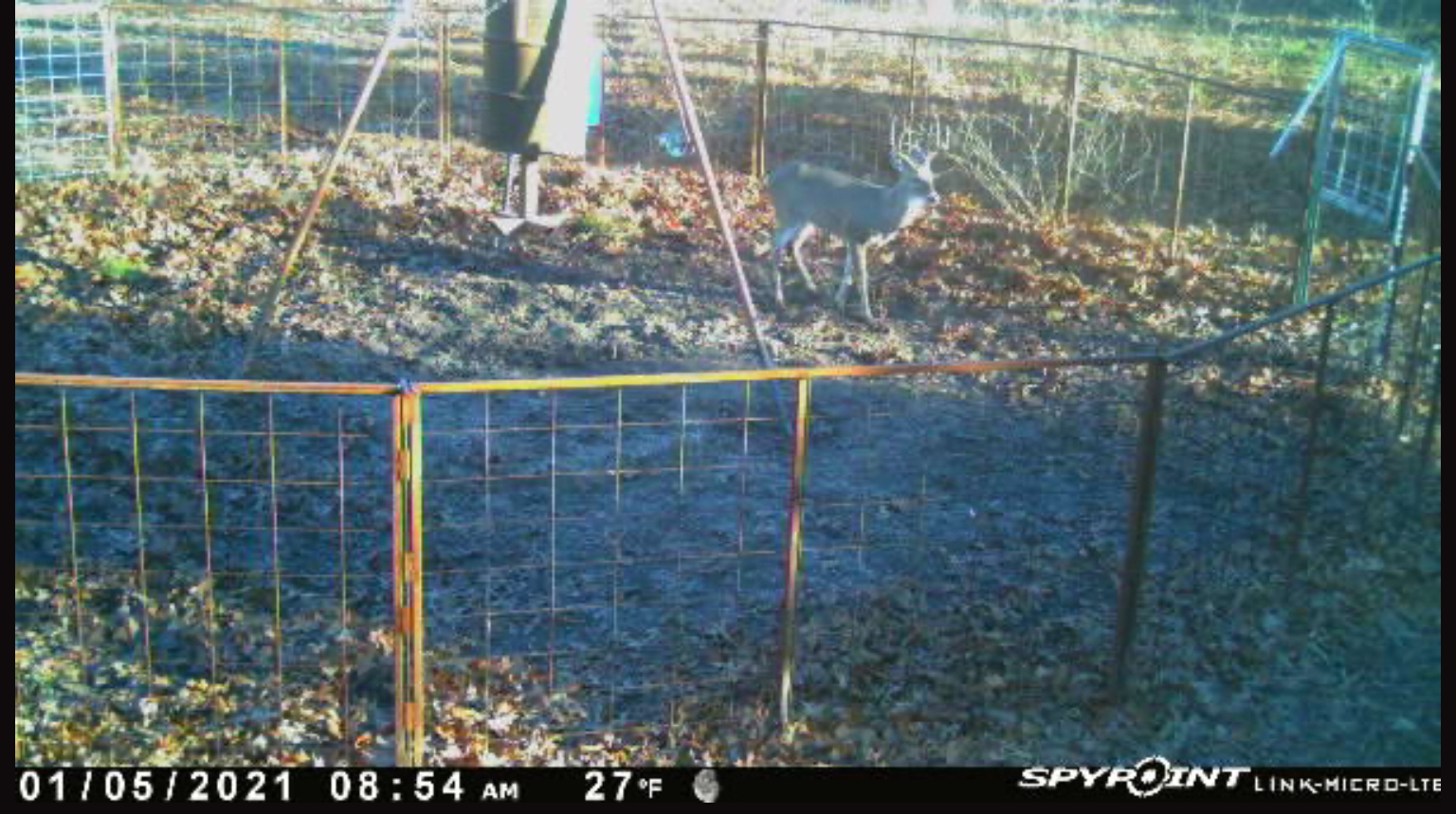

So the first big trap I made was just in the woods along a trail they used. They already were going to feeders that had cattle panels with holes cut in them so deer could eat but cows couldn’t knock over the feeder.
Set it up and left it open for awhile so they could get comfortable with it. One 8ft wide gate at either end, so they could stop and eat or just keep going as normal.

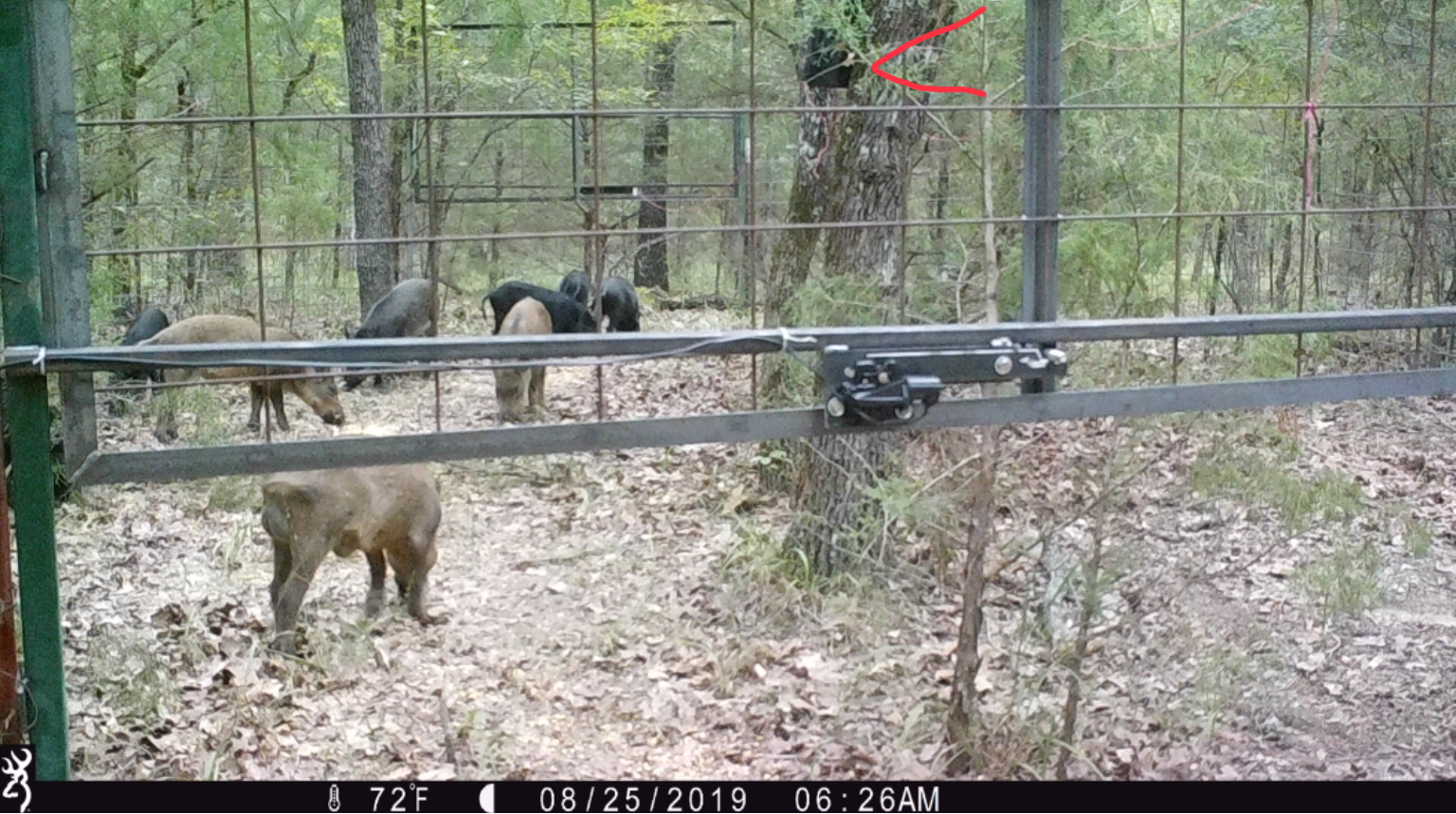

At first I used game radios I had built (arrow) to let me know when they were in there and called a $5/month cell phone controlled trigger and activate the solenoid (former trunk release) to drop the gates.

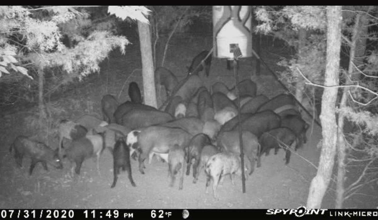

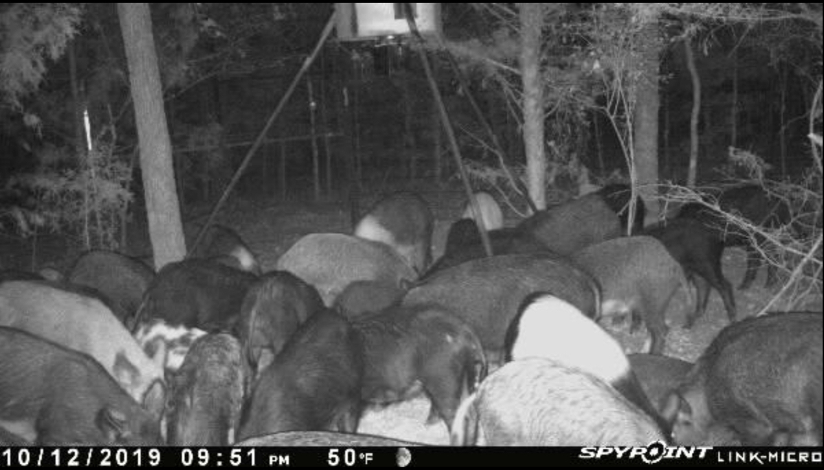

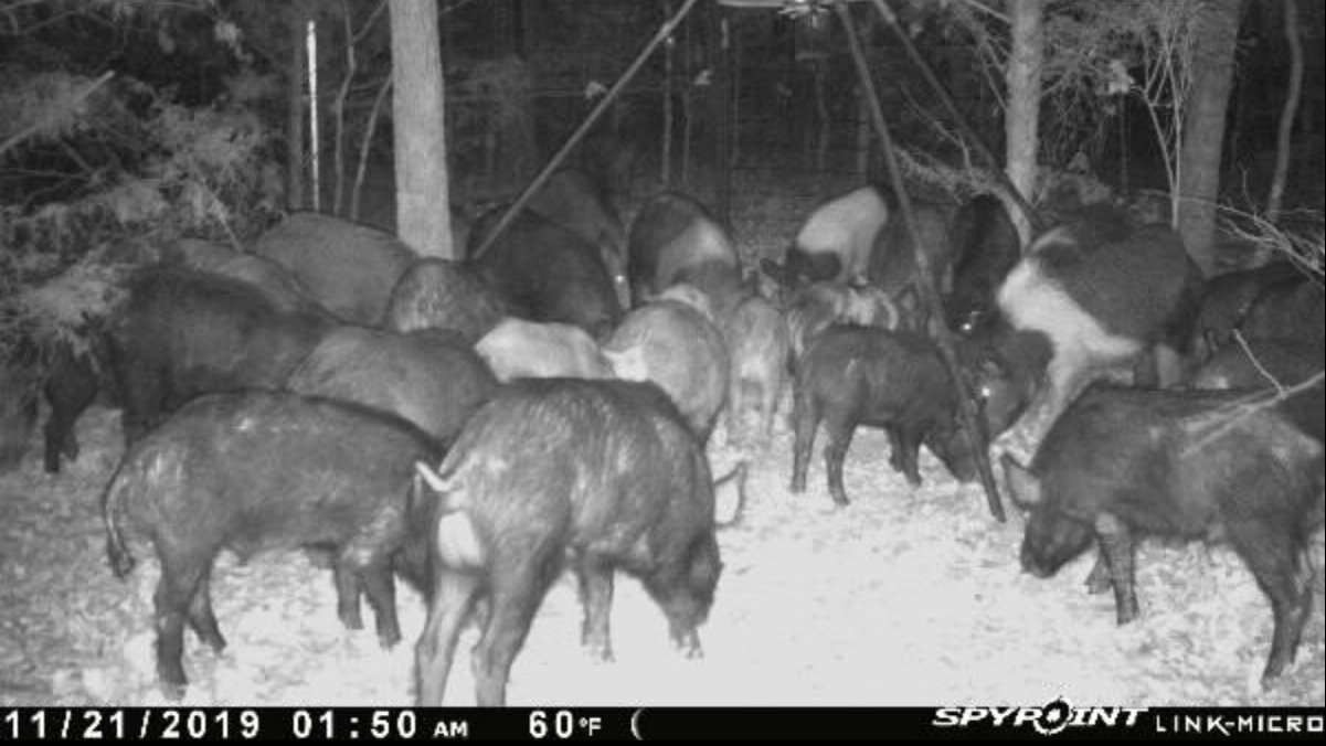

Lots better at hog eradication after I switched to a cellular game camera, so I was sent photos of them as they trickled in and wait until they all finally went in to drop the gates.

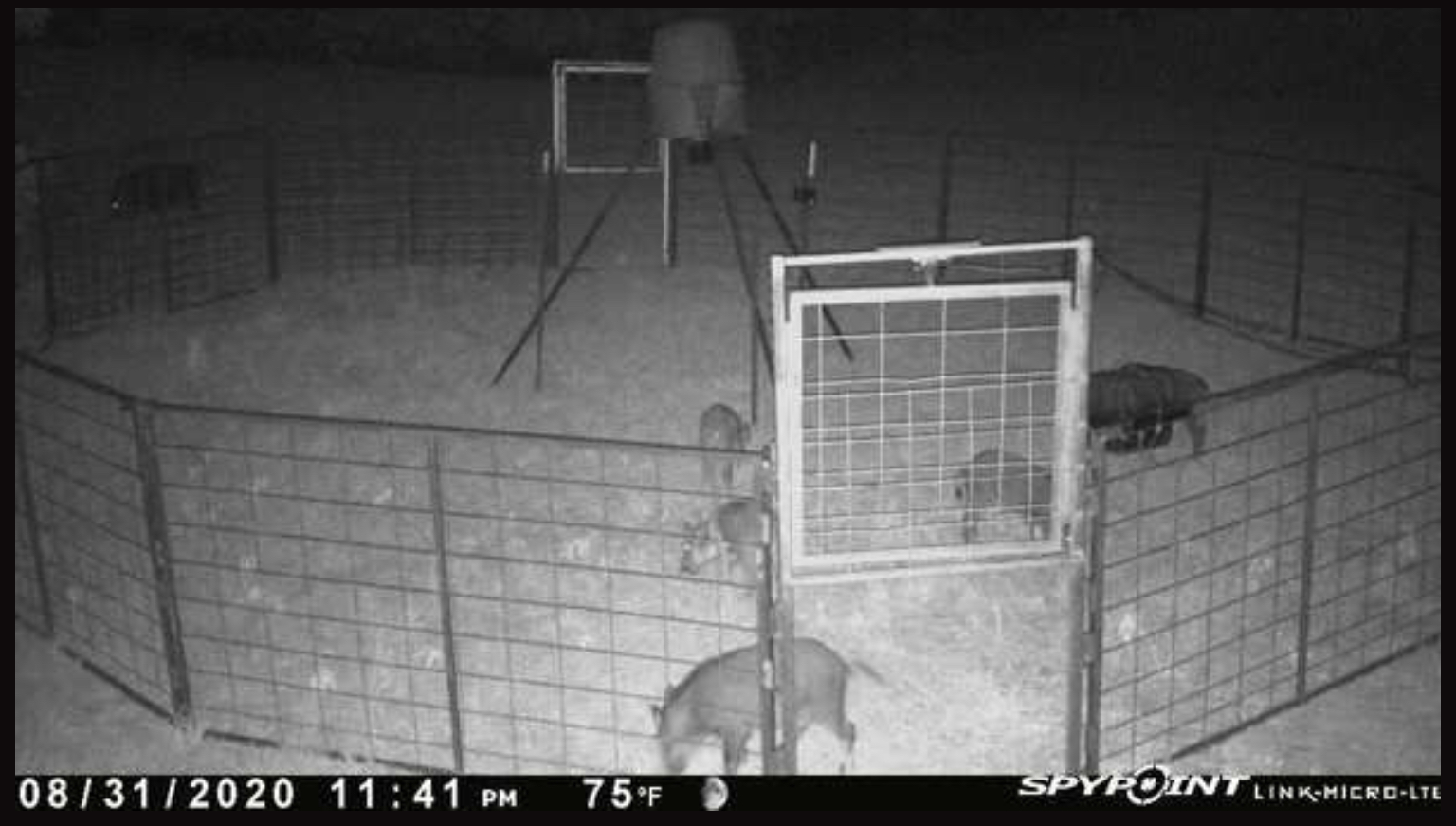

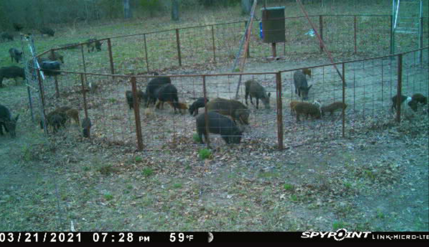

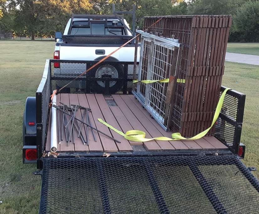

It worked well but after we killed hundreds at that particular spot, I needed to move it to other problem areas on our place. Decided it would be too much work to move it so I built a more portable version that didn’t require lots of trees to anchor the panels to.
Then just move it to the location you want them gone from and wait for them to get acclimated to it.

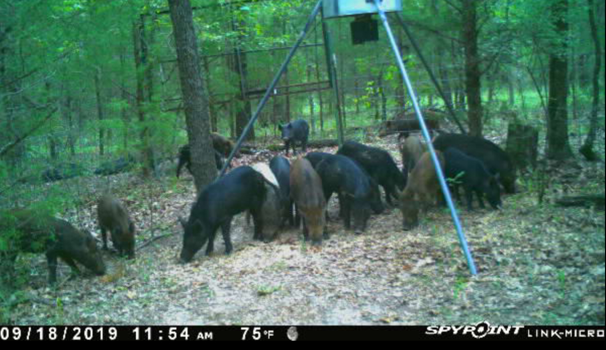

If I put it around trees I throw a 1/6” cable over a limb and hang a bucket feeder, easier than moving a tripod.
And get them all.

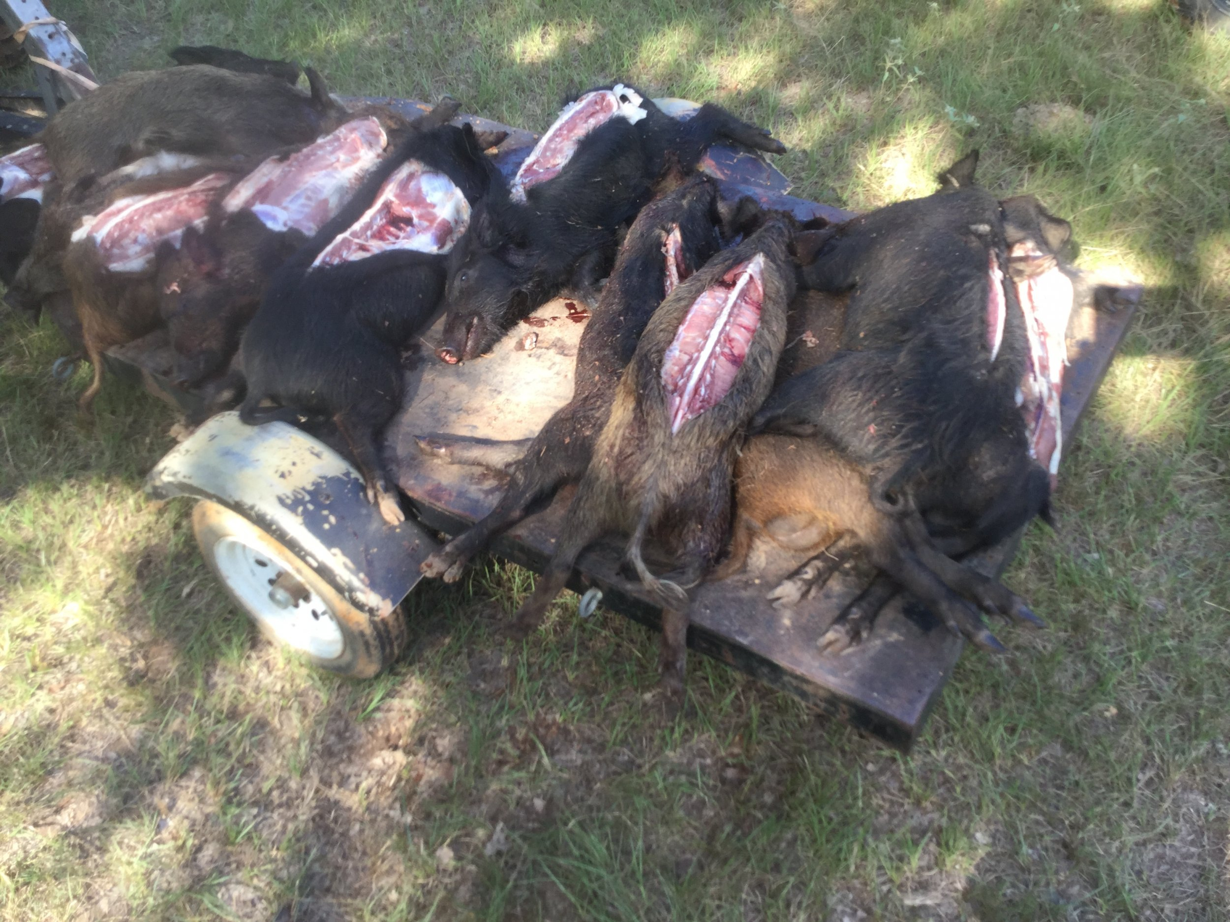

I am not young enough to dress out many at once so I generally just back strap them and feed the buzzards with the rest.
After you knock back their population and their pressure on the deer, they start flowing in to fill the void and you can move on.

Your approach is by far the most effective way at reducing their numbers. I'm fortunate that I know a guy who loves to sit in my deer blind all night and shoot them with his thermal, but for getting rid of a lot of pigs as quickly as possible, you have it figured out!!!

Do you have a link?
The only ones I had seen from them in my research were smaller or used a bunch of T posts and no one seemed to share how to do a remote trigger, had to develop that from nothing and since t-mobile acquired sprint and Tell, they keep telling me the cheap simple phones I am using are not going to work on their 5g network at some point. So I am going to have to figure something out and I feel it really needs the parental control to only answer incoming calls from numbers already stored in the device.
