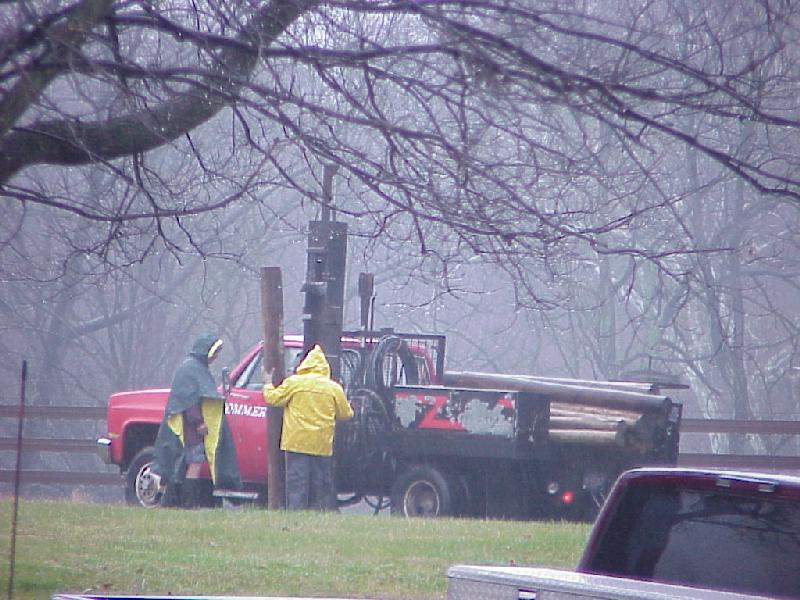

All,
This is what some fellows used to pound 86 posts in about 5 hours .
Have a good one,
Neil.
