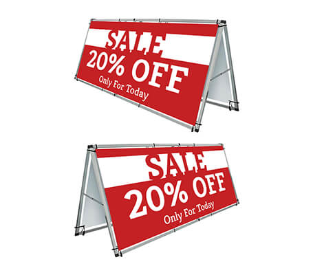

Buy or build your own. No post driving needed.
Flexible A Frame for all Types Banner | Banner Frame BannerBuzz

BuckeyeFarmer... most of our sponsors use the push in signs at the teeing area, but a lot want a bigger banner for a larger donation...
