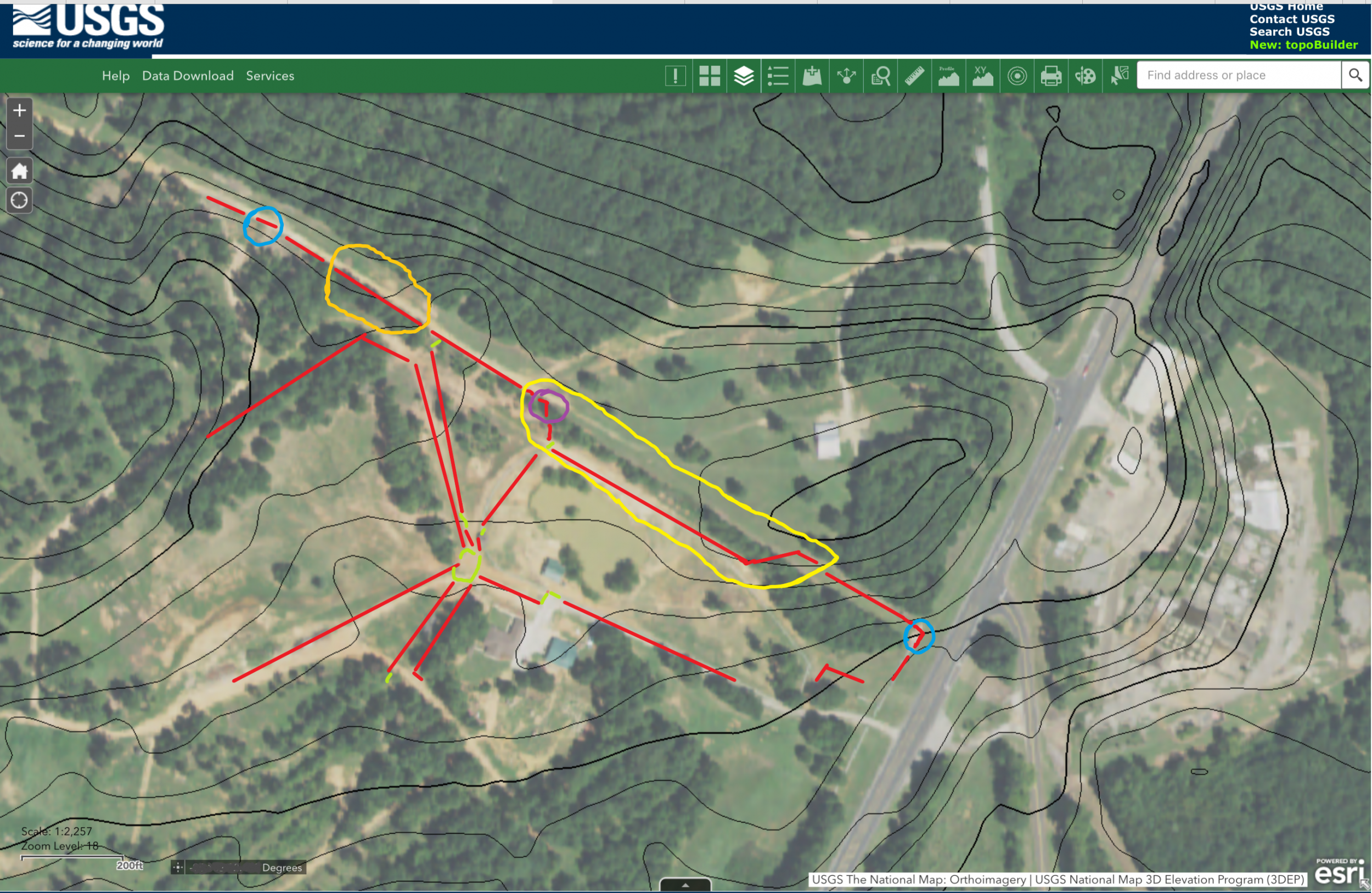

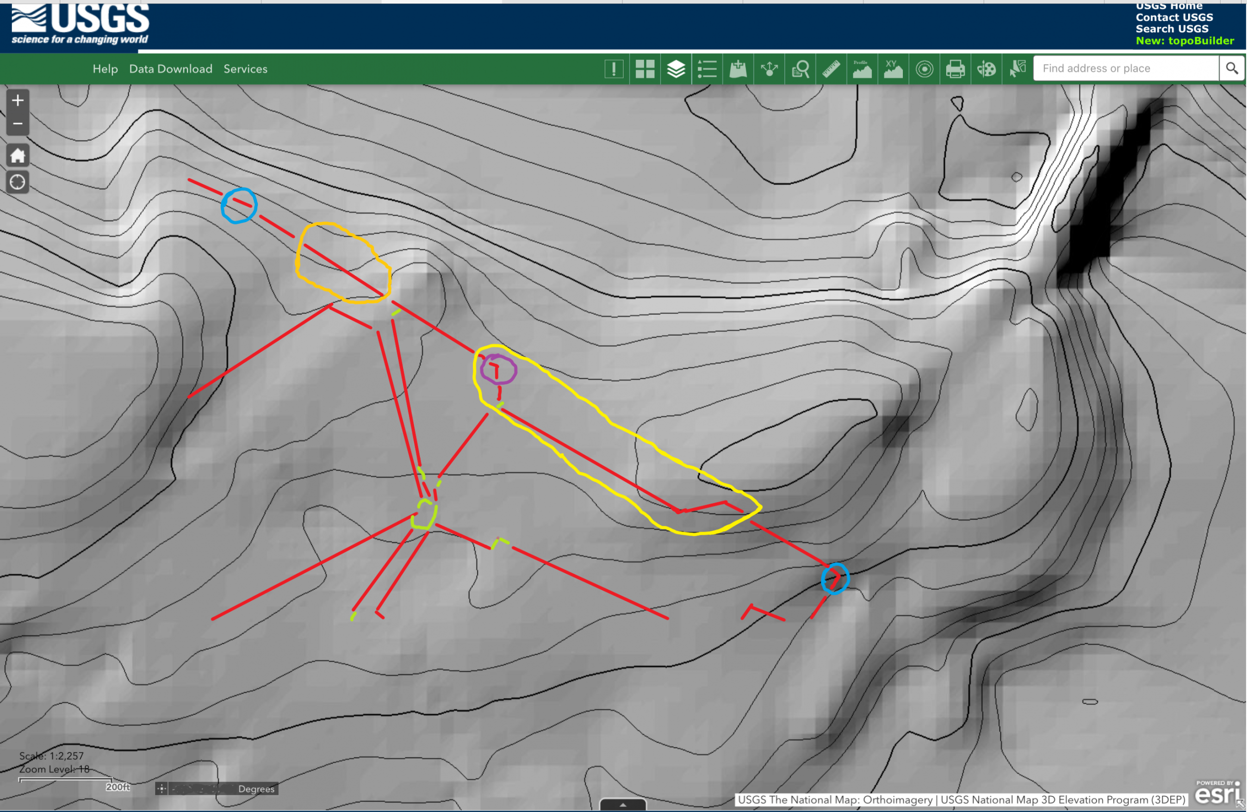

   / Fence Line App for my phone? #89
Eddie, you might find the USGS National Map useful for determining terrain and visualizing Plans. I took the liberty of overlaying your lines over a couple of screen grabs from the map. One is the stretched Hillshade and contour lines that are a product of drone Lidar. The second is an aerial with the auto contour lines included. You can move layers up and down and change opacity. There is also a measuring tool as well as determining elevation profiles, spot elevation, wetlands, etc. In our area of NY the hillshade shows small trenches and differences in elevation very accurately base on my observations. I did note the wetlands and hydrography in our area is offset a few yards from the terrain captured by the Lidar.
