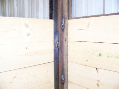

I found this stuff and its called horse channel down here. I got it at the place were I buy all my metal.

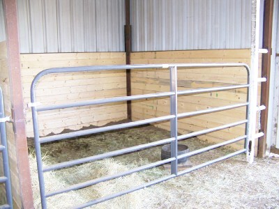

Here's what I ended up with - Found a guy to make the channels for $10 each. I used various sizes of boards that I already had.
/ Fence bracket/horse fence #12
saaayyy, that turned out real nice, sound like you got a good deal on the channel as well.
