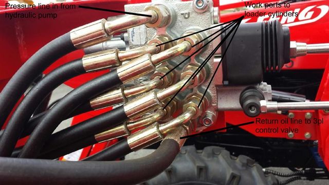

I had to replace the original 4 in 1 FEL valve on my dongfeng zb 25.

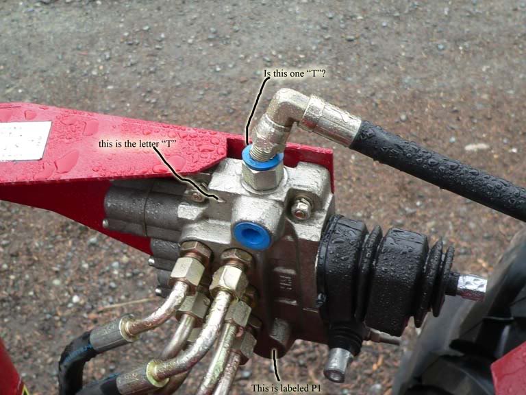

I cant get the loader to work. The P and T hoses flex with any directional movement and the bucket etc move slightly when using the controls. I notice the correct directional movement occurs very slightly but only in a very narrow band about half way through full movement of a control lever. Pressure will remain in the work hoses after shutdown until I move the levers back and forth. The 3pl is working fine.
The replacement valve is different to the original. I have asked a couple of times what the brand is to see if I could find an operational diagram but for some reason (commercial?) the question has been ignored. Unfortunately the tiny brand sticker got knocked and erased on installation.
Two photos: the first (taken from another post on this site) is the original valve. The second is the replacement.
I have configured the work hoses exactly as they were on the original valve. The P and T hoses are connected as shown in the second photo.
Is it possible that the work valve pairs can be reversed on different brands of valves (the hoses to the top and bottom of a cylinder)? And if so could this be the problem? Could there be another reason the loader valve is not working? I know for certain the cylinders and bucket are not seized.

If both the P & T hoses flex this would indicate pressure in the "T" line which would limit the loader movement. Did the new valve have an option for Power Beyond (PB) port and another "T" port? If yes you will have to connect the "T" port directly to tank. Some valves will not handle down stream pressure in the tank line and that is why they have both the "PB" & "T" ports.

The return needs an open passage to tank.
Do you have a PB outlet?
On the work ports, you could have the left side opposing the right side, and try to flex the bucket. Otherwise, one cyl is pushing and the other is pulling.
Install a hyd gage and use it for trouble shooting.

Turned out, of all the possibilities (there are 5 separate ports to place a pump or tank hose), the configuration I thought I had tried and had not was the correct one or as Murphy would dictate, the last one.
Another question. I am not up on pump terminology...what is the function of the adjustable screw with a locknut. Can be screwed in or out for about 2". It is located in the upper left of the valve just behind the pump hose in photo 2.

All I see is a silver can cover for the float assembly on the bottom of the valve.
The only adjustable item on the valve should be the relief valve, and is usually close by the IN port.
Do you have the PB adapter and is it installed.
This should be your configuration.
Pump to IN port of loader valve.
Tank port to return hose.
PB adapter installed and this hose goes to the hyd block or the remote valve or 3pt.

Thanks JJ. I did reply before but must not have pressed the wrong post button. I think the part I am describing is located near the base of the float assembly in the photo. The dark part being the locking nut. It is near the pump in port so must be the relief valve. What's the function and best setting?
No PB adapter. Have pump in, out to tank and 6 work ports for the FEL. There are 5 ports for the larger hydraulic hoses (like pimp, tank etc). Don't have a clue what they are. One must be a PB port.

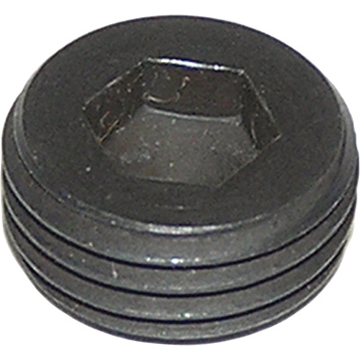

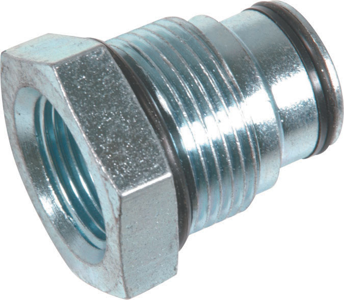

In the picture, the hose with the 90 degree fitting sitting on a fitting, that I believe is the PB adapter, and the other port is the tank port.
The PB port will have either an adapter like this or a 1/4 in hex screw.

Are you sure that fitting in the out port is not a PB adapter. Did that come with the new valve? The fitting that you have the 90 deg. stuck in looks like it could be a PB fitting.

Can you confirm that the fitting with the 90 degree hose is a PB fitting.
Just remove the fitting and it should have two o-rings on it. Take a picture of the fitting removed from the valve. If it looks like the fitting I posted, then it is a PB adapter.
PB is a high pressure path for the fluid to progress to the next valve, and used in most situations because there is usually another valve downstream.
T ports usually go to a tank line and can be teed.
Your flow path might be something like this.

I can confirm the 90 fitting does not have 2 O rings. It is exactly the same as the tank fitting but with a 90 deg angle. All ports have one O ring that slot into valve side of the ports (acts more like a washer). There is only a size difference with the tank/pump ports compared to the work ports. As far as I can figure, the valve is standard on an 'East Wind' tractor (DongFeng factory). Dong Feng tractors are a poor mans poor mans tractor so probably get downgraded a bit on parts since the original valve was simpler. Apparently Dong Feng means 'east wind' anyway.
