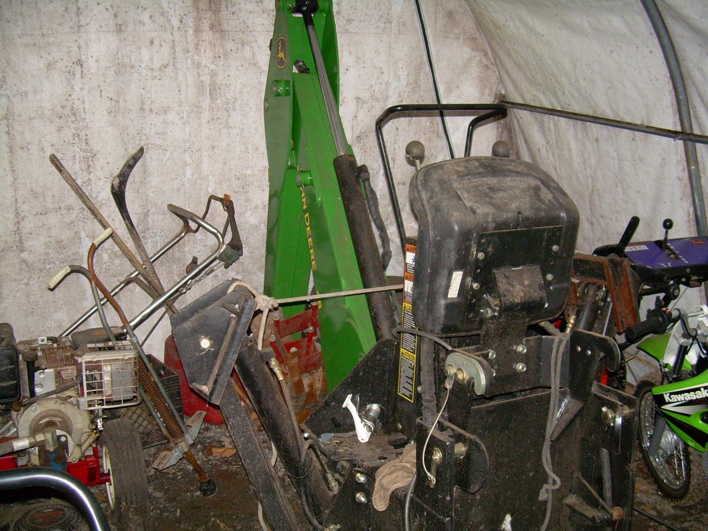

Inside is better than all the equipment sitting outside at the dealers.
I always think about the people that really baby their equipment and bring it to the dealer for service and the dealer leaves it sitting outside in the elements for a month. They'd probably cry if they knew.
That said I try and keep my equipment under a roof at least when ever possible.
I keep my BH in one of those tent type garages, the conditions in there are not much better than outside sometimes with the humidity, everything gets mildew on it.
I was worried about the bare cylinders also as they were showing signs of spotting, but they cleaned right up with one wipe of an oily rag.
JB.

/ FEL Storage #14
There's an old abandoned Ford loader at my farm 1960's era, been sitting with the lift cylinders half out for at least twenty years. Everytime I look at it I notice the cylinders are still shiny with no pits. I'll go with Mr Messick. :)
