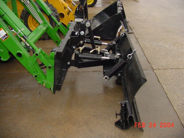

That reference picture of the plow on the JD, looks very much like the plow I have made by kasco mfg out of shelbyville In. There is a float mechanism built into the plow, (that bar in the middle running at a 45 degree angle), and also notice the pin toward the front....this locks the plow and keeps if from tilting forward....eg for dirt work.
Also, my experience with shoes and gravel is not good....but works good on pavement. Not sure if it will scratch the drive up though. (I don't have that worry).
Kenny, excellent job and post..... I just hope your boss isn't a TBN member. On the other hand...he probably would understand......

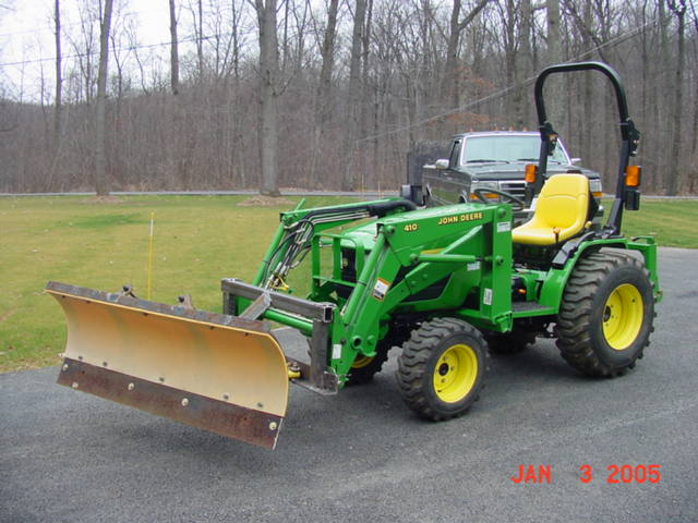

Thanks for the suggestions Pete, But I have a paved driveway so I hope I will be in good shape as it is.

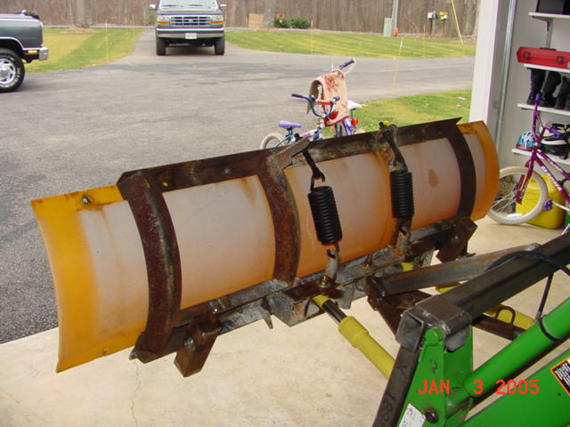

<font color="green"> Ken, thanks for the posting. lots of good work done on your part.
I recently bought a 60 inch John Deere front blade made for the 1400 and 1500 series front mowers and plan to attach it to the FEL arms on my John Deere 2210.
Several questions.

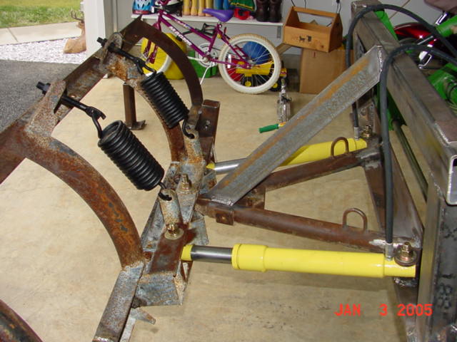

1) What size and thickness of angle iron did you use across the bottom between the loader arms?
2) What size rectangular tubing did you use for the uprights and across the top?
3) How did you attach the pin to the angle iron? I am refering to the pin that goes through the hole in the loader arm bracket to complete the FEL attachment. It's the same pin that is found on your bucket. Did you just weld the pin to the surface of the angle iron or did you drill a hole in the angle iron to fit the pin and weld a bead to one or both sides?
Thanks again for your timely posting. I was just sizing up the steel I need to make my mount and found the information in your posting to be very valuable.
Mike </font>

/ FEL Snowplow #48
kennyd
Nice work.
Couple of comments----
(I plow with an 8' fisher on a GMC 4 x 4 and also use a MT180D 4x4 tractor)
Your skid shoes--,
I'd suggest that they be allowed to swivel(use a round pipe to fit the square 'socket' with more trailing than leading surface, otherwise you might find that when the plow is angled you will be scoreing the asphalt drive.
Fisher uses round skid plates for that reason.
Also noted that your angle cylinders are attached with bolts from bottom only. I think you will find that they will break or certainly bend. I'd suggest that you add top 'ears' so that the bolts act more like pins with upper and lower support.
My plow uses hardened 3/4" pins and even then I bend them all out of shape.
Plowing with the forward leading corner (or hitting a curb etc) will place awsome loads on that bolt.
Someone talked about 'float problems' and I agree, you need all the wt possible on the front wheels, and even then stearing is difficult.
Good skid shoes may cure that.
What fisher does is stack washers between the shoe and the holder to accomplish the adjustements (They use a 1' rod as shoe 'pole' in a 1 1/8" 'holder'.
Otherwise nice job and good workmanship.

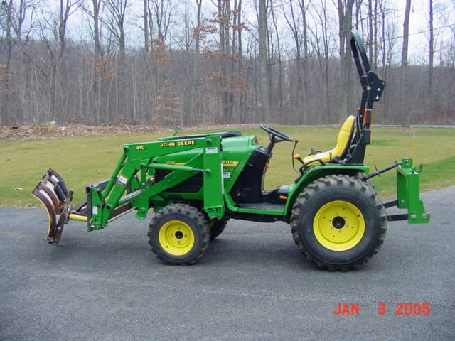

If you analize the angles involved and forces, I think you'd rapidly find that a plow attached to 2 'arms' or a rack that was as parallel to the ground as possible would be best.
Example would to have the pivot point for raising/lowering back midway and possibly attached to the lower tractor frame or even the loader sub frame.
I venture to suggest that the best all around installation might be a pair (properly cross braced) of 3" channels that would attach to the rear axel housing.
The natural forces (read heavy snow load) naturally tend to lift the front end off of the ground because of the loader's high pivot point. ie it wants to jack knife the front upwards resulting in a loss of stearing.
On the other hand to turn right angle the plow to the left etc.
(Does kinda dump the snow in all the wrong places however)
Been there done that!
Note I have a MT180D and a GMC 3/4 ton 4X4 with a Fisher 8' plow.
I found that with the tractor I could only push straight forward
so I abandoned tractor plowing in favor of keeping the loader to lower the snowbanks and loading sand etc.
Mind I have a 5' blower on the tractor but still favor the truck as it gets around much faster.
All the folks around here that mount plows on tractors favor using the lowest pivot point possible, even to the extent of bolting plates to the sides of the front tractor frame in order to get a straight line push.
Many even make 3 positions available. One straight line and the others about 1" higher and lower.
The higher one 'digs in' the blade for icy surfaces and the lower one lets the blade 'ride up' to create higher snow piles.

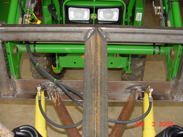

<font color="black"> The angle is 5/16" thick by 3"x3" </font>
<font color="black"> The tubing is 2"x3" box with 3/16" wall
</font>
<font color="black"> The angle was drilled, then the pin welded on the back side, If you weld on the pins side, you will have to grind it flat so the angle rests flat on the plate on the FEL. Clear as mud?
See the picture in this POST
</font> Thanks again for your timely posting. I was just sizing up the steel I need to make my mount and found the information in your posting to be very valuable.
Mike </font> )</font>
<font color="black"> Also, the pins and hooks are available from JD for about $20.00, it saves alot of fabricating time. </font>

</font><font color="blue" class="small">( kennyd
Nice work.
Your skid shoes--,
<font color="red"> Thats a good thought, I agree that the skid may need to be redesigned, it was late, we were tired and just needed to get done. </font>
<font color="red"> There is a tab on top, it was part of the origanal A-Frame,look closely ate the "side view of plumbing" post. </font>
<font color="red"> Yes, I have seen that, Meyer's does the same, I just did not have access to them when I built it.</font>
<font color="red">Thank you. </font> )</font>

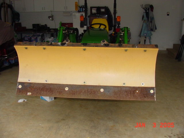

Ok guys, Thank for all your kind words and suggestions.
The skid shoes have been bugging me, and I need some advice...
I saw these Iron Caster Wheels at TSC and I thought they might work great. I was thinking the 3" ones.
I could mount them to the shoes I already have,would be good for the asphalt drive I have, and do OK in gravel should the need arise(side job).
Need more thoughts and advise from the experts please... /forums/images/graemlins/confused.gif

I think the air filled caster would be better.I think it would roll on gravel better and be less likely to jam up with a rock

No more opinions from the TBN Collective?
/forums/images/graemlins/confused.gif /forums/images/graemlins/confused.gif
/ FEL Snowplow #59
<font color="blue"> No more opinions from the TBN Collective? </font> /forums/images/graemlins/confused.gif /forums/images/graemlins/confused.gif
You have to be kidding? /forums/images/graemlins/tongue.gif
Why else would you start a thread on TBN?
IMHO I do not think the Sintered metal casters will hold up. Look at using a round shaft and allow your original skid shoes to swivel. This is a proven design that is on most commercial snow blades.
