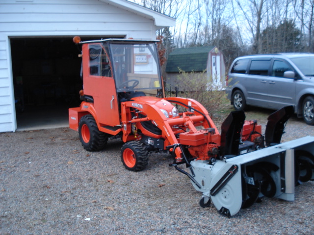

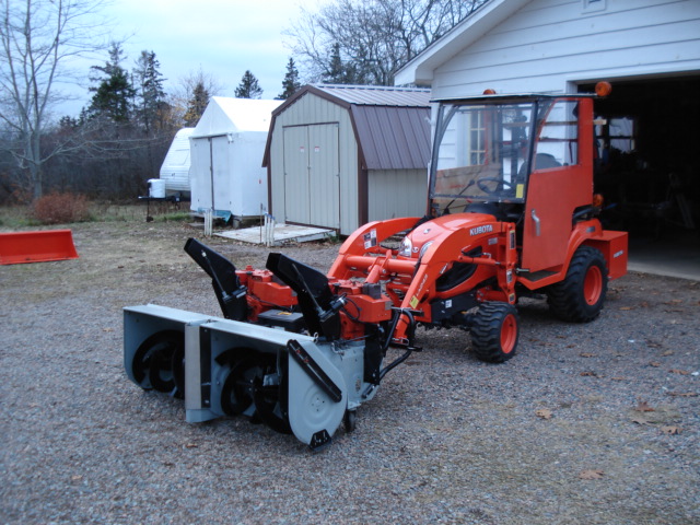

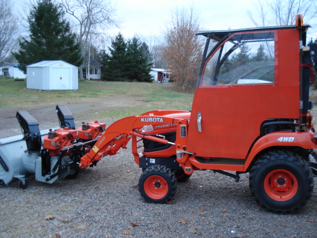

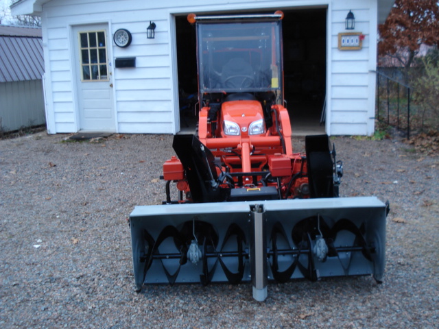

Hi all, new to the forum so thought I'd share what I did.
I reworked two "walk behind" Craftsman snowblowers into one to quick attack to my new Kubota BX2370 front end loader.

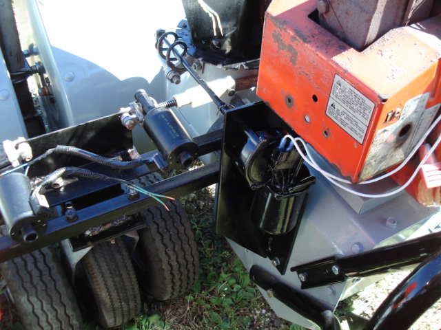

The two blowers worked out to a total of 60" wide and have their 10 HP engines running them. I removed the drive wheels and the drive mechanism and built a three wheel center caster to support the rear section with castors and skies on the front. The engines now have 12 volt starters, chute rotation, deflectors and auger engagement all have 12 volt actuators controlled from the cab. The Kubota loader handles the weight great although the blowers will ride on the ground with the tractor just pushing and steering them.

The way it works is;
pull the capture pins of the quick attach for the bucket, drop it, go pick up the snowblower insert the capture pins, plug in control box cable, start the motors and blow snow! No belts, drive shaft or bolts to install.

Will the chutes rotate independently so you can blow the snow left and right at the same time?

Will try to do a video when we get snow and will post it. Thanks for the positive comments.

Yes I see where you're coming from. They are not shown but there are 3- 10" pneumatic dolly wheels on a swivel castor in between the two blowers approx where the wheels were, which I removed because it could not steer with the original wheels of course. Thanks for your reply! Russie

Thank you ! Yes that was the plan, It is a lot easier and faster than removing the loader and installing the Kubota snowblower with hydraulics, lift kit and drive shaft, just using quick attach system! ( engines are also started and stopped from the cab control.)
