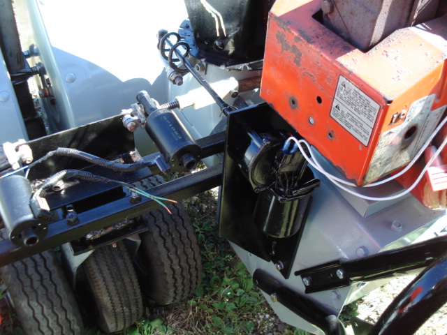

Yes I see where you're coming from. They are not shown but there are 3- 10" pneumatic dolly wheels on a swivel castor in between the two blowers approx where the wheels were, which I removed because it could not steer with the original wheels of course. Thanks for your reply! Russie
Ahh, :thumbsup:thats nice, no, I didn't see that....lookin good,

I have often thought about doing the same thing with 2 27" Craftsman blowers I have one now, but don't have a removable bucket/QA setup so I was thinking to mount them in the bucket.
Your setup with all the controls from the cab is pretty cool - what does the control console look like?

Hi Carl_NH, thanks for the comments, will post a video if it works and we get snow !
The control box is about 4 inches wide by 6 inches long with eight DPDT (mom on ) switches.
Four for each blower section. top ones start and stop the motors (which have 12 volt starters) ; the next two down engage and disengage the Auger/impeller drive belts ; the next two down move the deflectors on the chutes up and down and the bottom two rotate the chutes left and right.! the box is mounted inside the cab on left side of steering wheel. The blowers were two 10HP and
28 inches wide. Craftsmens.
Thanks for your reply and good luck if you build one !!!!
