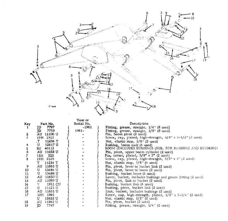

I might be wrong but I think TxMark is referring to bucket linkages similar to parts key 12 on the model 720 FEL on a JD ind 2010

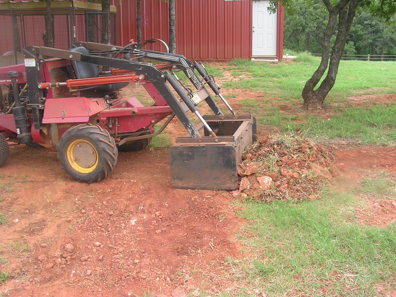

Are the bucket cyl operating linkges on your tractor what you were previously referring to in an earlier post? I wonder if the previously mentioned linkages will help prevent bucket cyl rod bending when back dragging bucket with ft wheels lifted off the ground? Does bucket cyl linkage as shown in photo increase hyd pressure applied to bucket?
Back grading with the frt tires off the ground is a very good way to bend bucket cyl rods especially on a JD agriculture FEL with bucket cylinder rods fully extended

I totally agree but will the linkages in photo help keep rods from bending as easily when back dragging when rods are attached directly to bucket or SSQA?

I dont think so. I think what helps is loader with the linkage "usually" have shorter stroke cylinders.
The issue with bending the rod becomes the length of it. The longer the cylinder, the easier to bend.

Yes on the prior reference. Interesting you found a pic of my tractor faster than I could. Nice job.
Well on the hp I was going by the manual, not the Nebraska tests. Didn't want to err on the wrong side.....reduces the feedback flak. Mine was a diesel. After my LP 4020, I never bought anything but a diesel.
On helping to solve the back drag problem, they have to as the cylinder pressure is always in a straight line. On cylinder pressure, I'm not up on it but per you guys, 0 degrees is the highest pressure. What I don't know, nor how to calculate is the effect of the "force vector" via the arms that do the angle changing. Going to guess that you are dealing with a closed system and anywhere along the line you break 0 degrees you are in for a loss; 0 degrees defined as the bucket sucked all the way up...cylinder closed. In that position there is a short, straight line to the mounting brackets of the bucket. I don't have my specs handy on lift capacity at the arms, nor the bucket max-min, but I can drive it into a peaked pile of gravel, overfilling the (6') bucket and unseat the overpressure valve. But to do so it is really full and would be awkward attempting to move from the pile to the use location.

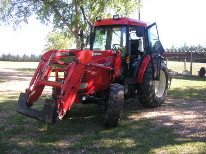

Okayeeee. On the subject of that loader, as I recall I had 4 connections to engage simultaneously, 2 at the bottom which accepted the loader frame and 2 on top accepting the cylinders on an 8' bucket that was way too heavy to push around manually and you can only do so much maneuvering from the operators seat as far as getting things lined up to accept the pins. And then there was the fact that it used 2 cylinders and they never did extend the same distance. Real bear and usually I left it on as it was too much trouble to reinstall the next time I needed it and never was anyone around to help out. So with 9.00 or so x 15 or 16 front tires (2wd) I was always front end heavy.
In comes the Branson with a fast connecting Bobcat/Bearcat FEL plate. I painted a couple of white lines on both the plate and the loader so that I could see the proper alignment from the seat and it now takes about 2 seconds to get her connected and one trip from the seat to push the locking pins down. Good old technology at work again.
