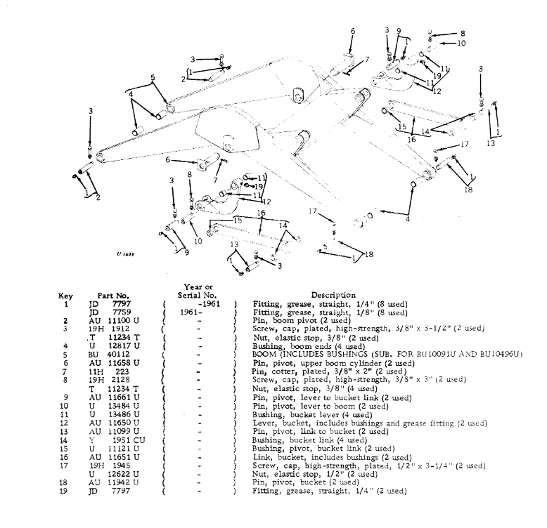

Okayeee again. So the cylinder angle efficiency explains why my bucket tilting mechanism (not to be confused with the upper cut loaders with the constant leveling functional arm) has an additional arm that does the tilting while the cylinder pressure remains inline. The old JD 152 as I recall the number of the loader I once had, didn't have this extra arm. Either JD engineers didn't know about it or figured they didn't need it......with an 8' bucket on a 70 hp 2010?

Was your JD 2010 ind or ag? BTW 2010 was only 46.86 HP not 70

I might be wrong but I think TxMark is referring to bucket linkages similar to parts key 12 on the model 720 FEL on a JD ind 2010
