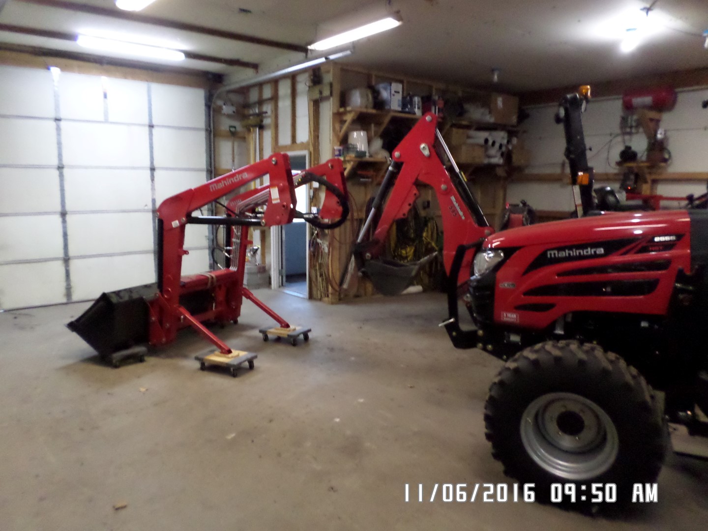

Make sure all the hoses are marked real good. Lowering the the FEL down onto four 1000 pound furniture dollies [ on sale at Northern Hydraulic sometimes ] lets you move it around to store fairly easily.
