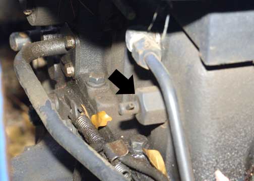

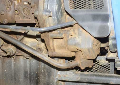

Mad - you are the one that helped out in the other thread. It's the third line I don't get. Here are two pics - the pump at the engine and the tank at the rear.
Also, what is the adjuster (?) I have pointed out?

Follow HoyeTractor's instructions. If your loader valve does have power beyond capabilities you will have to either disable it by removing the PB sleeve and plugging that port then follow Hoye's instructions or you will have to connect the PB and return to tank lines as I described above.

Do you recall the tube size that is cut? I think I'm mic'ing 10mm - does that sound right?
Also anyone know what the arrow is in the pic?
Thanks all
The valve on my tractor that looks like that controls the drop rate of the 3PH. And as Hoye said, you want to set up your FEL with an open center configuration. You cut a section out of the small-diameter hi-pressure line, plumb the "in" port of the FEL to the pump side, and the "out" port to the 3PH side. Then your 2 hydraulic devices (FEL & 3PH) are connected in series.
And roxynoodle, it sounds like you're still set up with a power beyond configuration. You can completely get rid of the third hose if you can reconfigure it as a simple open center configuration (if you don't already know that). The Koyker already installed on my 1510 when I got it was set up with power beyond and the 3rd hose was poorly routed through my fill cap. Koyker's valve is easy to change from PBY to open center, and I was just able to remove the 3rd hose and cap off that connection.
