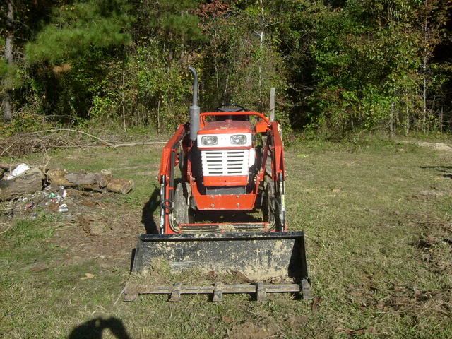

Hey guys,
I installed a front end loader on my ym2000 about 1 1/2 months ago and was wondering if a particular trait is normal. When lifting or lowering to full height everything is normal, and even when tilting the bucket downward, nothing unusual happens. When I tilt the bucket from down to up, like when scooping up dirt or such, it lugs the engine, even with the bucket empty. And it just seems weak when compared to the actual lifting capability of the unit as a whole. It doesn't do it bad it is just a noticeable change in engine rpm and I have no idea if this is normal or not. At no other time, whether at idle or higher, does the engine change rpm during "normal" operation of the fel, just when tilting the bucket from down to up. At higher rpm it doesn't happen because of the higher pressure involved I just don't know if it should do it at all.
Another example, when scooping a load of dirt from a packed pile, I can drive into the pile of dirt, but the bucket will not tilt upward to break it from the rest of the pile. I have to lift the entire unit first, then curl the bucket. Any info from will be greatly appreciated and thanks for your time.

There may be some binding of the bucket but high on my list of things to check is the value assy for lifting/lower/tilting the FEL.

If you have a joystick control, does it feel like there is a spot where the stick hits a "resting" spot but if you push, it goes all the way to a mechanical stop?
If so, try only pushing the control that far and see how it works.

Hey guys,
Sorry it took me so long to get back to the post... I am a relief capt. and work on a lineboat on the western rivers. I am gone a month or more at a time and some places we go are not internet friendly. I will try the suggestion with the joystick and see what happens. The deer in the background is a decoy/practice target for my bow and arrow, and yes, that is concrete in the back wheels. 160 lbs. on each side.(2 bags on each side.) I took the tires off and laid them on the ground. The plastic cover on a 1 gallon can of bondo perfectly covered the center hub area of the rim. (more on that later) Then I covered the entire thing with visquine.There are holes in the rim already so I put 4 pieces of rebar through the holes, punching through the visquine, and into the ground. The top ends of the rebar must be higher than the top of the rim by a few inches. Mixed and poured the concrete. Let it set for a while and then lifted the rebar up and down and around a little to create holes in the concrete to so that I could bolt the 8 dollar apiece 160lb weights to the rim. When it hardened, I flipped the tire and the visquine allowed the cement to slip right out, removed the plastic cover from the center of the inside of the concrete which left a nice hollow area there to allow space for the axle hub and bolts. Remounted the tires and lifted the perfectly formed weights into place and bolted them to the rim. That was, I must admit, a tough thing to do but I was motivated by bragging rights and failure was not an option. The difference in performance made it worth every drop of sweat. They have lasted an entire year so far with minimal cosmetic damage.

Just wondering. Why do you need so much weight ? Do the rears spin that much ? looks like you have the rice tires on the rear.. I filled my rears once just so see what effect it would have. The only thing I noticed was, that I seemed to have some power loss due to the xtra weight

As long as I am on level ground there is no problem. But when I scoop up dirt or pick up a large log and have to back up an incline the back tires will loose traction.(this happens because of close quarter maneuvering due to the trees that I am systematically getting rid of) I am quite happy with the added weight as it allows me to push and pull much more effectively(fallen trees and stumps) with the box blade. The only time I notice any power loss is when in high gear on the gravel road, going up an incline. And even then it is minimal. I am usually in low gear when working so have never noticed any loss of power. The little yanmar is an animal!!!

It is somewhat normal. In a hydraulic cylinder one side has more volume (area for fluid) than the other. The rod takes up space on the other side. Hydraulic power is a result of pressure pushing against a surface area. At a constant pressure the larger the surface area you push against the more power you have, the smaller surface the less power you have. It looks like you have 2 inch cylinders with 1 inch rods. So when you dump your bucket the oil is pushing against the 2 inch end of the rod (maximum power) when you retract you are only pushing on a fraction of the 2 inches because the rod is taking up space so you have half the power. Plus now you are lifting the weight of the bucket and what ever is in it. On top of that you are evacuating oil on the large volume end of the cylinder and if the hoses are to small or there is restriction through the valve the oil will have to fight its way out. That causes pressure/resistance.
The reason you dont see this lowering the loader arms (which really has the same issue) is you have the weight of the loader helping to push fluid out and the push side of your cylinders are under almost zero load until you reach the ground.
