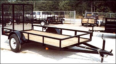

I am looking to buy a 5' x 8' materials trailer to retrieve mulch, loam, and golf ball sized rocks from various local nurseries. Your weight guestimate for ONE YARD of loam and rock makes this trailer purchase more involved than I originally thought.
I attached an image of a generic 5' x 8' trailer [located on the internet] that would be the size and design that would be ideal for my needs.
Might you or others have a guess as to how many yards of [Mulch], [Loam], or [Golf Sized Rock] this type of trailer can carry?

You could possibly carry a cubic yard on that trailer. The surface is 40 s.f. If you covered 2/3 of the surface of the trailer and stacked it 2 ft high it would physically fit. But the more important thing would probably be the weight capacity of the trailer.
BTW, you'd probably have to get a commercial TLB to carry one cubic yard in the bucket at a time.

I am concerned about the weight capacity.
I went to the Big Tex site, and I copied the link to a single axle trailer that looks like the design we'd want to purchase.
Single Axle : 29SA TRAILER - TRAILERS - Utility Equipment Trailers - Gooseneck Dump Trailers - Big Tex Trailers, home of the largest flatbed utility trailer and industrial equipment trailer manufacturer in the nation. BigTex can design and build flatbed utility trailers, heavy duty gooseneck trailers, hydraulic dump trailers, Auto Transport Trailers, gooseneck lowboy flatbed trailers, and heavy equipment utility trailers to fit any and all of your utility trailer needs. Used Trailers available.
GVWR = 2995#
GAWR = 2960#
Axle = 3500#
I cubic yard of loam or rock = approx 3000#.
The axle rating seems capable of handling the yard weight, but I am unclear what the other two ratings mean.
Thoughts?

It is my uninformed understanding that the GVWR is sometimes 'held down' by manufacturer's as 3,000# is the threshold where brakes are required. I would feel comfortable to the axle rating of 3,500#, though I can say from experience that the tires start to look pretty flat with only 2,400# or so on the trailer.
The GAWR (Gross Axle Weight Rating), I believe, tells you that the trailer assembly itself weighs 540#, leaving 2,960# available for payload.
Both of the trailers look exceedingly similar to my 5' x 10' trailer on which I have loaded my BX (1,200#), FEL (400#), and BH (800#) combination. I personally wouldn't carry my machine for more than 5 or 10 miles on my trailer. I plan to upgrade. COG is all wrong.
That notwithstanding, you SHOULD be OK getting a yard of whatever (or 2 yards of mulch) in the trailer. I built 5' stakesides for mine with some spare 5/4 board from a deck I built. They come out very quickly, if necessary, and I can reach over them with my FEL when loading. You'd probably unload with your BH, so perhaps you'd only build them 2' or 3' tall so you could pull material out from somewhere other than the back of the trailer. I generally get bulk material delivered so I haven't had to work though that particular issue.

I must say that I had not anticipated the bulk weight of dry sand, dry loam, and rock to be as much as it is [~2700# +/- per cubic yard]. That certainly lessens the efficiency of trailering your own if the required amount exceeds a cubic yard for any one project.
I don't see any present needs for any one of those three items to exceed the one cubic yard limitation. As for dry mulch, we have an ongoing need, but I suspect that we can safely load 3 cubic yards per trip which is fine.
I do plan to make an interior, wood structure with removable, horizontal side and rear boards for material transportation. That will allow us to use the trailer's ramp to access the item w/ a wheel barrel and shovel.

The numbers are correct. The axle is a standard 3500 lb axle, but remember that the trailer frame weighs several hundred lbs which must be subtracted from the axle carrying capacity. Undoubtedly, the trailer frame weighs aprox 500 lbs which provides for a capacity of just under 3000 lbs. Remember that these ratings are for ideal new conditions such as new tires, perfectly set and lubed bearings, etc...
I do not fully understand what your needs are, but, based on what you have stated, I would recommend that you buy a 16' tandem trailer. It has much higher capacity, higher level of safety with two axles, and much more versatile if you need to haul your bx AND a
yard or two of mulch somewhere at the same time Tandem trailers are much safer than a single axle, ESPECIALLY, if you are towing with a smaller vehicle. If you ever experience a heavily loaded single axle trailer pushing a small truck down a hill in heavy traffic, then you understand how easily things can turn sour and put you upside down in a ditch, or worse. Under those conditions, if you are unable to accelerate, then things are about to become very ugly. If you are towing with a small truck, then have brakes installed on the rear axle.
Most tandem 16' trailers weigh about 1600 lbs depending on materials used. Mine weighs 1660, but it was fabricated completely from rectangular tubing, and I've installed brakes on the rear axle.

These numbers are extremely useful. They have helped me to conclude that we can definitely get by with a 5' x 10' single axle trailer. It'll limit us to one yard of sand, loam, and gravel per trip, and that's fine. Our use of those items is typically small in quantity for any one project.
If I can haul 3 yards of dry barkmulch per trip, that'd be fine. We tend to use 6+ yards per year, but we rarely spread more than 3 yards in one outing.

I have that same trailer which I welded 1.5" angle uprights to the sides and bolted on 5/8" treated plywood sides 2 feet high. It works very well hauling bulk materials. One word of caution though, I loaded about 2600 pounds of sand on that trailer and the tires would rub the fenders going over rough roads. The edge of the fenders actually cut into the tire tread some. I will post a picture of it when I get a chance.
