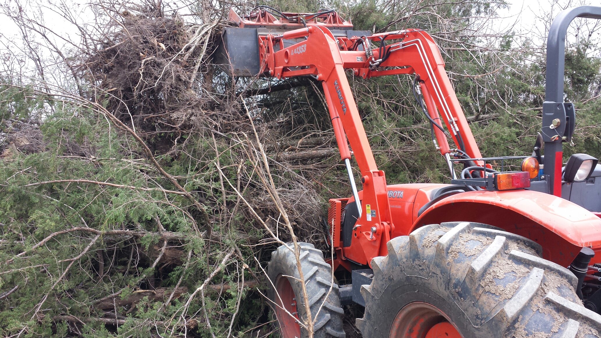

I think the "derail" of this thread happened when the discuss turned from the title subject to definitions.
Take a look at this picture. Are the cylinders you see confined or not. Please just answer "YES" or "NO". No lengthy clarifications please. You might have to add a couple periods to make your response long enough that the system will accept it. :D
