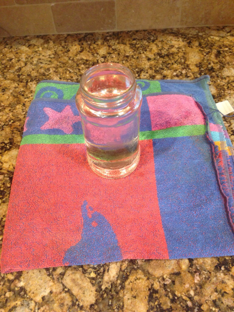

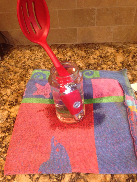

Full to the brim. IMG_8651.JPG Still full but somehow the towel got wet :confused: IMG_8652.JPG

Many different ways, and analogies, and experiments that can be used to show otherwise. But I need to know where you are coming from to try to better help you understand.
If you say that a rod can indeed be pushed into a confined cylinder full of oil, where do you believe the oil is going that gets displaced by the rod?
