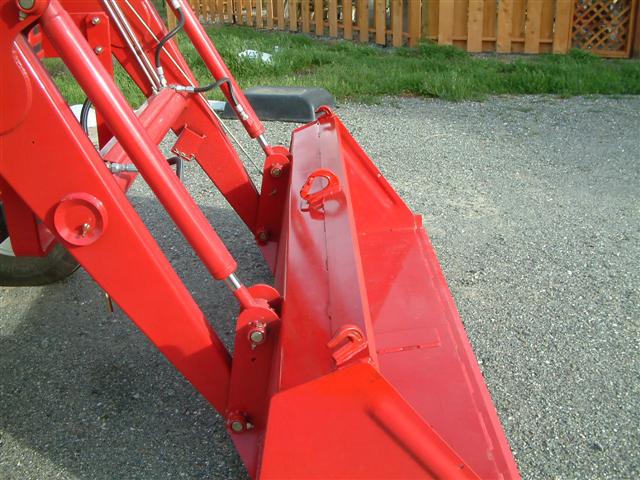

/ FEL Hooks #4

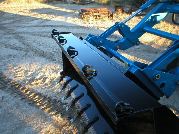

Just be sure to tell them where you want them and which direction. Double hooks would good. Two hooks on each side facing different directions. That is so you can hang the chain off the back or the front of the bucket. Some people beef up the area where the hooks are mounted. Some put hooks in the center. There are some nice fixed up buckets on TBN.
http://www.tractorbynet.com/forums/customization/149200-bucket-hooks-d-ring.html

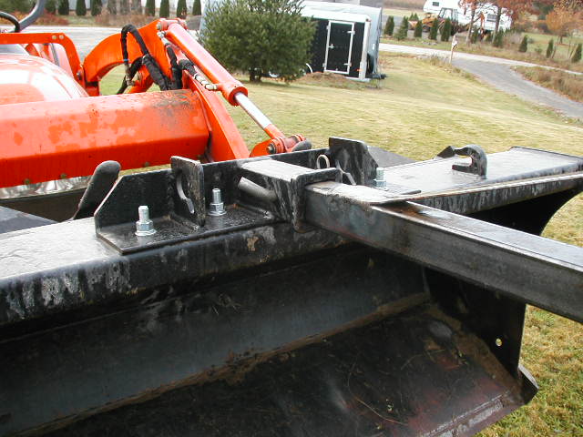

Hooks are pretty versatile. I added clevis mounts to mine as well!

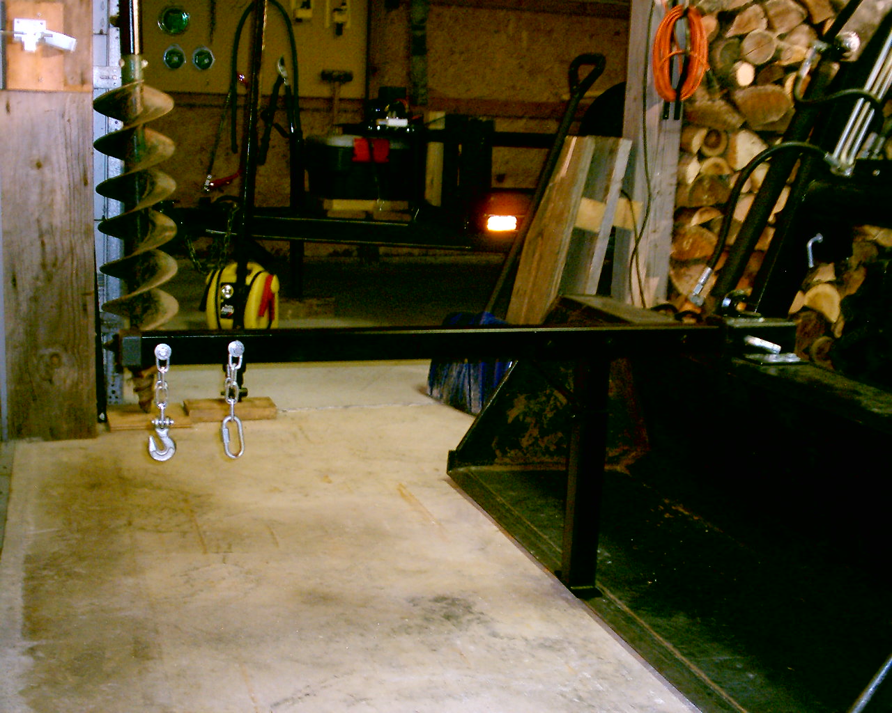

3/8" grab hooks are handy to have, but put them on the sides, save the middle for your receiver tube, you can just weld one on as well.
I bolted mine as I wasn't sure it was a good idea since mine was one of the earlier top center installs (that I had seen at the time). Now everyone has caught on for obvious reasons, it's versatility is limited only by your imagination.
http://www.tractorbynet.com/forums/...g/93535-bucket-buddy-instead-weld-hooks.html?
You can read about my reasoning for the receiver tube here.
JB.

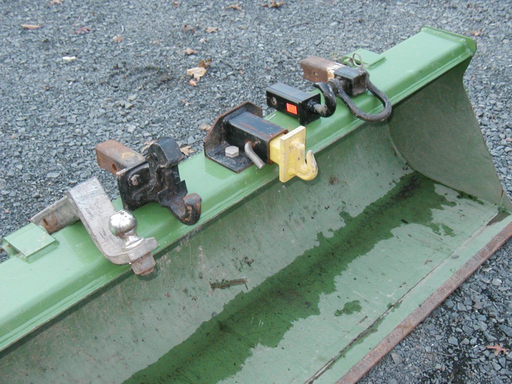

Nice setup JB!
I made a pair of movable hook brackets that slide anywhere along the bucket. No
welding or drilling into the bucket. (not that it hurts anything)
