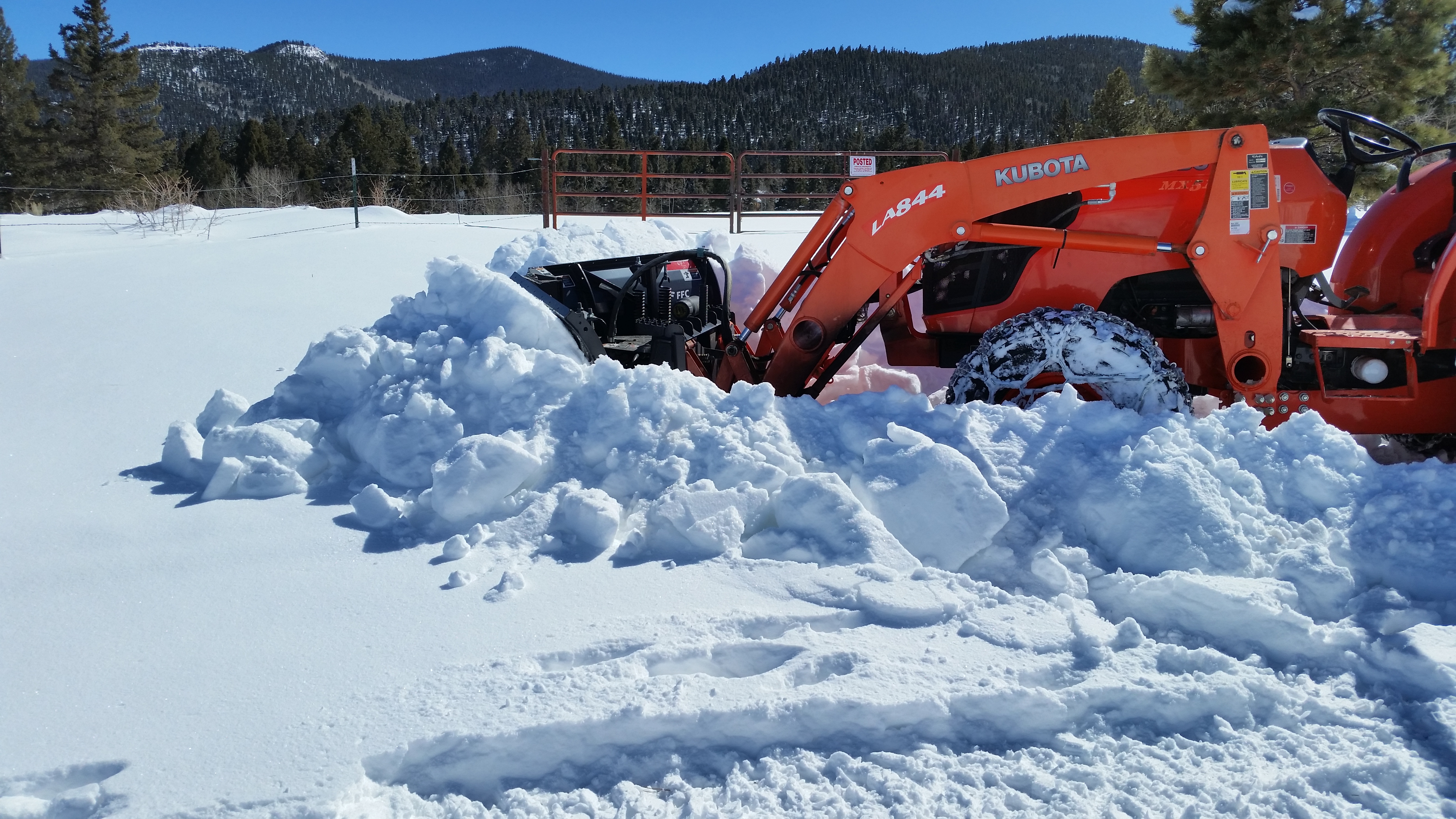

FEL damage is certainly possible, but its not like these FEL's are made of glass. I've been running a heavy FFC 8ft V-plow (over 1,000 lbs) for several winters in a rocky environment on an MX5100 with no damage. It has a trip edge and float, but I've hit rocks out on the end of the blade above the trip edge hard enough to either 1) swing the entire back end of the tractor around by a couple feet or 2) Push the blade back, which means the sequencing valve had some cross-over function (intended or not, its not clear to me). No detectable damage.
/ FEL Frame Damage From Snowplow Use. #7
Loader is LA844.
