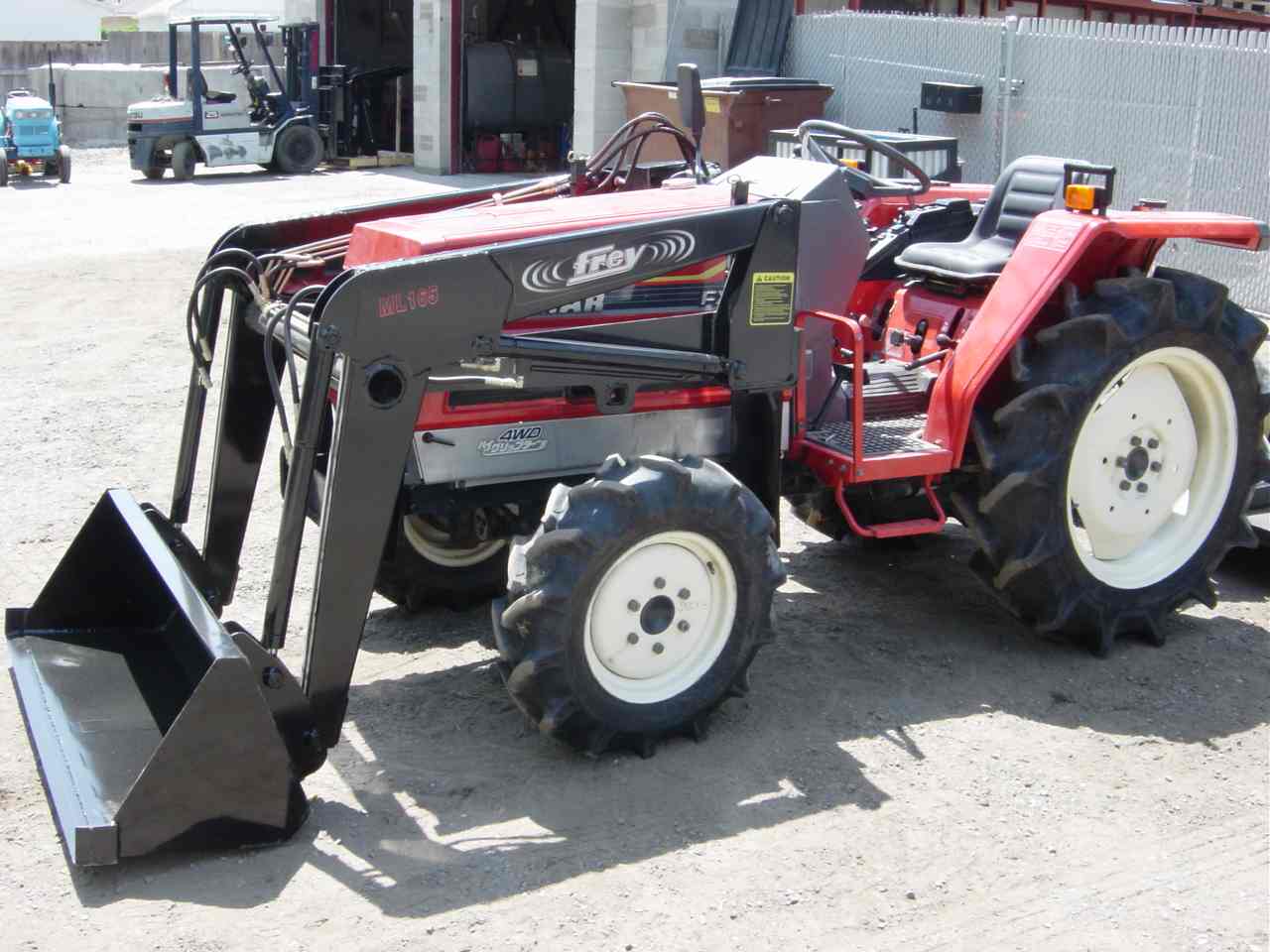

That is one of the advantages of the Frey loader is that it sits in closer to the tractor than the Koyker or others. I copied this pic from a thread somewhere here on TBN. I believe that Buck of EFC in Washington State was showing this very fact. I also believe that this is a FX-16. I could be wrong about that.
Mike

Thanks for the reply. However, according to the person I talked to at the Frey factory, they do not have a loader to fit any of the F series. That must have been a custom install :(

Buck at EFC has mounting systems. Write to him and he may be able to send you just the mounting hardware--That sure would be easier than fabing it up yourself.
Mike
