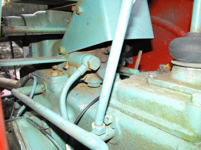

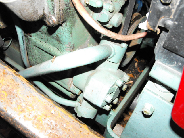

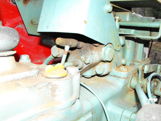

I know zero about hydraulics except for what I have learned in the past few days so I don't fully understand what you are saying. Here are some pics of my hydraulic system on the tractor that I am trying to hook up the valve to. My valve has both a PB and tank port. From what I have learned, I need the PB port to keep the 3pt working and a line from the tank port on the valve to return the cylinder oil to the tank (which on this tractor is the transmission). I just don't know where I can return the tank port to since I don't find any return lines on the tractor. I was wondering if anyone could let me know how I can get the cylinder return oil back to the transmission without it being pressurized by the PB port?

/ FEL control valve on YM1900 #6

I had the same concern back when I decided to install a FEL onto my tractor,
here is the link to my thread, please excuse the confusion, I didn't catch on right away, when this was explained to me either, you might find a couple of Photo's where the dump line comes out of the joystick remote control,
http://www.tractorbynet.com/forums/hydraulics/153131-front-end-loader-hydraulic-control.html
Thanks Deep, once again you have saved me (back when we were discussing the front axles). I guess I am going to have to rig up a line like you did into the tranny fill cap to make this work. I 'm thinking of maybe making an extended tube from the tranny fill tube and routing the tank line into the side of it so I can keep a fill cap on top. Will have to make a modified dipstick due to the added height of the tube. I'll send you a photo after I make it. Thanks again, this will solve my problem as to where the tank line has to go.

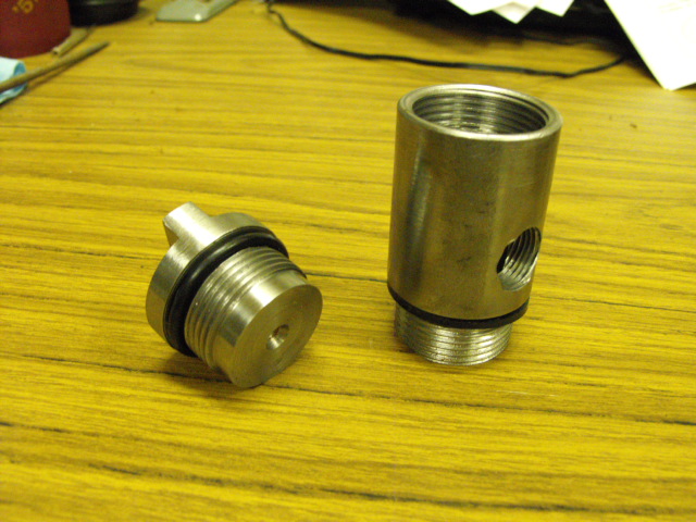

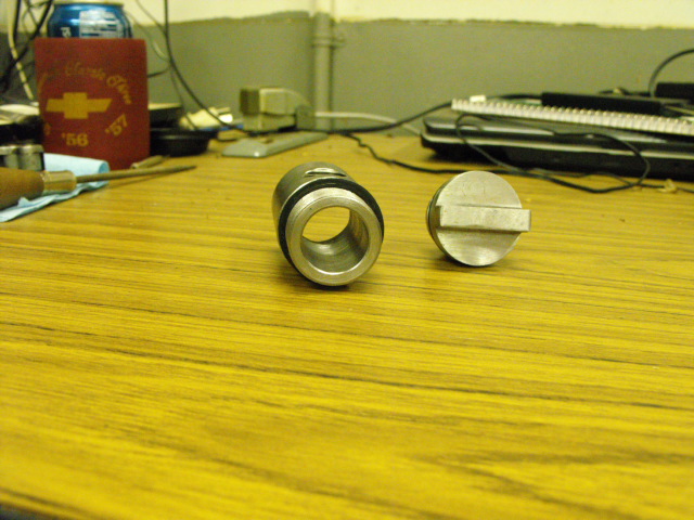

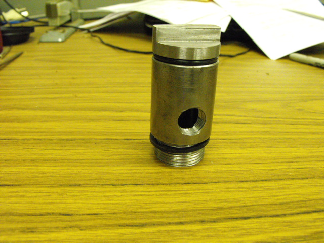

Here's the transmission adapter I made for the loader valve return line. I got the idea from the one DeepNDirt made for his. I'm hoping this does not cause any restriction in the loader and bucket drop speeds. Kind of had to compromise between what would fit and what I would like to have made. I would like to have had a 1/2" NPT fitting but it would make the adapter walls really thin. I've decided to replace 5 of the hydraulic hoses with steel tubing so it is back to figuring out fittings again.

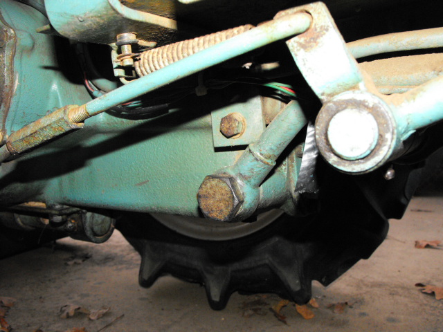

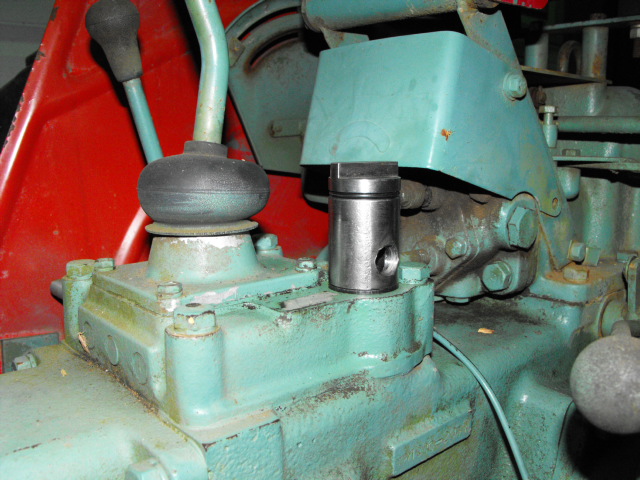

Does anyone know if the port with the plug in it on the left side of the 3pt valve can be used as a supply to the FEL valve? I removed the plug and cranked the engine over with the fuel shut off and oil flowed out of the hole. If it can be used to supply the FEL valve I wouldn't have to cut the pump line and could remove the PB sleeve on the FEL valve. The manual shows it but doesn't really say anything about it.

Thanks Kenny. I'm still looking for something to make the longer dip stick with. I can drill a small hole into the cap and thread it but so far I haven't found the right material to make it with. I want to keep it no thicker than about 1/8" if I can so it won't put back pressure on the return oil coming into the tube. If anyone has any suggestions, I would be glad to hear them.
I know all about that plug on a 2002. Your 1900 may or may not be the same. Here's how that outlet works on a 2002. It is called an axillary outlet for use with a single acting cylinder. I have pulled my plug and installed a quick connect which I hook up to a single acting cylinder on a cement mixer. It only works when stop valve is closed allowing flow to go to the axillary outlet. The axillary outlet is then controlled by the 3 point handle. This outlet would not work for a loader. Again, I do not know about the 1900 but I am "guessing" yours is probably the same outlet. I really think cutting into your steel lines is going to be your best choice. Some Yanmars have other axillary outlets on the control valve but I do not see any on your pictures. You can really make a neat installation with the proper tubing fittings and quick disconnects. Then when you get ready to take loader off you simply disconnect hoses from loader and plug one of the hoses back into the tractor hydraulics to complete the circuit. Other hose on loader goes back into loader just to keep trash out until next hookup. I take my loader on and off several times a year. p.s. I could try taking some pictures if it would be of any benifit to you.

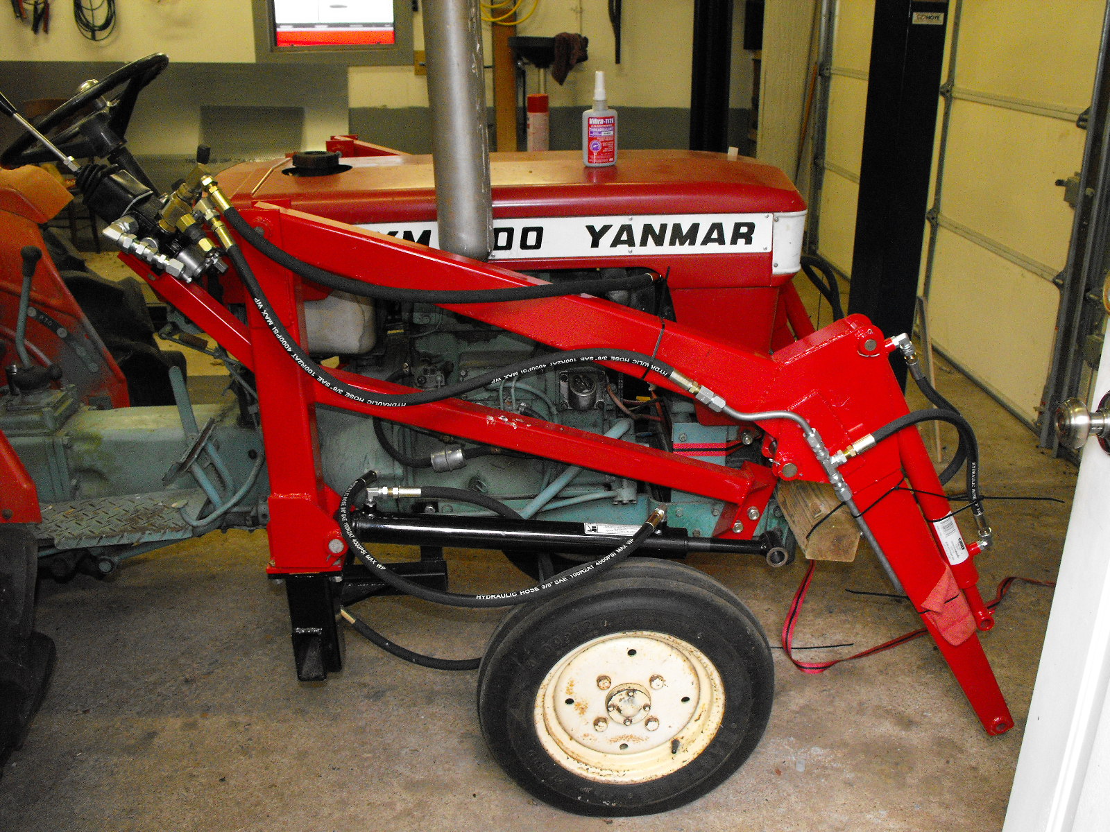

Thanks for explaining how that plug works. I was not sure if it would work or not. Looks like cutting the line is the only way for this tractor. I have seen photos of the pump line cut and hoses installed. I measured the line and it is .477 diameter. I don't think a standard .500 compression fitting will work. Seems like the tractor line is a bit smaller than a standard half inch. Where did you get your fittings to go on the pump line? This loader is not going to be coming off the tractor as I intend to use it for landscaping work and bush hogging so I am going to install steel lines from the FEL valve to the pump lines permanently.

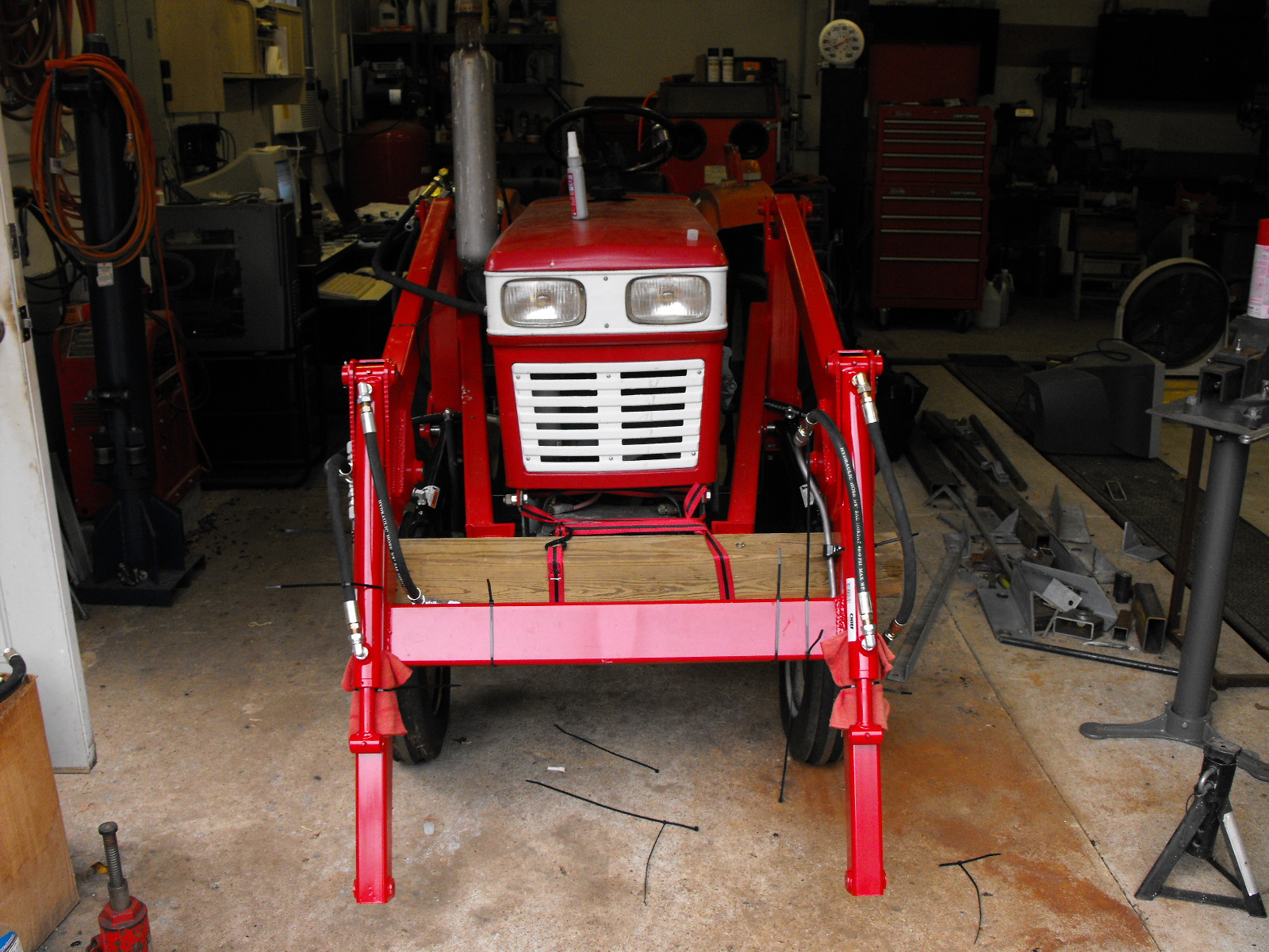

Right now I have installed temporary lines and hoses to see how it will move and to see what I need for bend radius. This winter I will remove them and put in the right length hoses and lines. I have about drove myself batty trying to route everything.

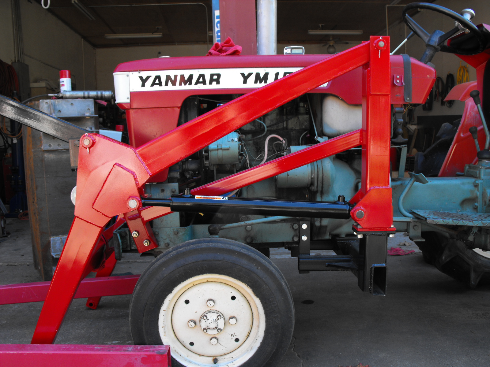

Thanks. I ordered the fittings and several parts for the front end at the same time. Might as well make sure everything on the front end is rebuilt while I'm at it. Hopefully I made the loader small enough to be useful but not so heavy it will cause problems with the tractor. It's a little unconventional but I wanted to keep it small and tight to the tractor. That is what's mostly causing problems getting the lines and hoses routed. The arms are only 2" from the muffler so I couldn't route the lines inside the arms to make it look neater but it should work. Once I get it finished, I'll try to make a video of it working. It's been a fun project but not one I want to repeat.
/ FEL control valve on YM1900 #20
Looking good! I don't think your arms are any closer than my bulldog loader arms. It has tubing with short hoses coming off for joy stick and cylinders. Not near as neat as I have seen on other tractors but it's ok.
