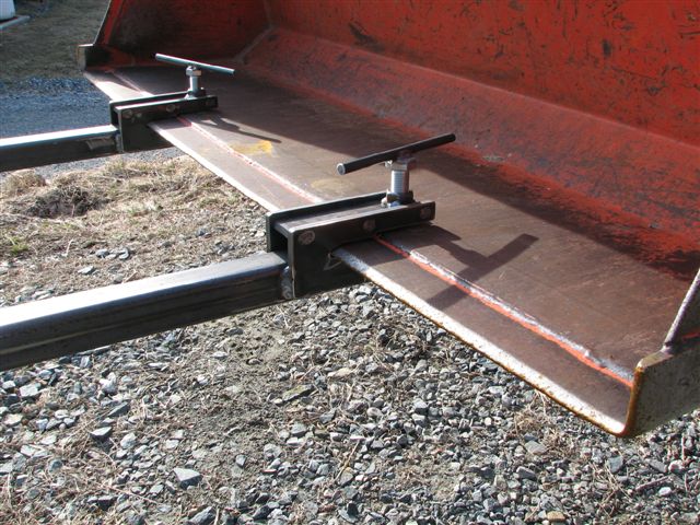

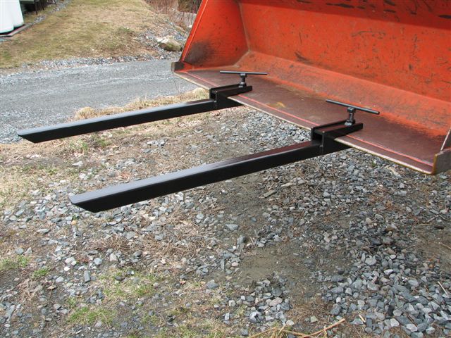

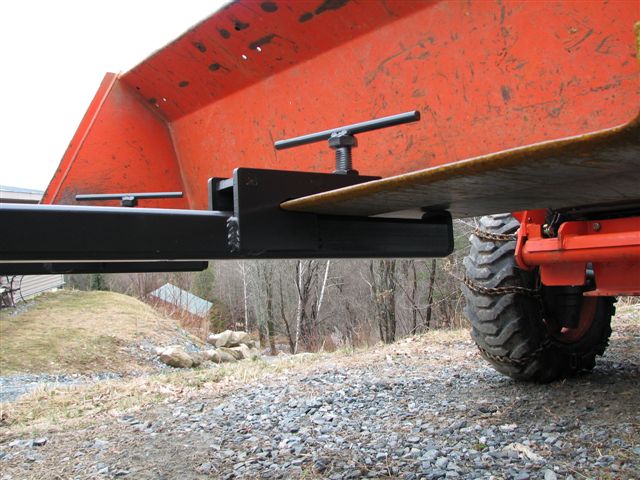

I have been using clamp on forks on my Kubota 4310 for over 3 years...fairly heavy use around the horse farm. I have lifted as much as 1600lbs with them....no effect on the bucket, in fact picking boulders out of my fields is much tougher on the bucket! They are much much faster than taking off the bucket.....I can switch back and forth from using the bucket to the forks in a few seconds.
I understand the need for the heavier duty "remove the bucket" type forks....visibility, strength, etc.....but there is a huge need for clamp on's as well. Especially good for light duty and occasional use! Mine are home made...pic attached.

You did a nice job building your forks, how much do they weigh? Your loader is rated for 1500 LBS.
   / FEL Clamp on Forks #5

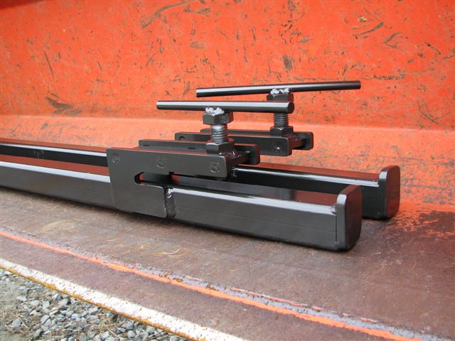

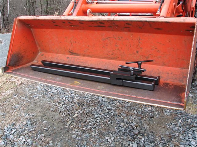

The forks shown in my previous post weigh about 70 lbs each. I picked up a pallet of 20, 80# bags of concrete off my trailer (Landscape rake was on the 3 point hitch for weight)...I don't recommend this as the rear wheels get pretty light...definitely don't want to go downhill! They are overkill for my loader.....but I also have a new set that I just built this weekend with a lighter rating for smaller rigs....these should be good for about 1000lbs (calculated...I have not done my destructive testing yet!) The lighter ones weigh about 30lbs each, and were requested by my wife who uses my tractor on occasion!
I find that the key to making these forks work well is a good fit on the bucket. The weight with mine is not on the clamp screw, but on the slot that slides on the cutting edge. They will lift the same weight with the clamp screw removed. A good fit helps the forks resist getting pushed sideways as well. Here ar my light weight ones that would be great for homeowner/under 25HP tractors.
I happen to have a cnc plasma cutter in my home shop...so cutting all of the metal parts is a breeze and it makes for a very nice looking fork!

There are pads that are 1-3/8" diameter on the bottom of the 7/8 clamp bolts. The load from the payload is not on the clamp...it is cantelevered between the slot that fits snugly over the cutting edge, and the back of the fork which is under the bucket. They will lift the same weight even without the clamp tightened.
