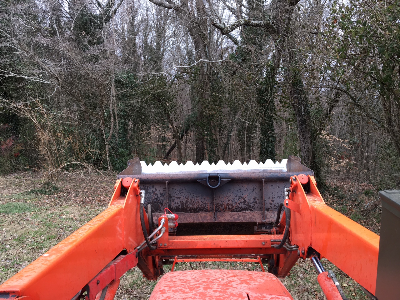

Amazing the trees and brush you can take out with a piranha toothbar. BXpanded.com made a special weld on for heavily worn HD bucket. The V teeth really bite trees and the added extension help bunch and carry. This time of year 3-5” trees roots slip out of the ground with minimal ground disturbance. Have to dig deeper with the grapples. Like this bucket for back dragging too.
Can’t carry as well as a root grapples. Have three grapples and they have their place too.

The more I use the Piranha toothbar the more I like it. I had a regular bolt in toothbar on another bucket but took it off. Poor performance for the work I require. Maintaining roads, back dragging, cleaning ditches and clearing trees and brush the Piranha is so much better and no need to take it off. Have to be careful not to dig deeper than you want.
Another big benefit is limb removal. Have miles of field/pasture, roads and buildings boarding the woods. Encroachment is a problem. The Piranha bar grabs the limbs and allows me to break or shear them off. This is high hazard work but so is having to work around low limbs so be careful.

Folks at BXPANDED recommend running the Piranha toothbar a couple inches off the ground slightly tilted up for brush and saplings. I find this works real well. Once bigger stuff is “bitten” by the toothbar it can be pull up by the roots by curling or raising bucket. Then level off area by skimming and back dragging. Mower should be able to take care of any spouts from now on.
