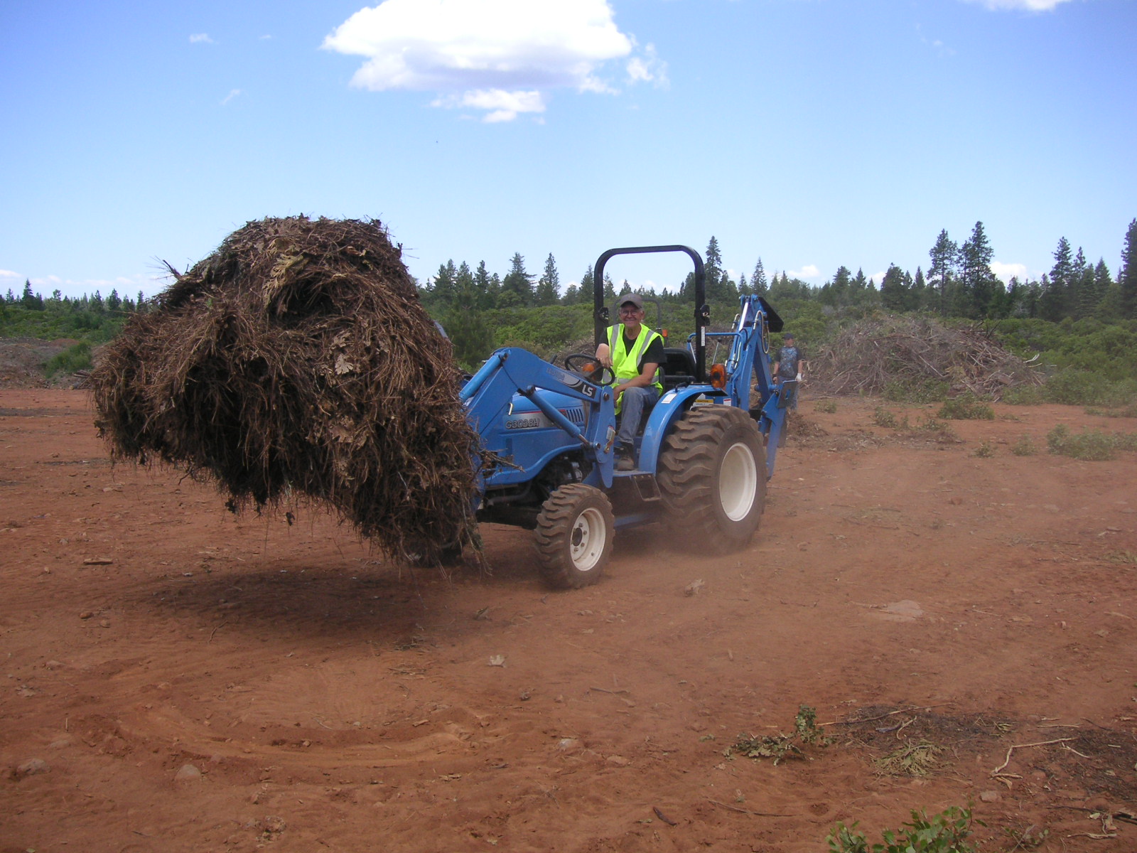

Consider buying a pair of forks as you will use them often for many tasks, never a one-time use item like a grapple might be. Easy to build a set of brush forks that slip over the two main forks. Mine are buried under snow right now but maybe this rough drawing gives you an idea of how I built mine. Debris Forks I Made.JPG
Pushing your brush around will add a lot of dirt to your debris pile and make burning it difficult. Here is a photo of my debris forks in action lifting a pile of dry pine needles.

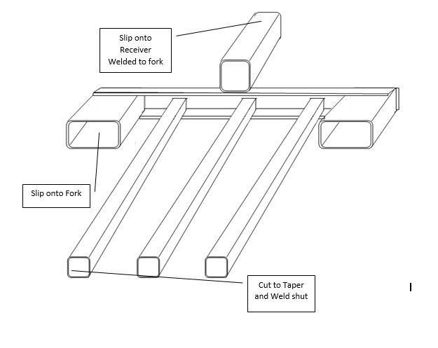

With my handmade brush attachment (30 seconds to put it on or take it off, if a dawdle) I can easily carry three times the brush as my friend can with his grapple.
