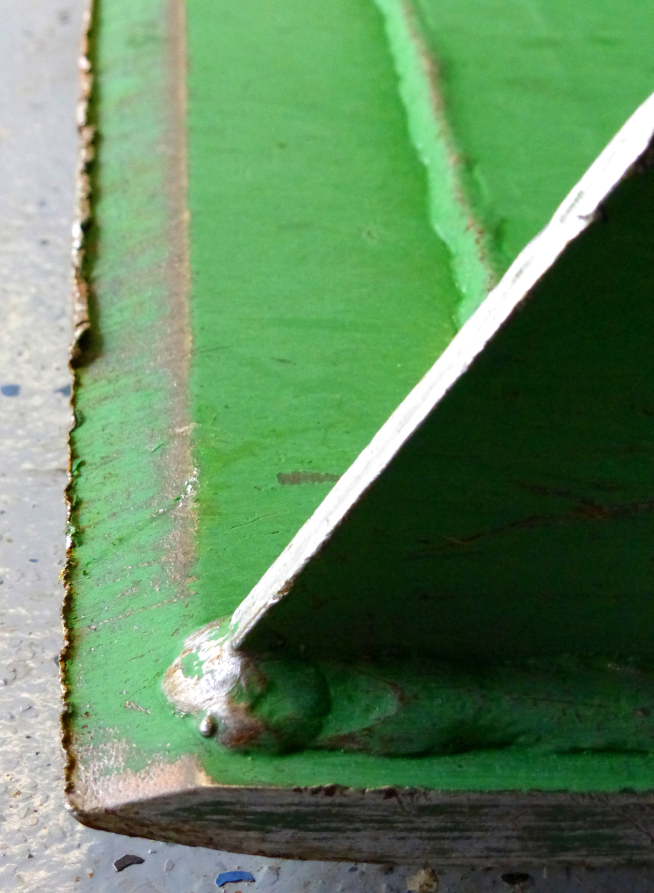

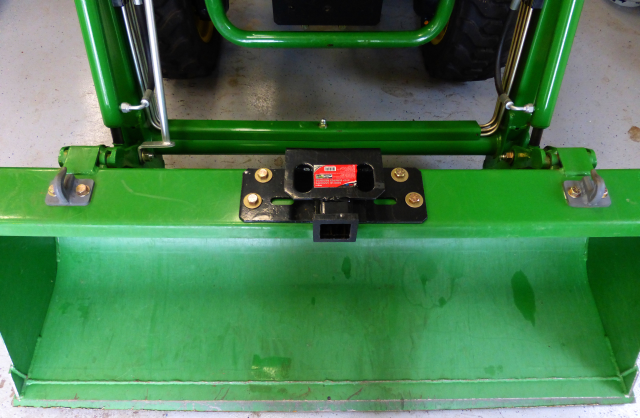

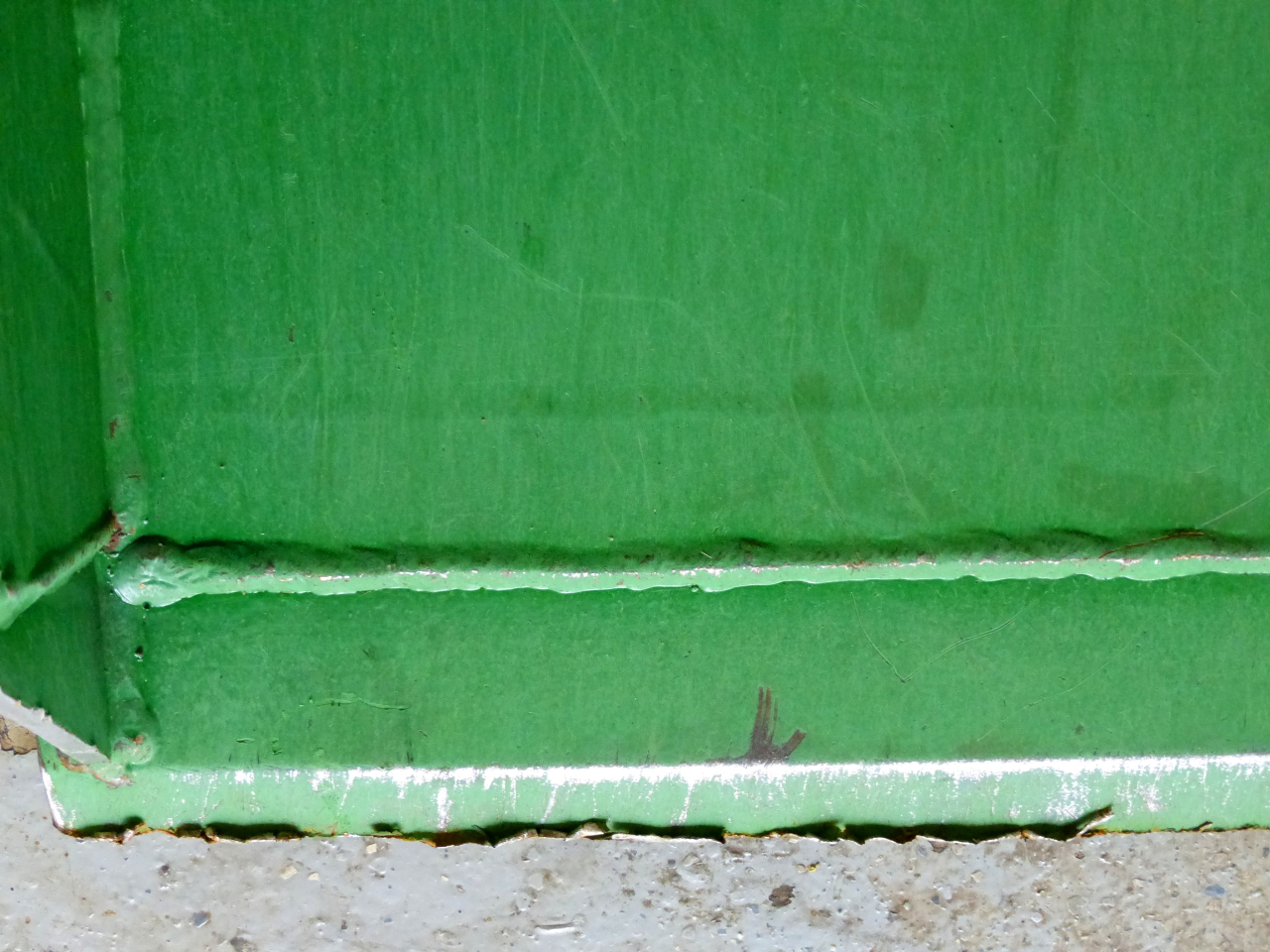

THE GOOD - Winter this year provided near weekly snow falls on the east coast so I had ample time to test out the snow moving capability of the 61 bucket (BW14146) on a 200CX loader mounted to the 2520 tractor. Let's just say this combination worked flawlessly on moderately steep terrain and handled up to 18 of snow with aplomb. Using only float mode, ice could be removed simply by tipping the bucket down to exert additional cutting force on the long asphalt driveway. I was extremely happy with the performance of the loader and tractor as it quickly dispatched the white snowy mess. :D
THE BAD - Attached are photos of the bucket's cutting edge after only one season of use since new. Basically the cutting edge is destroyed, since it's no longer straight along the front edge. Nearly セ inch is worn off at the bucket outside edges. Attachments, such a tooth bars, can no longer be affixed with a non-linear cutting edge. I was very surprised about the amount of wear on the cutting edge after only one winter season's use. Not happy. :(
THE UGLY I contacted my local John Deere dealer to inquire about the cost to replace the welded on bucket cutting edge. The estimate was about $600 parts and labor, and the bucket would have a "repaired" look to it when finished. The dealer provided the cost of a new bucket at just a shade over $800. Assuming worst case scenario, aka a heavy snow falls each year; I'll be spending $600 to $825 to move snow annually. There has to be a better way. :eek:
I'm evaluating different options before the next winter season. Below are a few options under consideration.
  • Repair bucket with a factory cutting edge and install a wear bar for snow removal. I believe W.R. Long manufactures a wear bar. $600 plus $300 = $900
  • Remove the damaged cutting edge and replace with a removable cutting edge that can be changed when worn. Cost and availability unknown.
  • Purchase a new bucket and wear bar for snow removal. Sell damaged bucket for few hundred $. $825 plus $300 = $1,125 (less proceeds from old bucket sale).
  • Purchase a new bucket. Sell damaged bucket for a few hundred $. Move to a snow free State currently under consideration. $825 (less proceeds from old bucket sale).
  • Do nothing. Forget about installing a tooth bar or wear bar with the bucket and continue to use it to remove snow on asphalt as usual. When the cutting edge wears back to near the wear plates, maybe 1 to 2 years more of snow removal, then make a decision to repair cutting edge or replace bucket.
If anyone on this board has other recommendations or constructive comments, I'd love the hear them. :anyone:

A bolt on cutting edge will give you twice the area for wear. You have enough metal there to drill holes for one.
If you do buy a new bucket get the JD 61" Heavy Duty Bucket. It is pre-drilled for the bolt on cutting edge.
Also try to keep the cutting edge flat when using the loader on hard surfaces so the wear is even across the entire width of the bottom of the edge, not just out on the point.

Buckets are made to work mostly with dirt. Anytime you will use something across a hard surface, you will need a hardened replaceable edge. Snow plow blade's? You will see they all have a flippable lower hardened edge. Wears down on one side, flip it, wear down the other side... then replace it.
Because of what has already happened, you will want to see if there is enough edge there for a hardened edge can be bolted on.

JD only lists the 61" HD bucket as being compatible with the 300CX and 400CX loaders, probably because of the weight. Since he already has a 61" bucket he could probably buy the replacement cutting edge, drill his own holes, and mount it up to his existing bucket.
