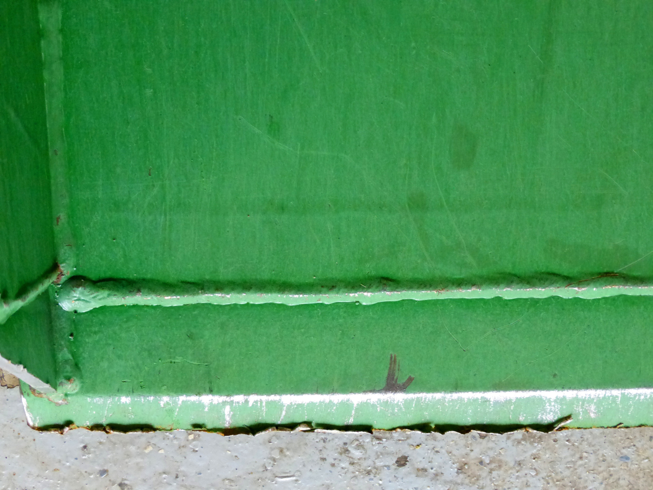

THE GOOD - Winter this year provided near weekly snow falls on the east coast so I had ample time to test out the snow moving capability of the 61 bucket (BW14146) on a 200CX loader mounted to the 2520 tractor. Let's just say this combination worked flawlessly on moderately steep terrain and handled up to 18 of snow with aplomb. Using only float mode, ice could be removed simply by tipping the bucket down to exert additional cutting force on the long asphalt driveway. I was extremely happy with the performance of the loader and tractor as it quickly dispatched the white snowy mess. :D

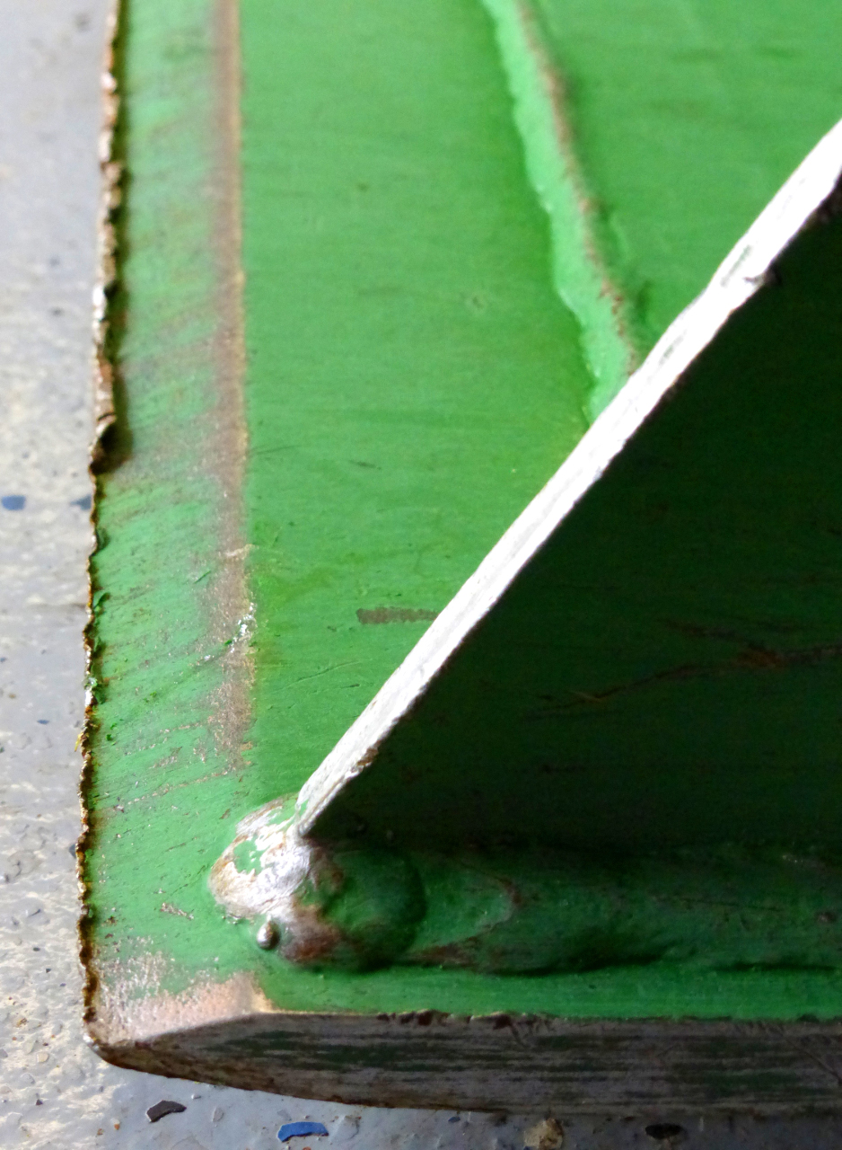

THE BAD - Attached are photos of the bucket's cutting edge after only one season of use since new. Basically the cutting edge is destroyed, since it's no longer straight along the front edge. Nearly セ inch is worn off at the bucket outside edges. Attachments, such a tooth bars, can no longer be affixed with a non-linear cutting edge. I was very surprised about the amount of wear on the cutting edge after only one winter season's use. Not happy. :(
THE UGLY I contacted my local John Deere dealer to inquire about the cost to replace the welded on bucket cutting edge. The estimate was about $600 parts and labor, and the bucket would have a "repaired" look to it when finished. The dealer provided the cost of a new bucket at just a shade over $800. Assuming worst case scenario, aka a heavy snow falls each year; I'll be spending $600 to $825 to move snow annually. There has to be a better way. :eek:

Get you stick welder out and your 7 inch grinder, and build up the edge, and grind to match.. rattle can it when done for looks. cost not much depending on which rod you use.. 2 hours of time, maybe.
They make rod just for this purpose of hardsurfaceing, but I would probably just use some 7018. it wont last as long, but it is cheap, and you can do it again!
To me this would be no big deal, and I am a novice welder. EVERY tractor owner needs a welder. Whether they know it or not.

I plow commercially with a truck plow. A 3/8 thick cutting edge starts at 6". And 3" is wore out. Not uncommon to get 200-300 hrs on an edge (3" wore away). And that's with the edge near vertical and not horizontal. So you either did some serious plowing, or JD used some softetal for that edge.
If it were mine, I'd drill the existing cutting edge (mag drill is your friend) and add a bolt on edge below the existing. Either that or get two more years out of it and drop the $800 for a new bucket. 3 years of snow removal for $800 ain't bad.
Either way, something has got to wear. Weather it be the factory edge, a bolt on edge, or an attachment. A bolt on edge is likely going to be the cheapest, and still pretty easy to replace.

My cutting edge seemed to start wearing incredibly fast so before any real damage occurred I tried to find a replaceable cutting edge, long story short is not available any that I could get from local heavy equipment suppliers were way to heavy and costly. I finally went to the welding shop bought a 5" by 1/2" piece of mild steel flat bar sharpened on old drill bit and drilled the bucket edge and flat bar. It's drilled dead centre so when one side wears out I just unbolt it an flip it sides. I bought some small cutting edge mounting bolts and after the holes were drilled used a larger bit the size of the head to counter sink the heads into the wear bar. I forget what the steel cost but it was so cheap that if it lasts half as long as a hardened wear bar I'm still further ahead.
   / FEL Bucket Cutting Edge Lesson's Learned #9
Find and buy cutting edge material in 1/2 in. X 4- 6 in. Width. It will be costly and usually sells by the inch. From a steel supplier. Then find a welding shop to cut off the old and weld on the new. This new one will probably outlast the tractor.
Also weld a strip of cutting edge to the front bucket sides and several strips on the bottom for wear. Be aware that drilling holes in a proper cutting edge is not easy or advisable. Torch yes.
I've done this on two small tractors. It will make a much much stiffer bucket. :thumbsup:
