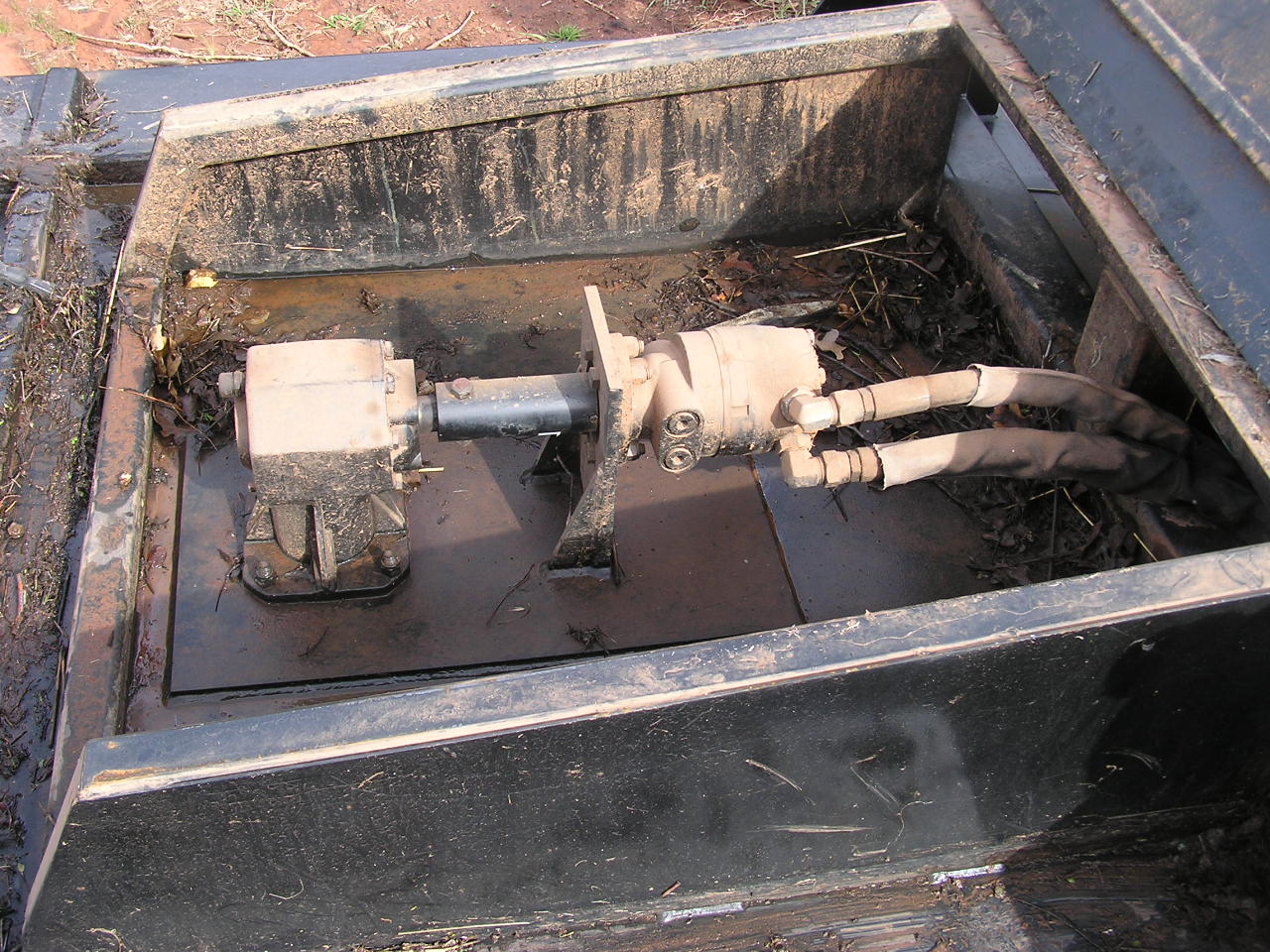

/ FEL brush cutter #4
Also you need at least 3/4 inch hoses to the hydraulic motor and a cushion valve to let the blades spin down when the valve is shut off..
Ours is direct coupled to the gearbox:
