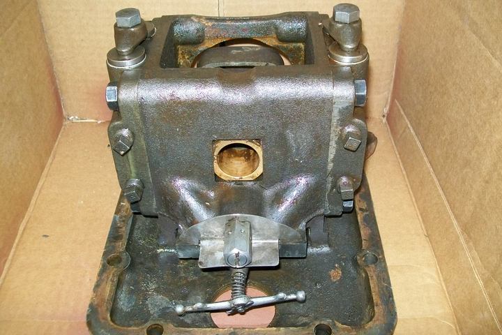

I shut the engine off, stuck the hand in the oil and it was painfully apparent that the control fork was not attached to the control valve..........or is it supposed to be attached?? Would this cause the lift not to work?? I found what looked like a shear key of some sort in the bottom of the compartment real close to the bottom of the control fork. Is this the missing 'link'? Thanks all!

The control valve has a "T" shaped stem that fits between the arms so on the control fork. The ends of the "T" fit in the sockets of the control fork. Can you find the contol valve stem? Pulling it back lowers the hitch and pushing it forward raises the lift. This is why your lift is not working. If the "T" shaped handles is still attched to the control valve you need to slip it back in the sockets for the lift to work. Before you do that, pull and push on the on the "T" and see if the valve moves back and forth. It only moves a little ways maybe an inch. If it moves freely it's not stuck.

From what I can tell by just feeling around, the 'T'shaped handle is still attached to the control fork and not the valve. The valve moves freely and again, judging by feel, there appears to be a spring on the end of the valve.

Shear key was the incorrect term...............looks more like a cotter pin that holds the valve to the 'T' handle............

What you found on the bottom is probably the clip the holds the crossbar of the "T" to the valve stem. You'll need to get the cross bar attached to the valve stem and get the clip back on. You are correct about the spring.It goes over the stem an fits between the valve body and the "T" cross bar.

See the image that I have attached.........it appears that I could access the control valve from the bottom drain. What do you think?

i think i'd drain the oil, snatch the pto shaft out, buy the 2 new gaskets I needed and make sure it was put together right.. probably take 5 minutes to drain, and 15 minutes to snatch t he shaft and drop the pump on a floor jack.. 10 minutes to reattach t piece, and clean old gasket off, 5 minutes to put pump back up with new gasket, bolt in, 1 minute to slip pto back in with new gasket, then 1 minute to re-attach fork to T.
or you can drain and work thru the drain port and a side cover and try it.. might work.. if you can see it and actually manupulate your tool in that space.
