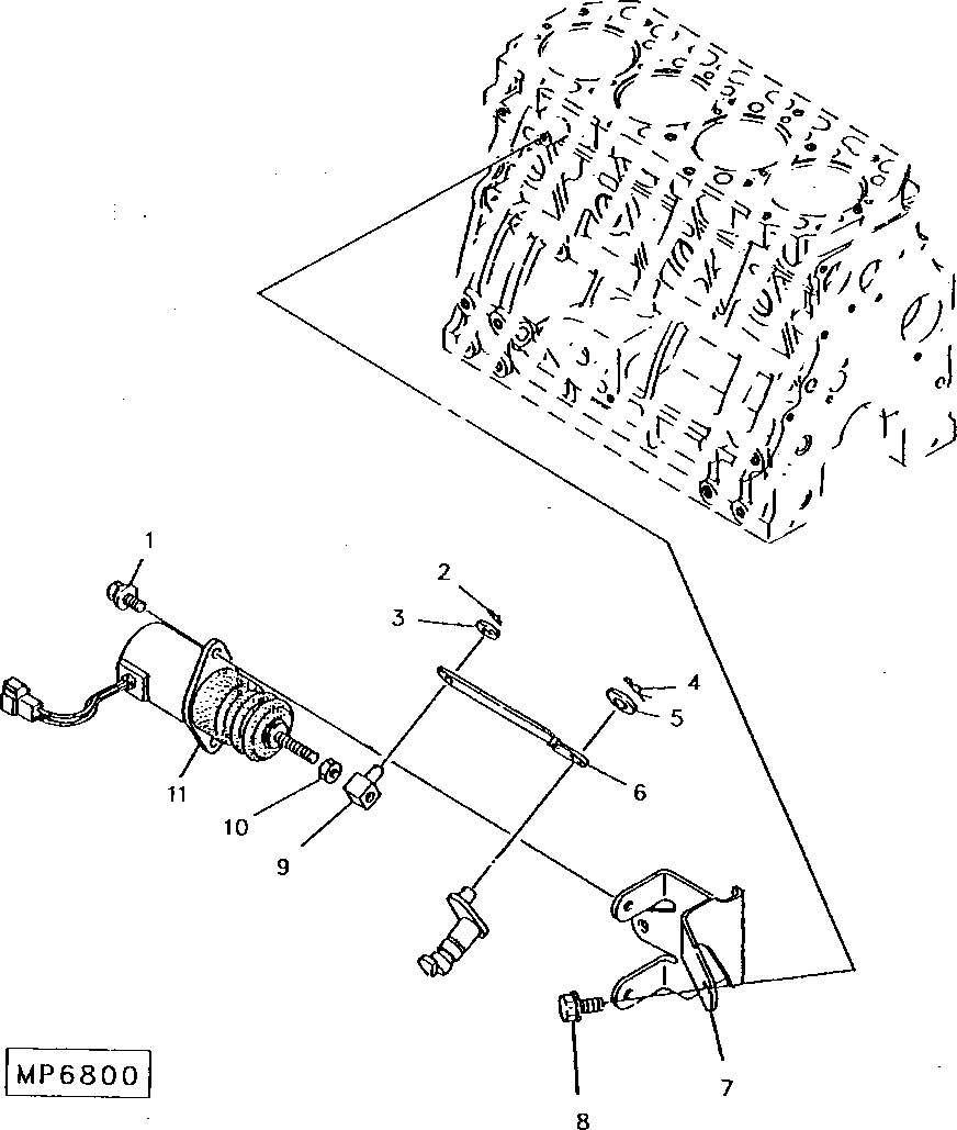

Check the fuel shutoff solenoid. It may be sticking, out of adjustment, have something fouling the linkage, etc.

Thank you!!
Spot on. A few drops of lubricating oil and voila!
