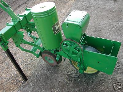

So I'm curious, what does the fertilizer attachment look like?. Does this have the fertilizer option or the pesticide option?:
Thats from an ebay auction. I was at a farm auction here last week and they had some 12 row 71 planters but I don't think any had the fertilizer option.

That's a pesticide applicator. Besides not placing fert. where it's supposed to be, the delivery rate would be extremely low with that. Pesticides would be applied in minute volume compared to granular fertilizer. Even at their highest application rate, a pesticide box just wouldn't put out enough fertilizer. And from what I recall of them, pesticide applicators need more of a powdered product as opposed to granular products like most fertilizers.

Take a close look at the Deere planter and notice there's no fertilizer openers. They appear to be missing. Normally those would be coulter style openers just to the rear of the shoe openers on the seed drop. From what I can see in that picture, the fertilizer just runs out on top of the ground behind the seed openers. Not the ideal situation where fertilizer is placed just to the side and slightly BELOW the planted seed where new roots can find it.
