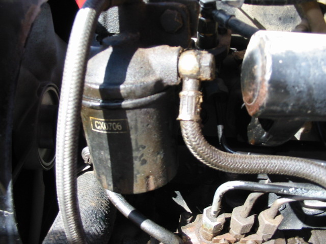

I attached two pics; one showing the filter; looking at the pic then I sould be turning to the left, correct; or if the chinese use reverse threads then I should turn it to the right?

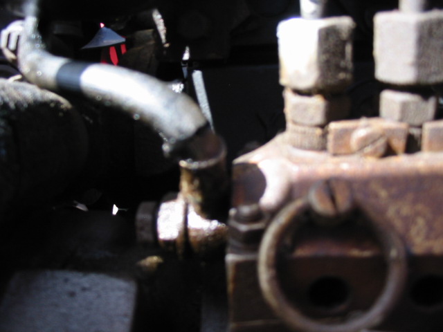

The second is a hose that has a significnat crack right at the fitting; there isn't fuel seeping her though; is for air?

Filter: As you're looking at the photo, have the wrench handle pointing to the right and pull it to the left - counter clockwise, or anti-clockwise as our British cousins say. It is a standard RH thread, like all filters I'm aware of. If it doesn't want to unscrew with the filter wrench, try a big pair of water pump pliers if you have them. Failing that, you can take a sharp cold chisel and work at the crimp seam where it meets the filter housing. Note: you're not trying to cut the filter loose - the chisel should be placed on the crimp and angled so that a hammer blow on the chisel will make the edge dig in a bit and turn the filter. So the chisel should be angled from the right to the left and you're shoving the filter to the left when you strike it. You don't beat **** out of it, either. Do it in one spot with a couple or three moderate hits and then move to the right an inch and do it again. Go as far around the crimp as you can reach until it starts to move and then use the wrench. Far more than just one way to undress a feline, eh?
That hose is a fuel line, not air. Maybe the return-to-tank line. It will have fuel in it, but not at injector pressure, just lift pump pressure. I'd pickup a piece of braided fuel hose at the auto supply and replace it - it's cheap. Chinese rubber doesn't seem to hold up well, for some reason, with the exception of tires which are generally okay. Radiator hoses, fuel hoses, air lines, they all crap out sooner than American-made stuff, but replacement hose is easily available. For shaped radiator hoses, take the old one with you and find one that has the right configuration - doesn't matter if its too long, you just cut out the section that matches what you have and you're good to go.
That's called a banjo fitting, and it looks bent. I'd replace it before you end up spewing fuel all over the side of a hot engine some day. Can't tell for sure, but that looks like the hose between the filter and the pump. One of mine blew while mowing a dry field, and I'm lucky I didn't start a fire.

This line runs from the item below to right in the pic and then up to 'rail' of sorts connecting to the first cylinder and then to each of the other cylinders.
The defective hose in question is the fuel return line to the tank via the injector bleed-off lines. You can tell it's the fuel return line because of the pressure relief/regulating valve banjo bolt - look closely and you'll see another hex head on top of the banjo bolt.
I'm not sure of the filter removal instructions given, a little ambiguous to my mind, but if you were underneath the filter looking up at it, it would want to turn counter-clockwise for removal. Lefty loosey, righty tightie. :D

Well, tried all of suggestions here; still couldn't get that filter off. Had to disconnect two lines and remove the bracket holding the filter, take into the garage put it in a vise with filter pointing up, drove the long screwdriver thru it and after 4-5 tries the seal broke and the filter started to come loose. OMG! Got the new filter on and now it's back to reinstalling everything. :)
