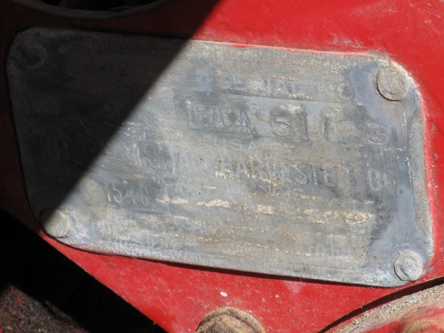

Make sure you get the Decal set for McCormick Deering Farmall A (pre 1945) without the IH logo and not the Mccormick Farmall A decals.(post 1945). Not sure about the cultivision in the A but my 1941 Farmall A does not have it.
Stiener tractor parts or OEM tractor parts can make up a new serial number plate for you using the serial number from the block for Farmall A as the numbers were matched. Make sure you get the early style plate as in pic. The letter A is in the shaded area in the pic below then the plate is stamped FAA then your serial number .The 1540 is the max RPM. They can also supply a lot of parts used on these tractors.
