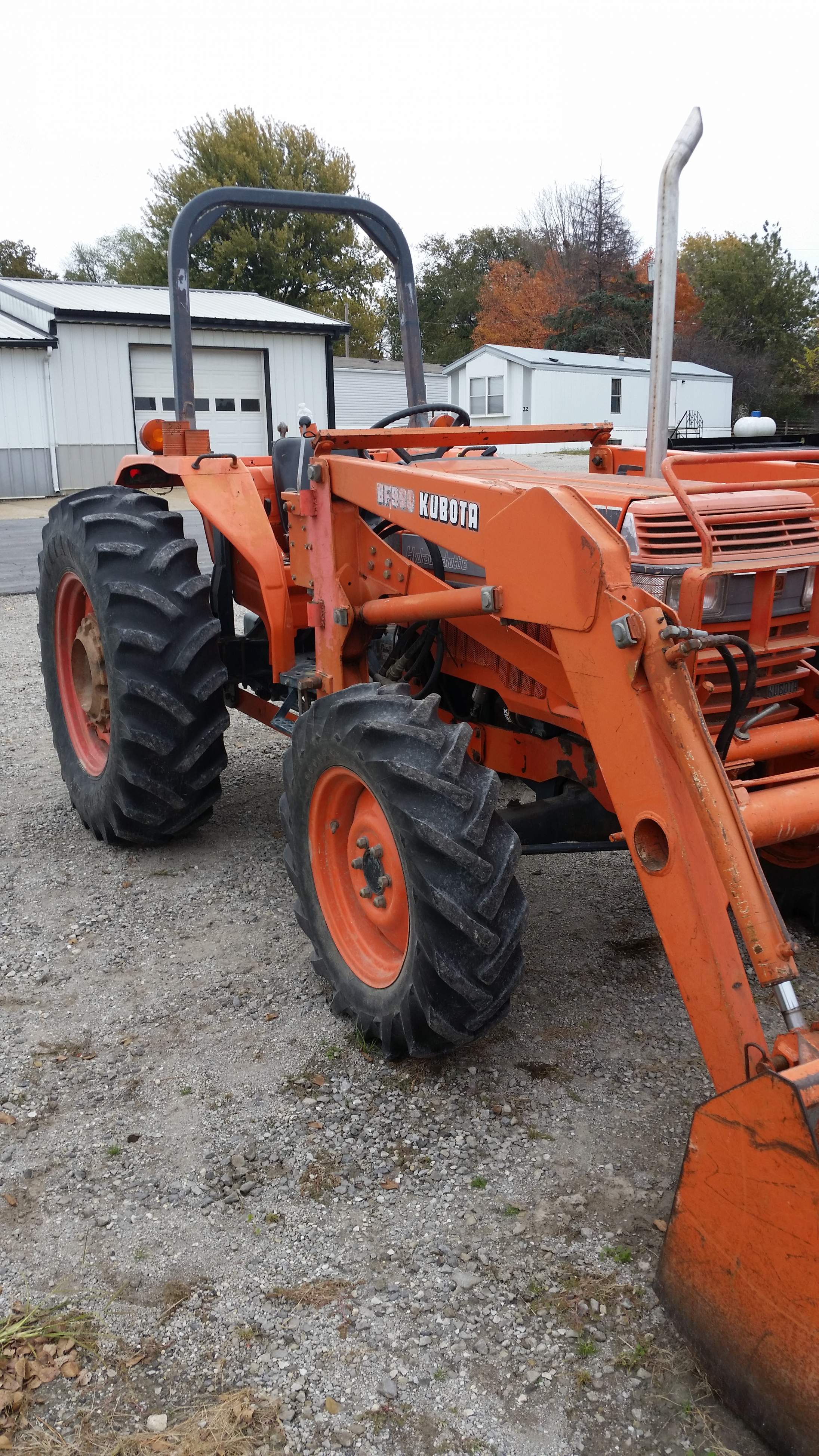

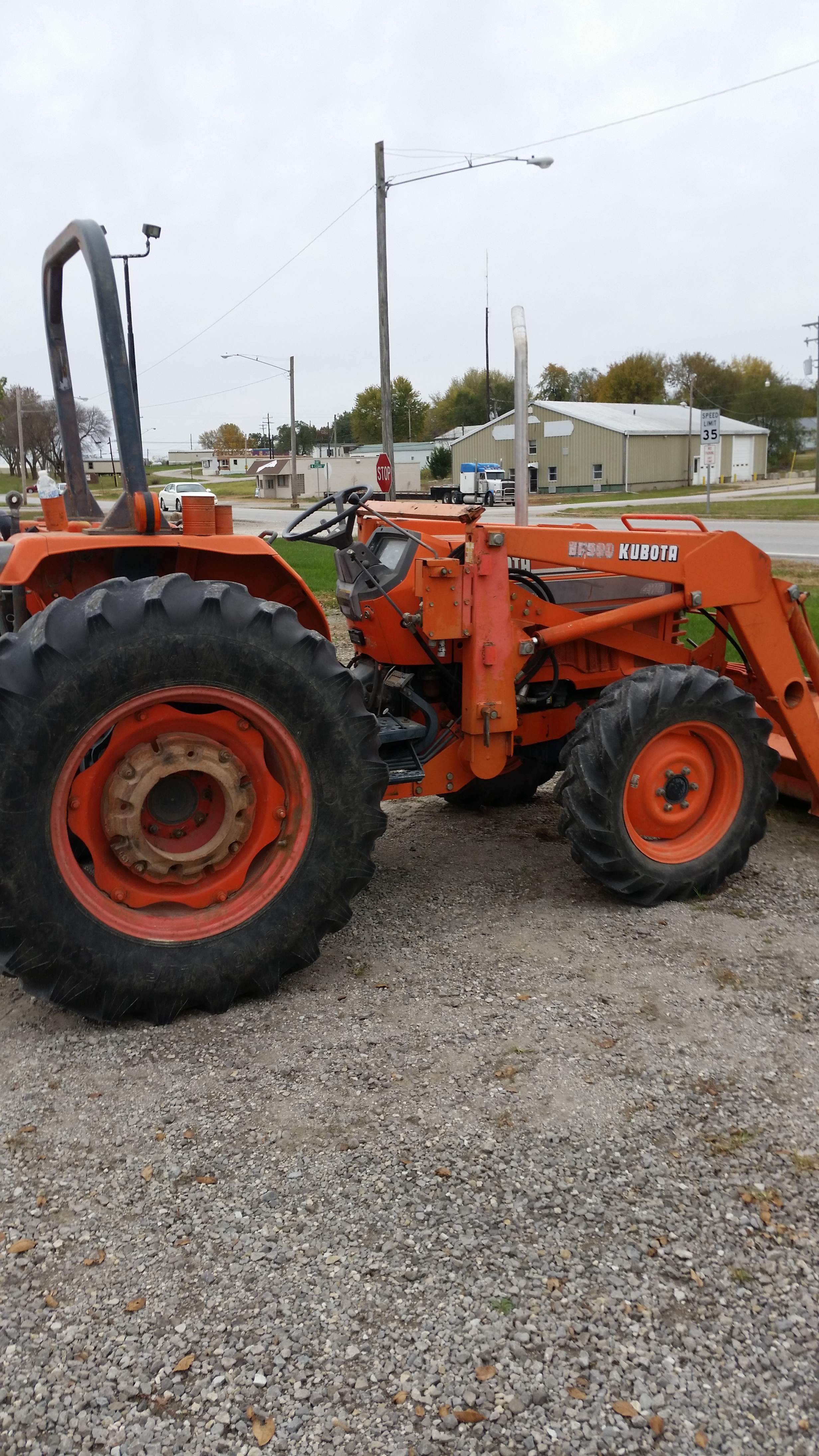

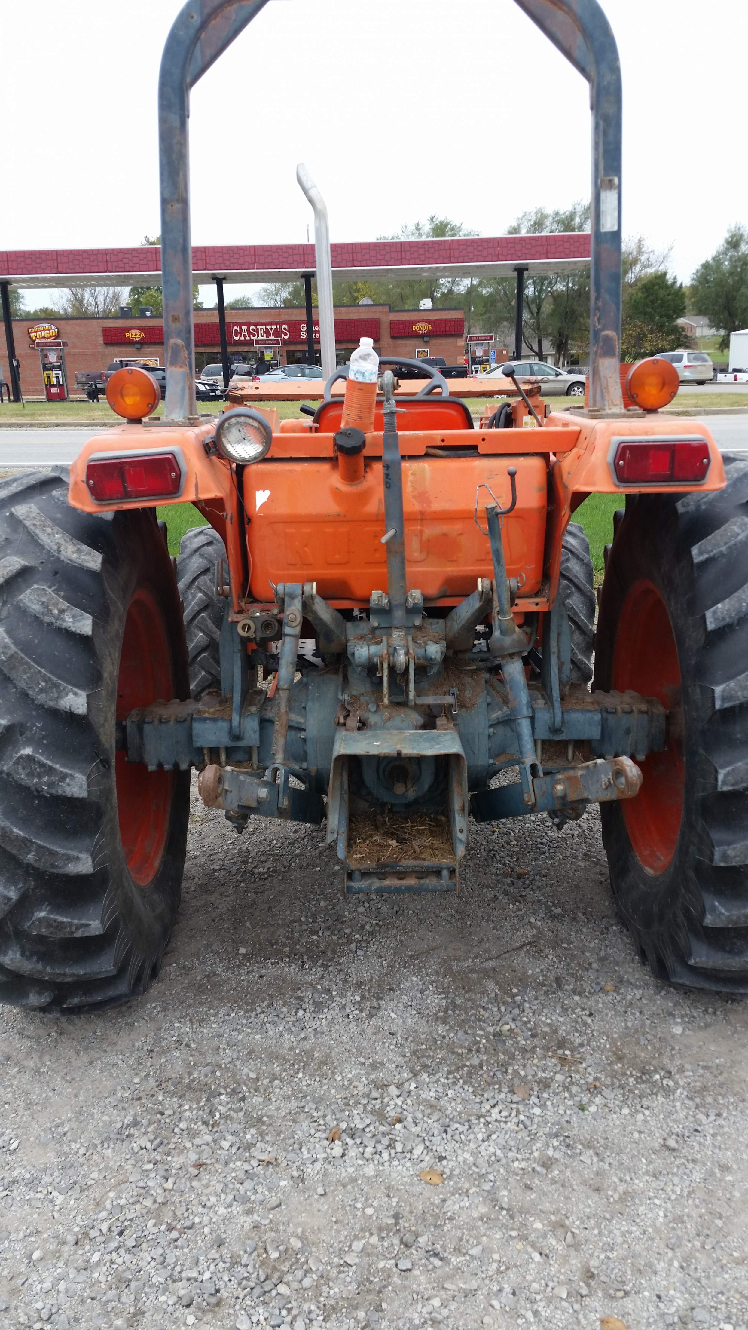

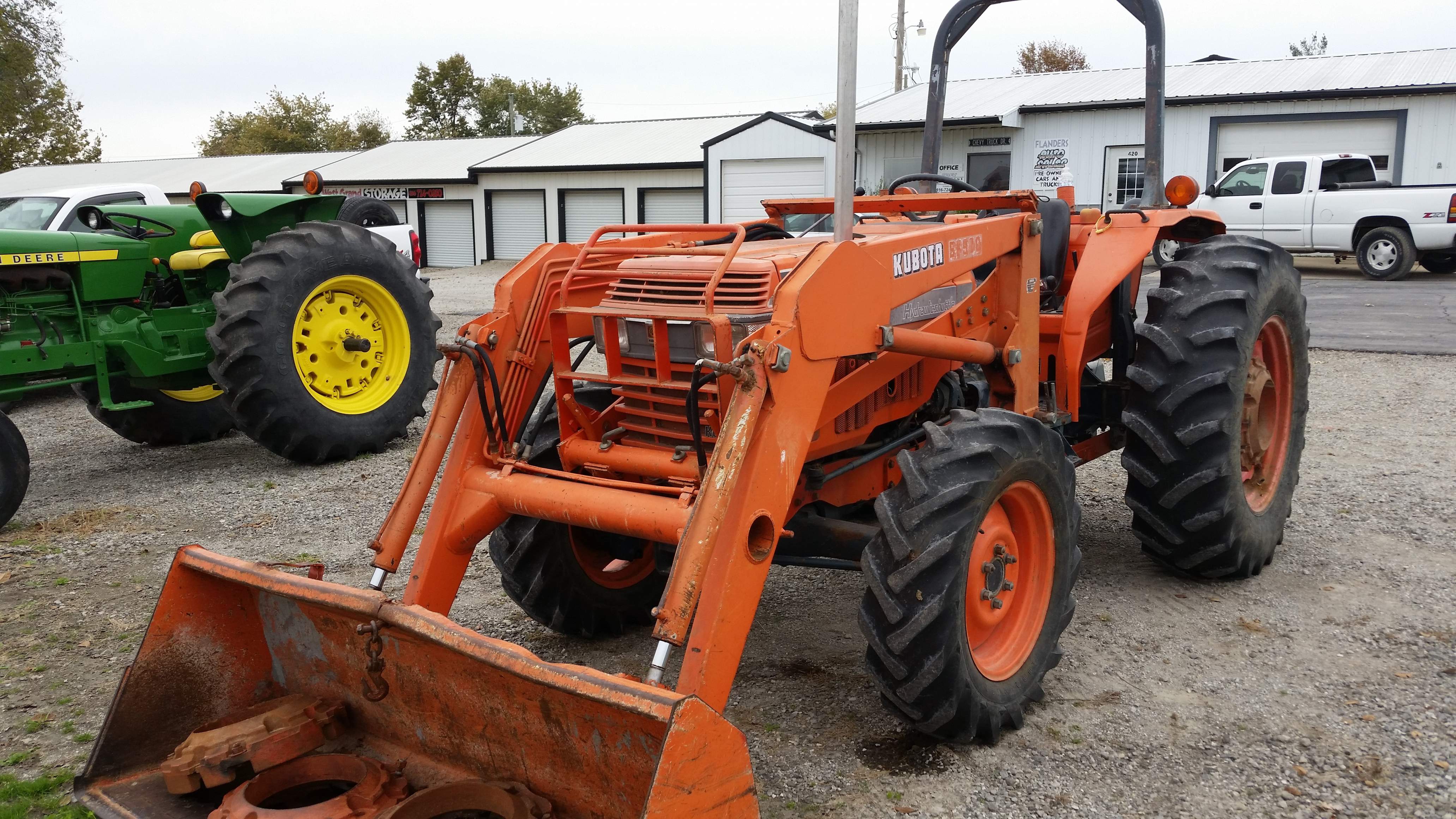

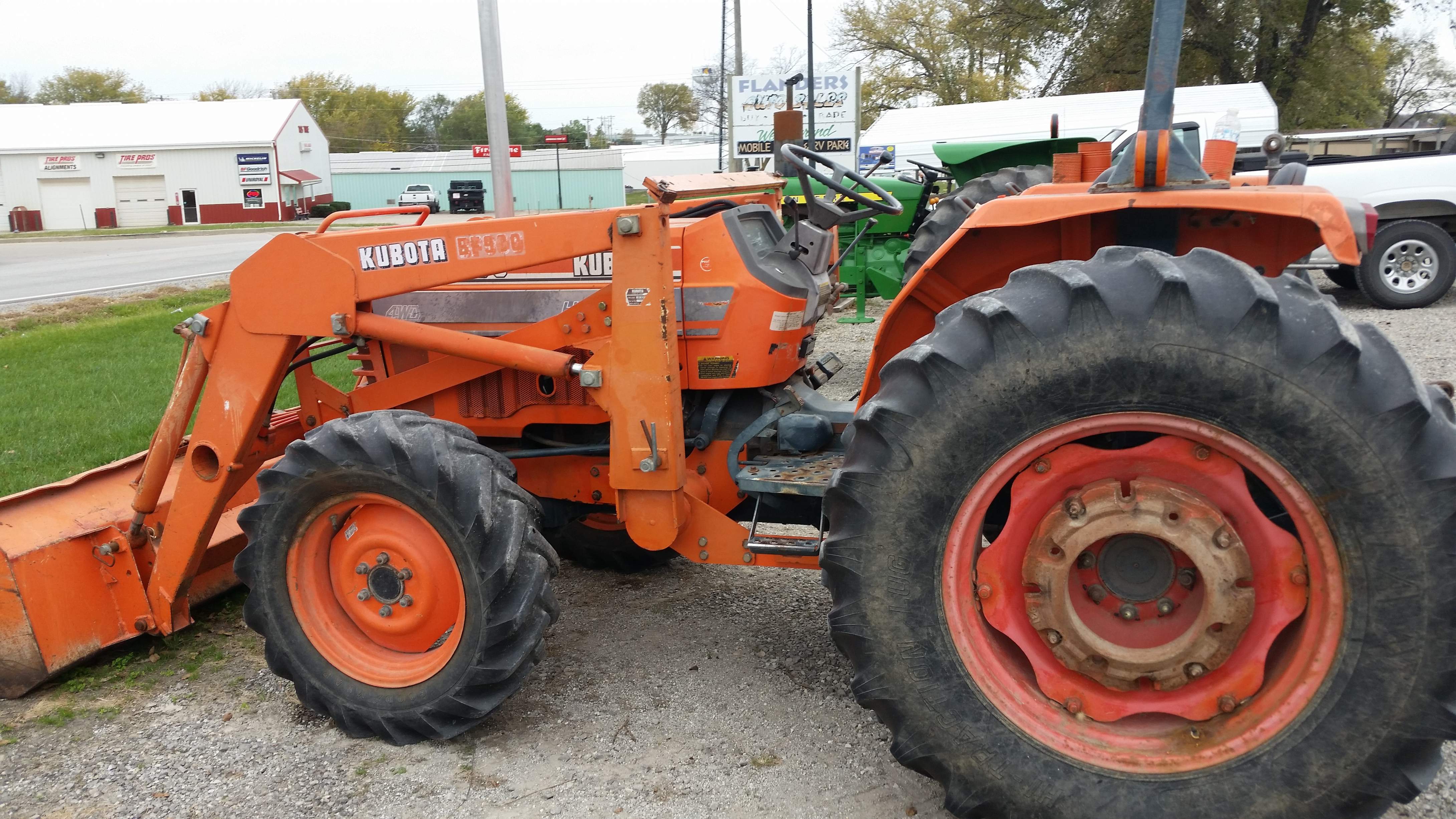

Found a farm fresh l4150, everything seems to work, needs lots of tlc. Priced a little high for what all needs to be done. Both front hubs are leaking, it's moved lots of big bales,oil plug is leaking,rear tires have or had chloride in them, they're rusting, looks like original tires, rears are titan, fronts are goodyears, remotes are full of grass, bucket has a welded plate on the bottom. Can't get the pto to stop spinning?
Enjoy the pics....

The L4150 is relatively heavy and powerful as compact utility tractors go.
This one has hydraulic shuttle, dry dual-stage clutch with separately adjustable pto disk. For the dash winking out, check the fusible link near the starter - a white plug with looped red wire that corrodes inside. Grass in the qd's is better than stone dust - spray with brake cleaner.
The pics show a machine that's been stored under cover and has had a non commercial life. $11k asking price isn't out of line if its engine, trans, hydraulics, fwd are all functioning. 50 hp tractors aren't usually much less unless they need a major repair. Any idea if the hydraulics are strong? Any loader leaks?
