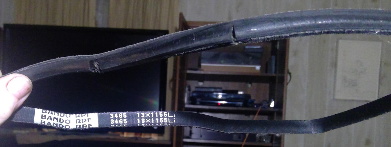

Runs AC & Waterpump less than 100 hours, anybody else have trouble with AC belt slip

No but I'm guessing not tight enough from the factory... and never rechecked.....:confused3: But buy a good belt made in the USA, Gates or NAPA....
   / fan belt fail M7060HDC #3
Yep, check the tension.
I wish the newer machines had automatic tensioners.

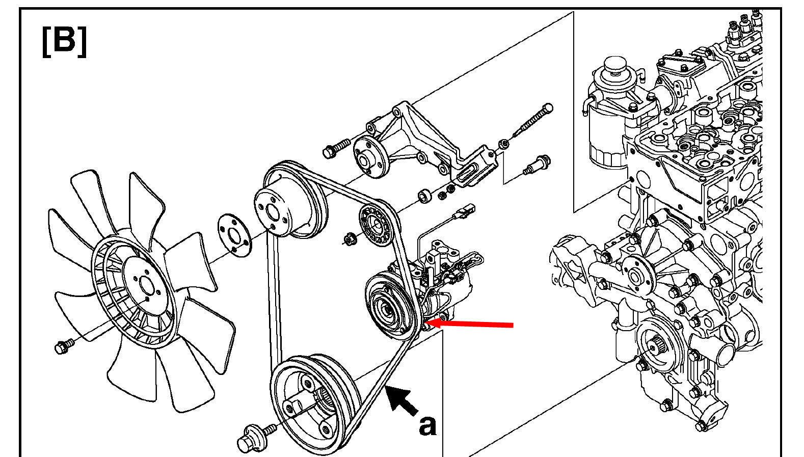

I think Kubota goofed that belt doesn't wrap far enough around the AC pump pulley, to get enough grip. They should use a flat idler and gone under the tension pulley

To my eye that belt looks like one that has been run at the limit of it's ability to handle heat and stress. Do you tend to run your 7060 at high RPM & the AC turned up?

hopefully because nobody else has mentioned it was fluke, that a new belt and proper tension will cure. Was very hot and turning a bush hog doing heavy cutting at 600 pto speed. I thought general rule was cover at least 90 degrees with belt the AC looks to be only slightly over 45 degrees
   / fan belt fail M7060HDC #7
Looks like the more you tension the belt - the less coverage you get on the air compressor pump pulley. Perhaps - not the best of designs.
   / fan belt fail M7060HDC #8
I bet if you looked around you could find a flat pulley maybe smaller diameter and put the belt under the tension pulley......
   / fan belt fail M7060HDC #9
ditto I never noticed until now that my M7040 has same type location of belt tensioner.. My tractor has over 1600 hrs on original belt. I do think AC sheave should have more pulley to belt contact area.
