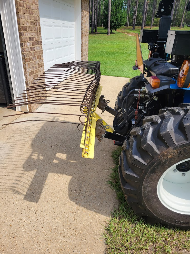

Wife was raking up pine straw for the chicken hut today, so I did not see this happen, nor did she, just the aftermath. We've used this rake for a few years without issue, it is not a new implement for us.
The pine straw rake flipped at least 90 degrees, the hydraulic top link was down low and hit and bent the PTO cover.
The steel bar on the rake bent from the pressure. I forgot to take a picture of that, and we have since made repairs.
Is the only way this can happen is if the top link was retracted too far?
I moved the top link and lift arms in the field trying to correct the issue, so these pics are not in virgin failure form, but WTF happened?

What 2515R Dude said, plus, you may want to put the top link on the bottom hole on the tractor side. Kinda looks like the rake was meant for those smaller tractors that don't quite have a true Cat 1 3pt hitch, so the distance between top link pin and bottom pins on the rake is too short.

The Pat’s quick hitch is also a contributing factor. Lower link being longer made it possible for the top link to cam over when it is too short.

@K5lwq also provided a great point. The PATs only made it worse in this case, since it pushes the implement further away.

Yes. If you use Pat’s quick hitch you need to buy a longer top link.
Ditto Pat's quick hitch adapters changes the geometry of the 3pt centerlink causes the problem in the photo when centerlink is too short. My guess is hyd center link rod needs depth stop segments added to the rod to help eliminate future problems.

Easy solution without changing anything : I guess your wife, when she collected a big pile of straw infront of the rake, she wanted the rake go over this pile and shortened the top link too much.
Just explain to her what happen and ask her to pay attention on how much she can retract it to avoid similar situation. Or just lift the rake all together or go in reverse. Just experiment a little, When you now where the problem is, you can easily find a way to avoid it.
Also a little tip. If you attach the rake to the lower hole you would be able to lift the rake higher without using the hydraulic top link.
