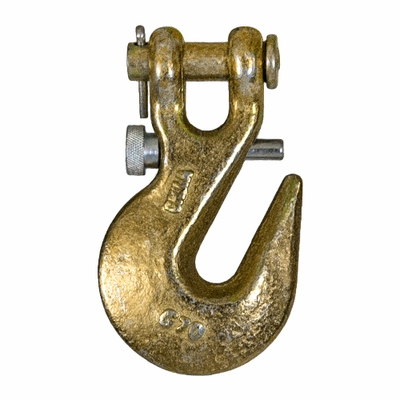

pretty new to chaining anything. For my grade70 chains i dedicated to my tractor's trailer, i bought 'locking' style clevis grab hooks
  • because it makes setup a tiny bit easier (no dropped hooks before i get it snug), plus
  • theoretically in a "bad event" where there was a some momentary slack (broken chain on a different corner, collision, etc) the locking pin might keep the hook engaged until the (shifting - again, SHTF situation) load finds a new position. Theoretical, border case; but I drive an undivided winding two lane highway that has zero barriers, a 15' embankment to a river, and a bunch of idiot drivers - so I'll take anything i can get :)
Anyway, two of my four hooks, after just one use, clearly have had some load put on the pin (and the pin can obviously take *zero* load - one locking pin cannot be operated at all, even with pliers, and the other one is very tight now but still hand-operable.

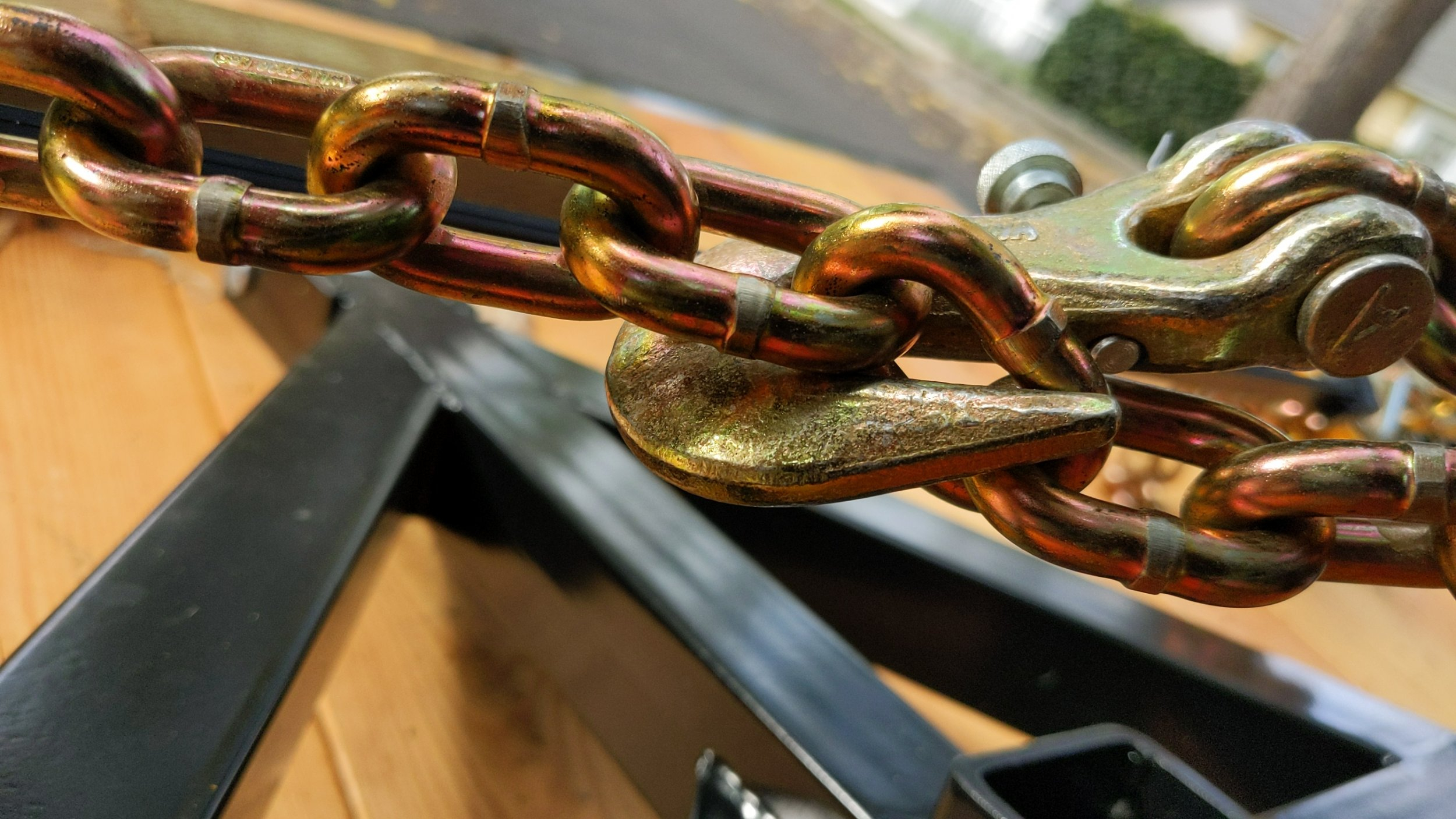

Here's a picture of how I have them bound: This one is undamaged, has ~1/16" gap to the pin in this setup. Of course i didn't know the pins were damaged before i loosened the load the first time, so I don't have any pictures of the 'bad' engagement - but I was pretty careful and it was set up exactly the same way.

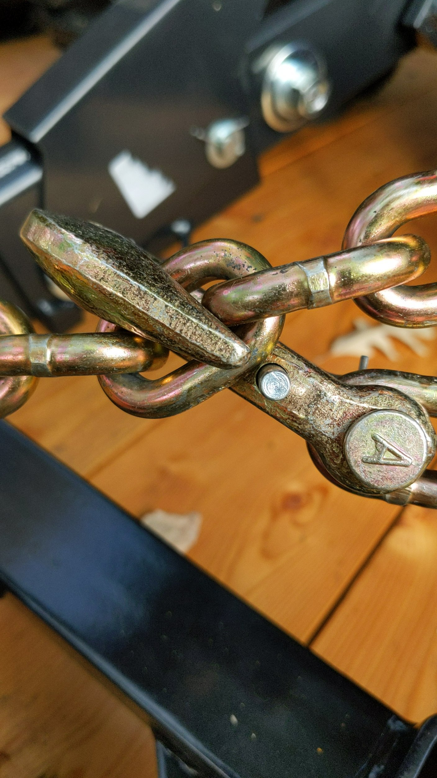

Here's the hook that is still 'barely operable' (I've left the pin open where it stays by friction now)
Can you think of anything i could be doing wrong here? About the *only* variable i can think of is 'loop length' before i grab the hook to its chain; mine are short, maybe 6" here. Thanks!!

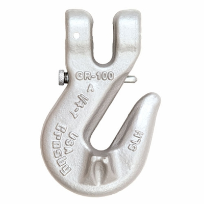

FWIW here is a better pic of the (import) hook i have:
I see a few domestic mfg's that have a better (more space between the grabbed link and the locking pin) design, albeit at (much more $$) grade 100:

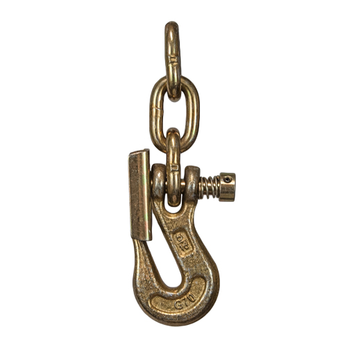

or a totally different design that looks a lot more robust (and if the 'pin' DOES get inappropriately loaded, it can still be opened, i appears

That pin is not meant to take a load. It's just like those spring loaded flip levers. It's only there to help keep the hook in place until you get a binder on the chain. When you hook a chain, you need to be at as much of right angle to the chain as possible. Use a binder to take up a chain that's too long.

Any chance you are using, say, a 5/16 chain in a 1/4 hook? (or 3/8 in a 5/16 hook) IIRC, there's some slot slop that might allow it. But that retaining pin location might be designed for a matched size.
   / failed locking pin on locking chain grab hook - am i doing it wrong? #6
Based on years of using chains, I can tell you those pins would not survive long for me. If it isn't load or wear and tear, just basic contamination will catch up with them. Too fussy to be practical.
