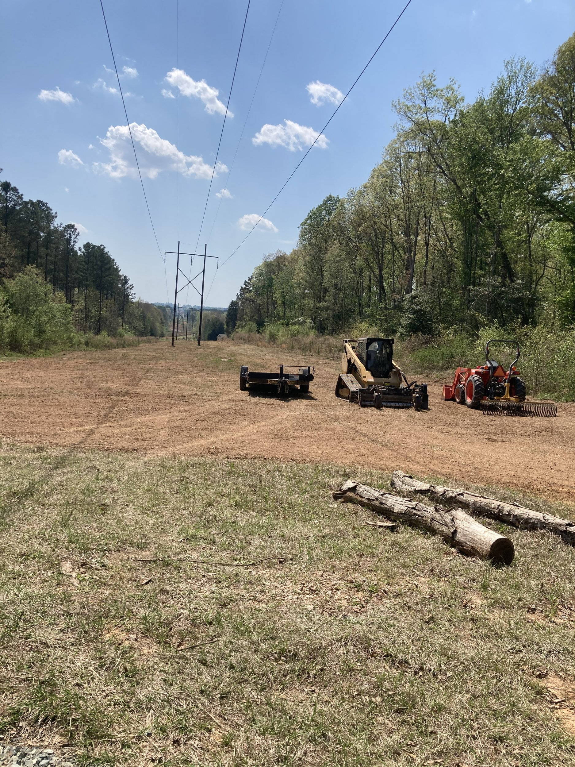

i finally hired a guy to do what i don't know how to. i could learn and i will learn but, what took him days would have taken me at least 2 weeks etc etc. i don't have the time and the seeds gotta go in soon. The county rents a seeder called brillion?
He bushhogged it, raked it, harley raked it and went back and hit the high spots. then he put down 6 tons? of lime. The area is 3 acres of duke power easement....aka, semi private driving range.
This guy is a character, just retired from army, 40 years old. Hard worker! Hunts predictors at nite with IR equipment. I traded him my drone for a cross bow.
