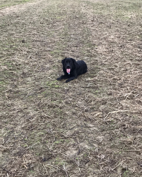

This is the picture before the farmer smoothed it. A buldozer isn't going to improve that much. It would could easily be mowed with a rough cut mower as is. It got better after that. I'm guessing better than a pasture but not as good as a lawn, The OP wants a lawn. He will figure things out eventually.

That's a great deal more smooth than my 'lawn'.
Really not sure there's any more to do that time won't do naturally.
