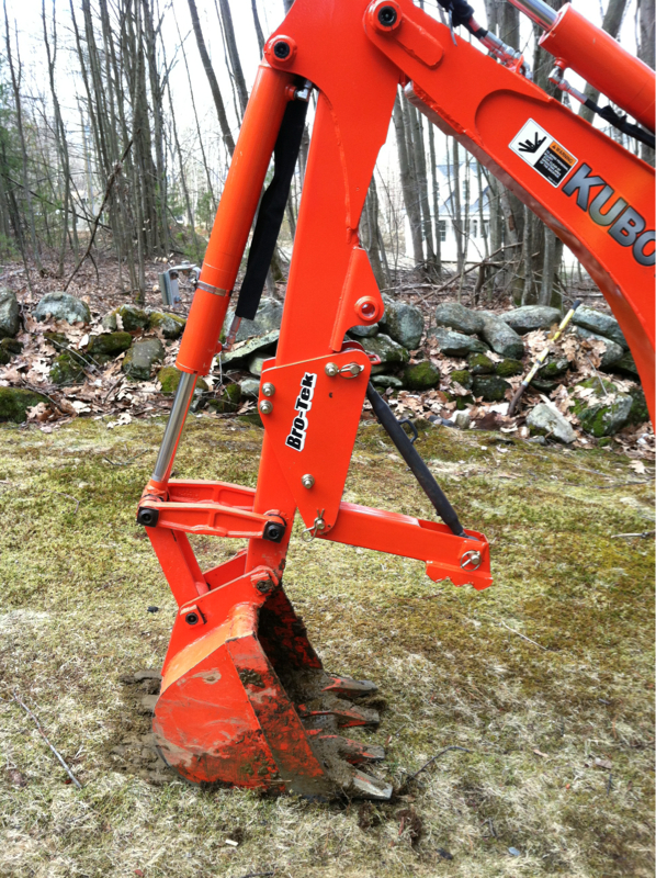

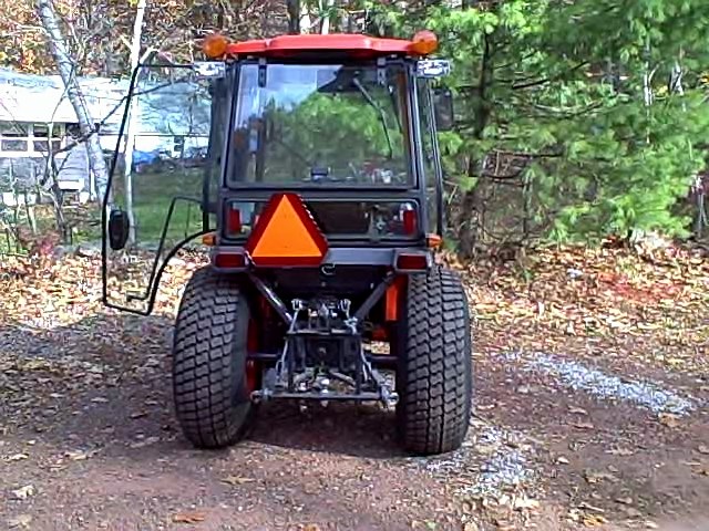

I too have the Bro-Tek spaces on my B3300 & they're excellent! Superb quality, price & customer service. So good in fact that I subsequently bought a mechanical thumb for my backhoe from them too!
