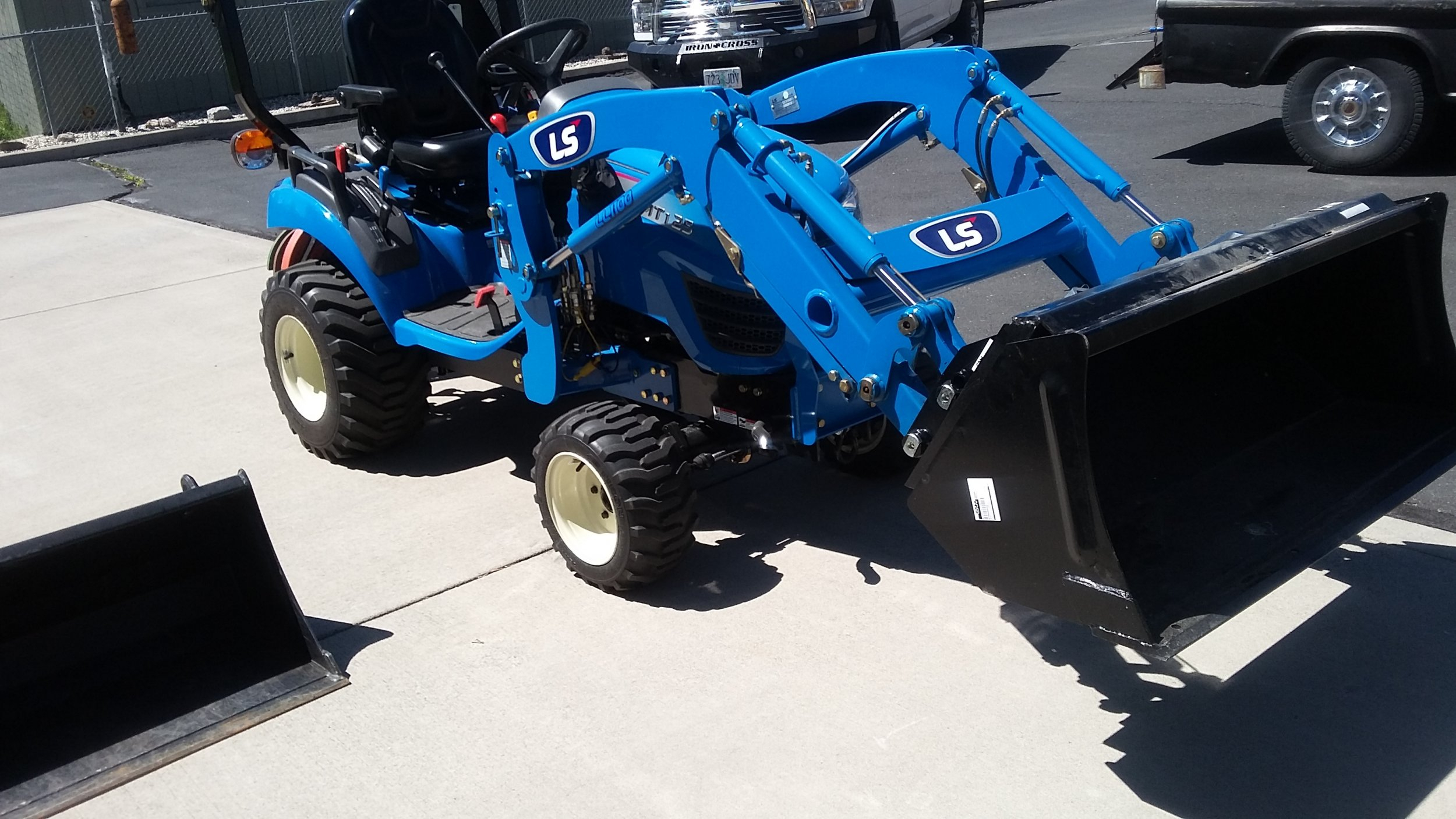

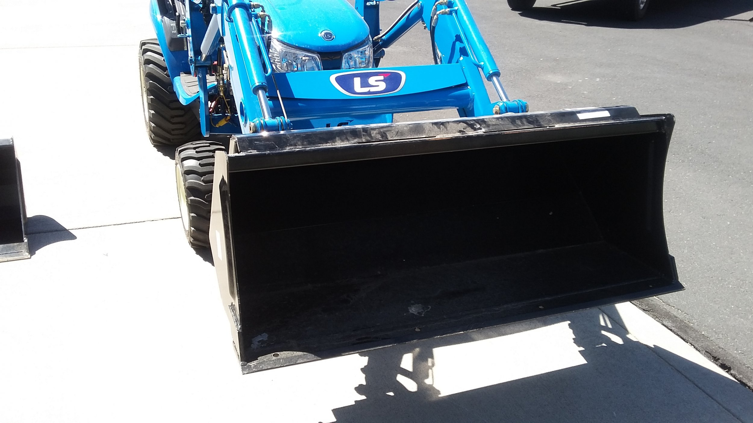

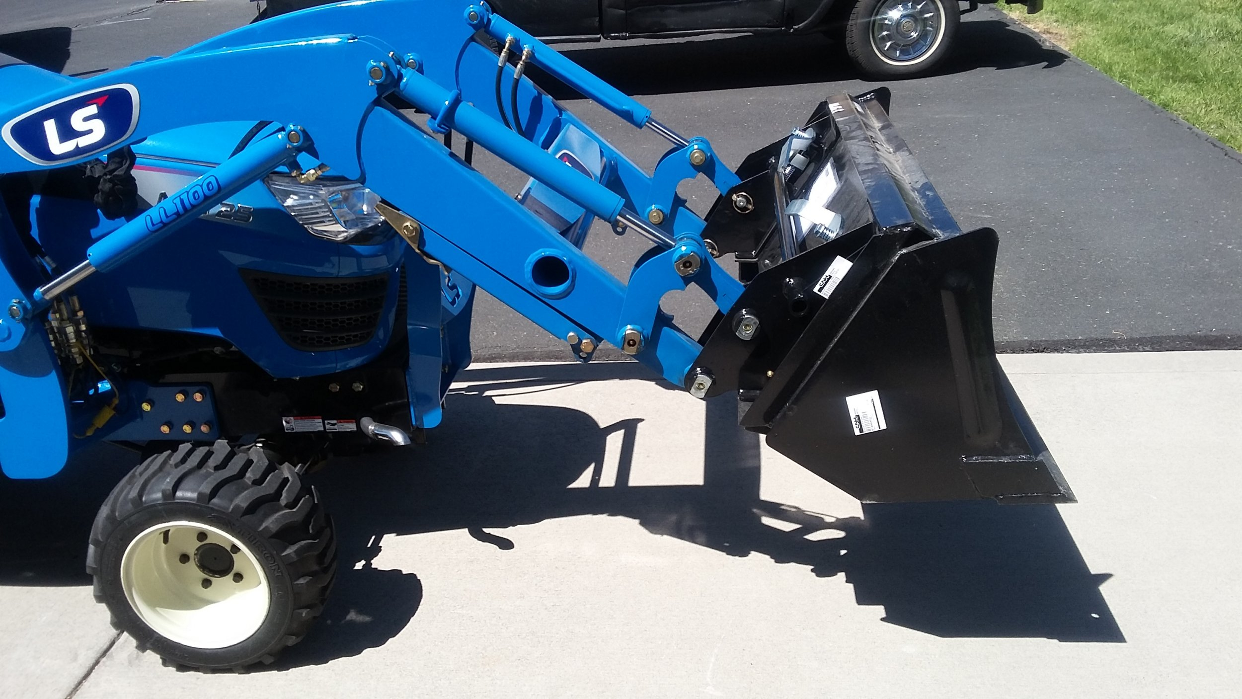

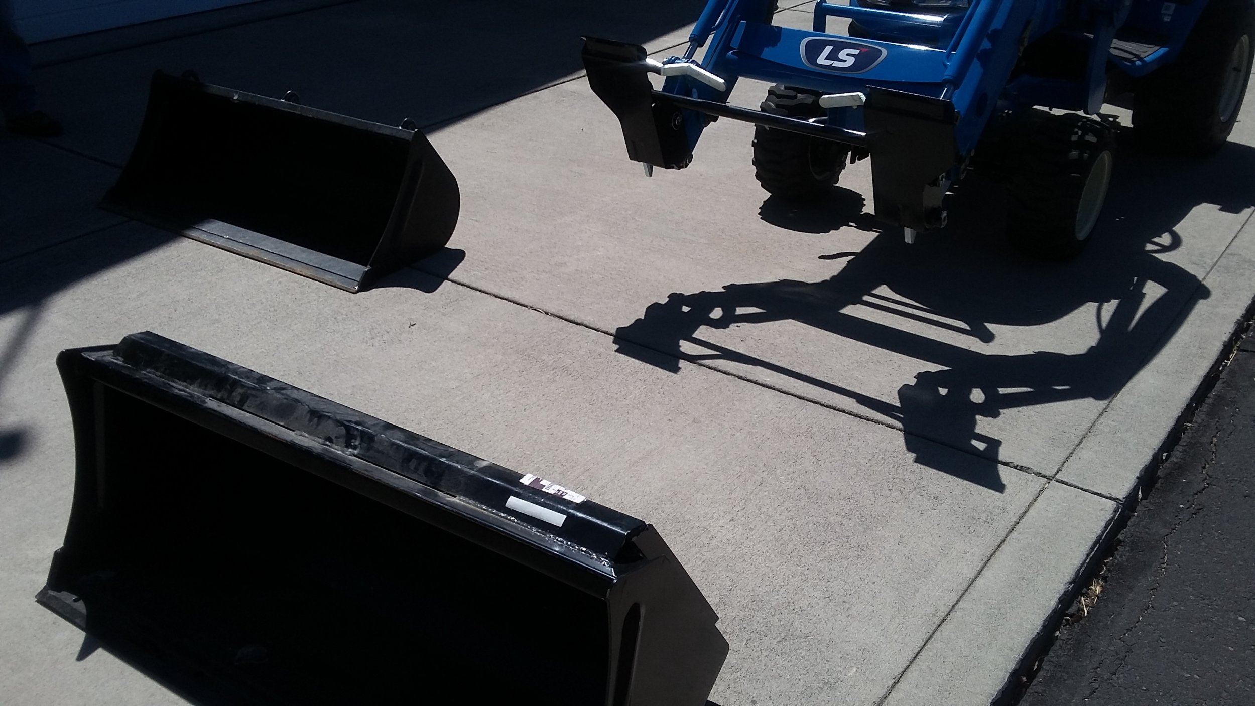

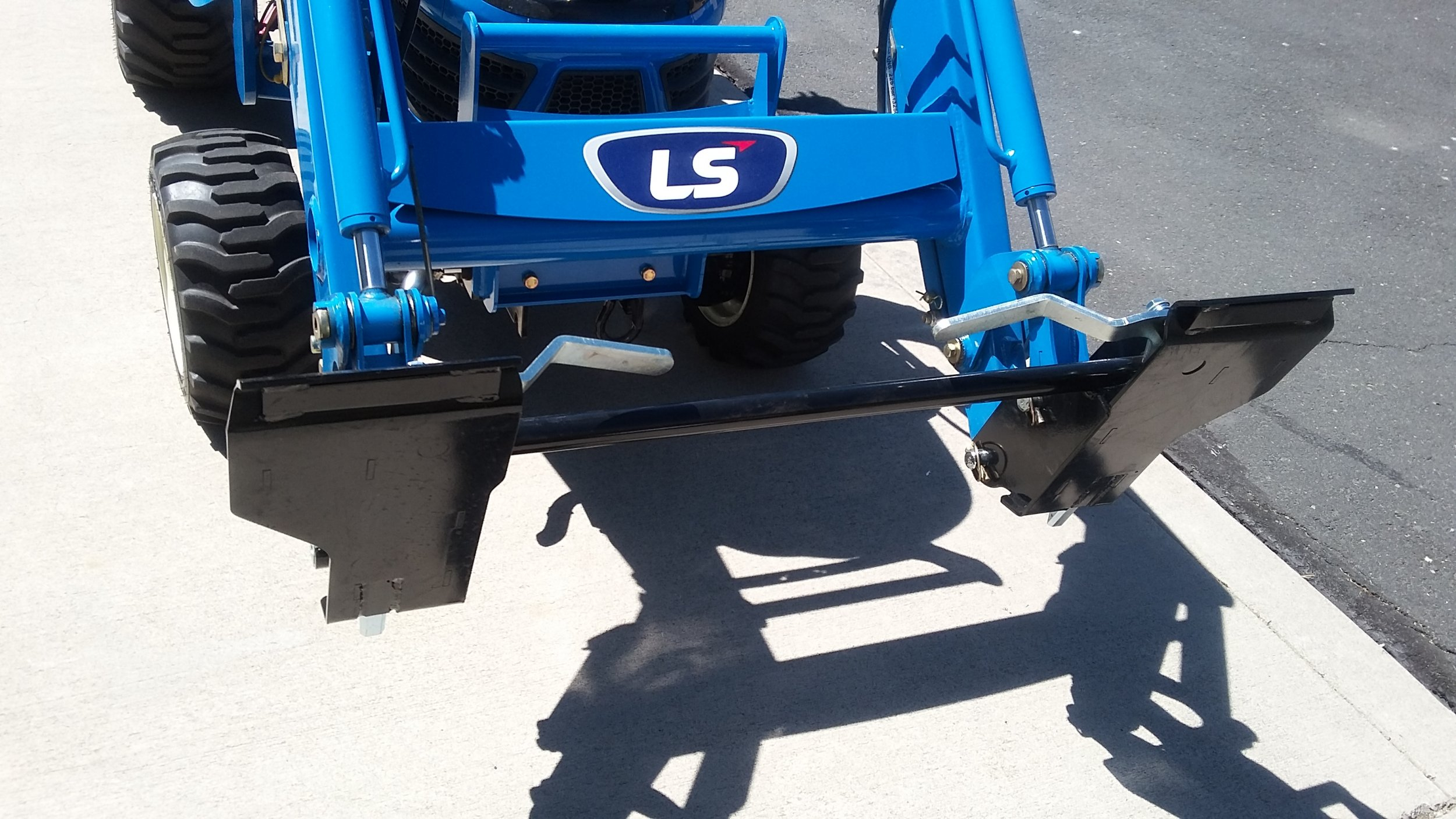

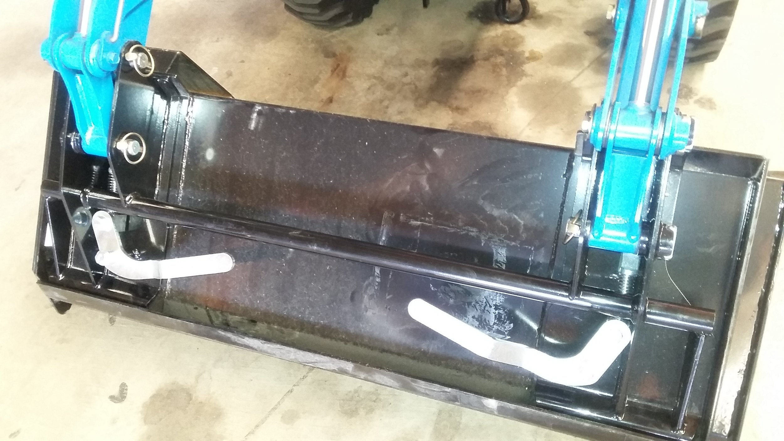

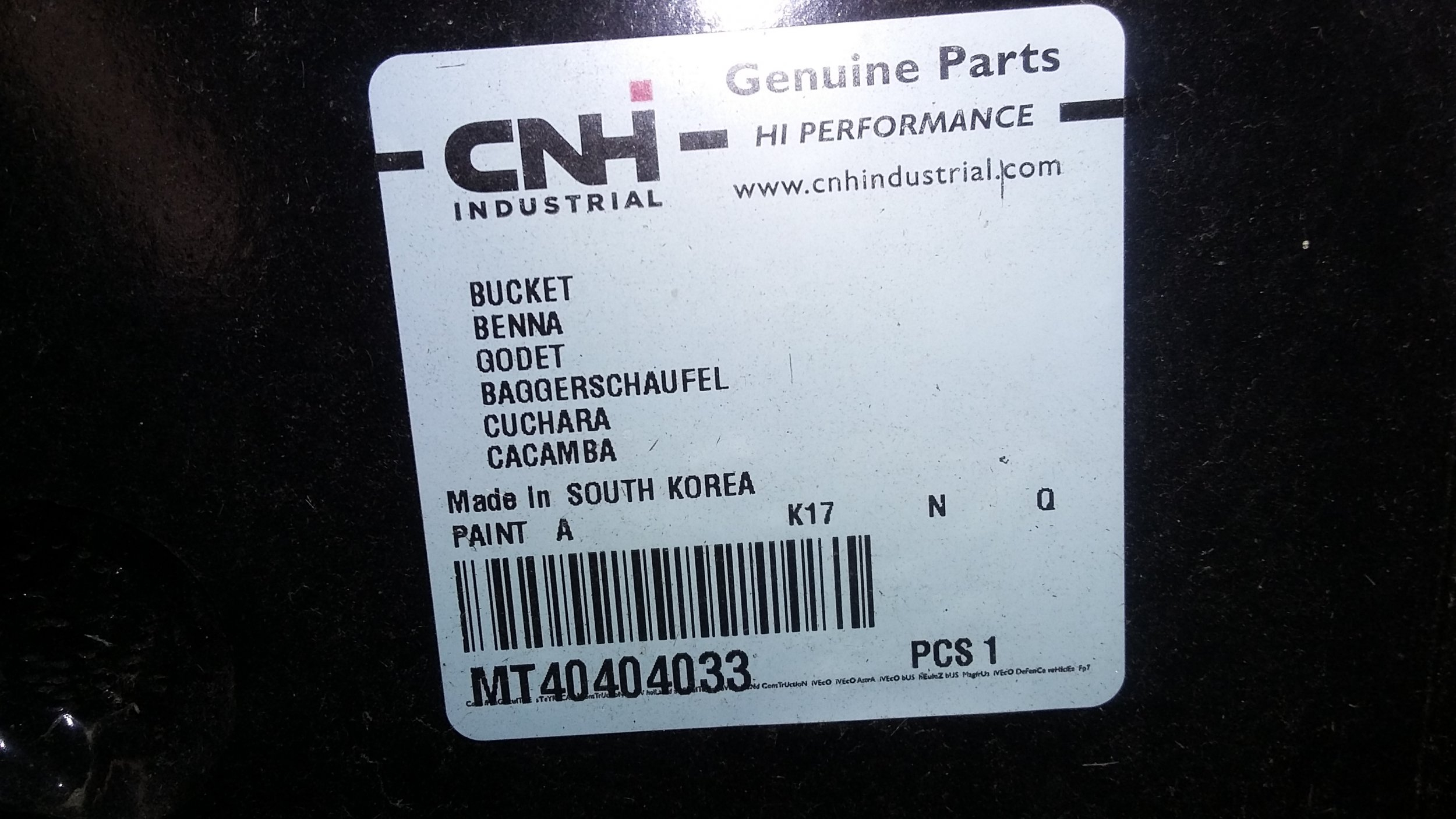

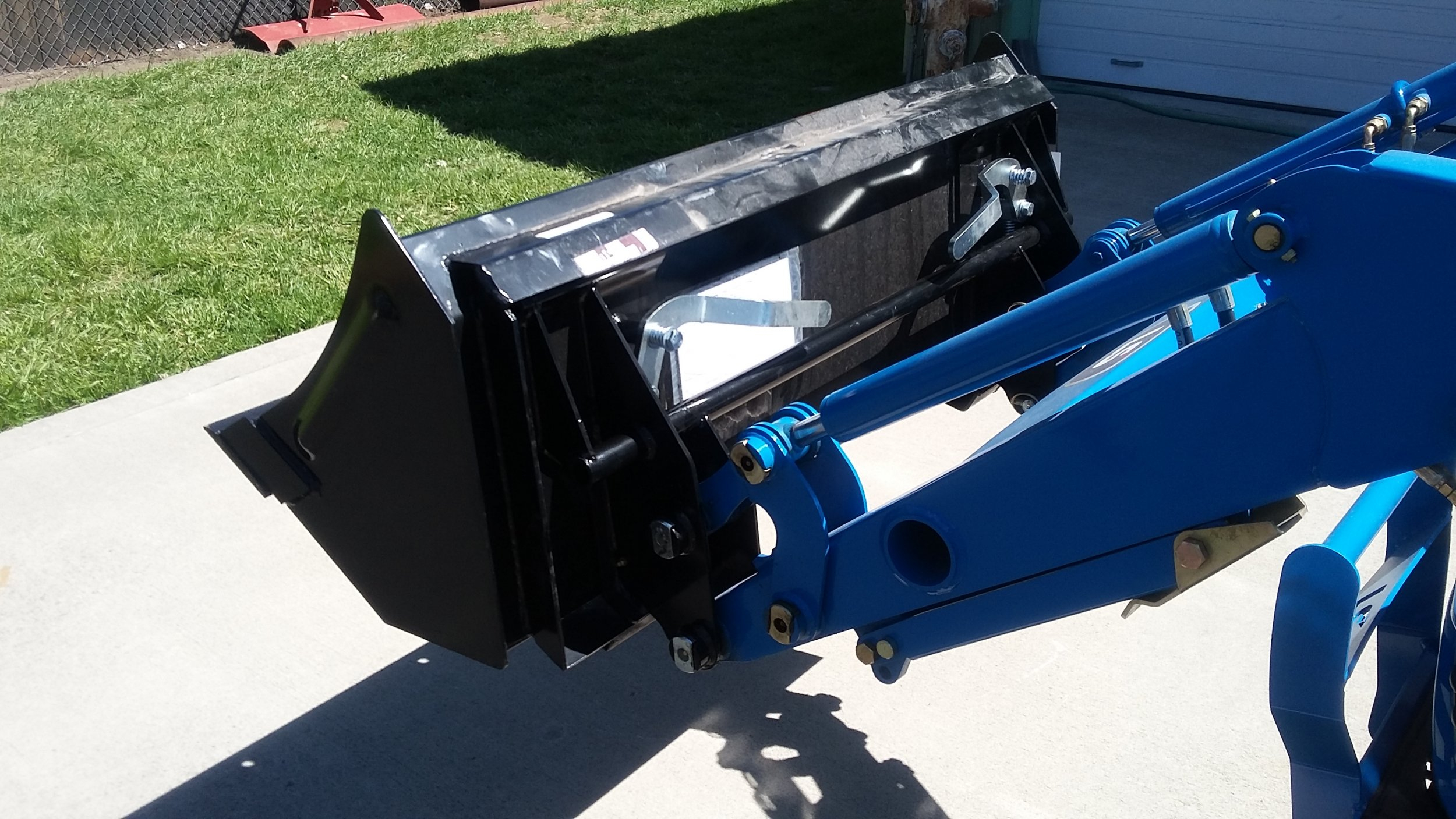

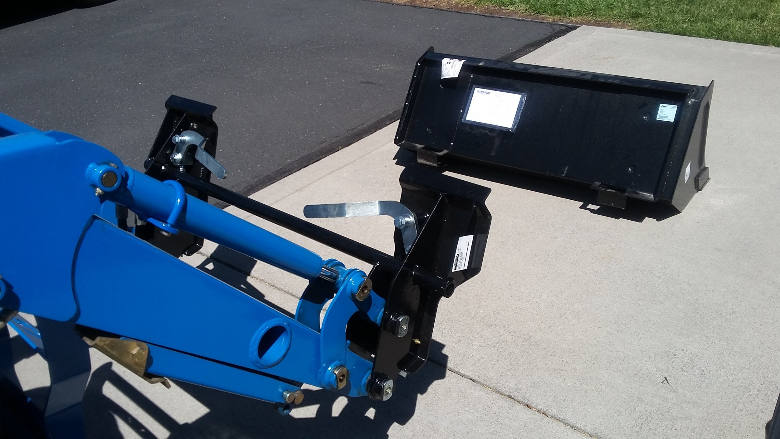

Okay Gentlemen, Christmas came early for me today. I got a call from my New Holland dealer and they said my SSQA adapter and bucket were in. I drove my pickup down and they loaded the parts into my truck. I used my MT125 to unload everything as I put hooks on that bucket. Well I unpinned my factory bucket and installed the adapter with the pins supplied as they were just a little longer then the original pins. It fit perfectly and then the fun part, I drove the tractor with the SSQA on it and rolled into the new bucket, lifted and tilted back and put down the levers and BINGO I was attached!! I now have and industry standard SSQA on my LS MT125 tractor and couldn't be happier. BTW, I bought my tractor in 2017 and it has the LL1100 loader on it.. Here's the pictures.

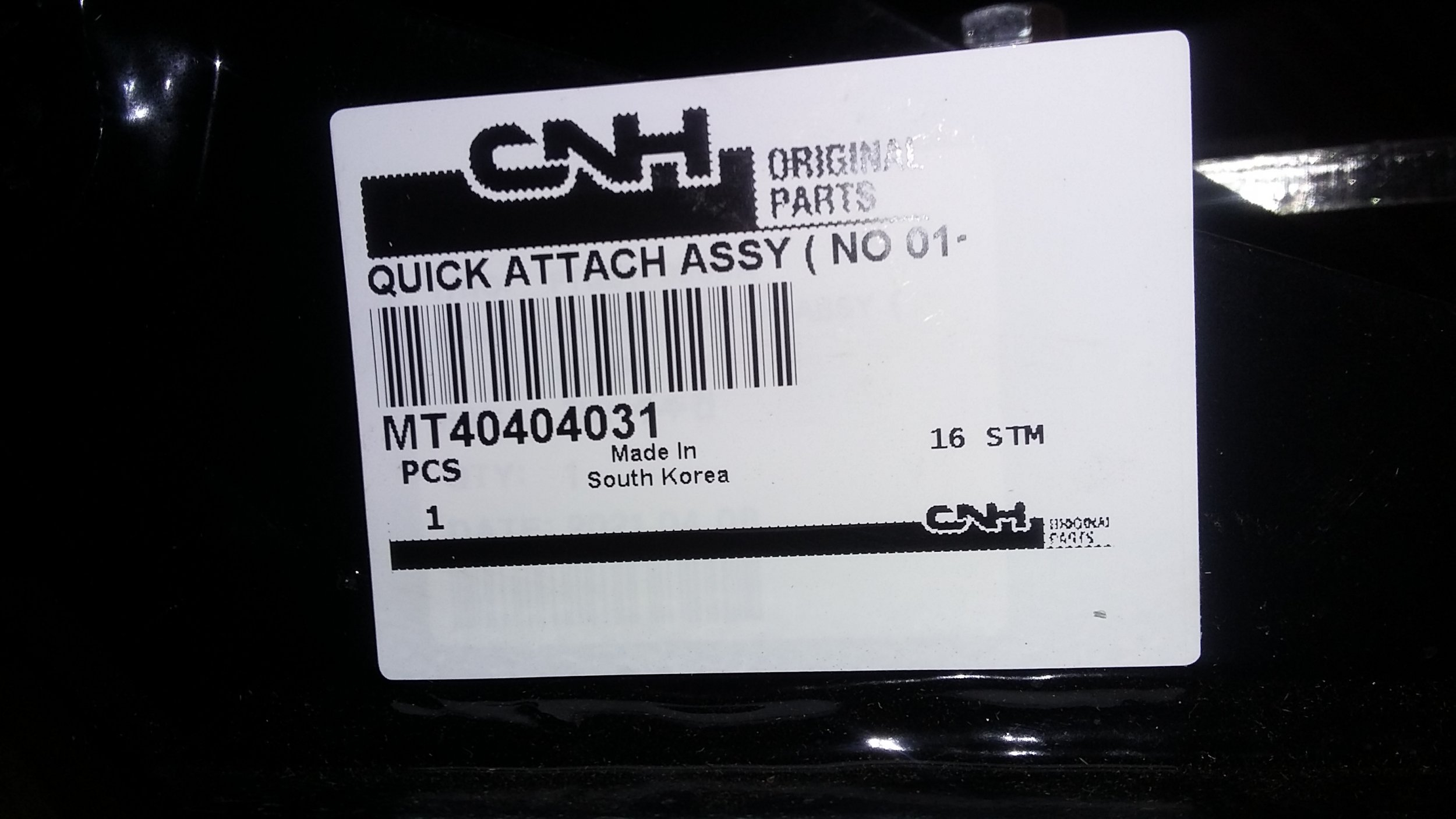

And the part numbers if they didn't make the group of the last pictures.

Nice! Now you're going to question why you didn't do it sooner!
View attachment 744663View attachment 744664View attachment 744665View attachment 744666View attachment 744667View attachment 744668View attachment 744669
And the part numbers if they didn't make the group of the last pictures.View attachment 744672View attachment 744674
Oh man, Thank you for doing this. I am so Jelly, and will be calling tomorrow to order. I wish you the best with your upgrade.

Well I wanted to do it for a long time but it took a lot of research as there is a lot of conflicting information out there. But I learned a lot about the SSQL "quick attach" and shared it here. So now we can upgrade our LS MT125 and have a better tractor. Thank you guys for all your help, questions and encouragement. I blazed the trail and now we know it works! (y) (y) ;)

Interesting side note. "New Holland" uses LS part numbers for this tractor too.
