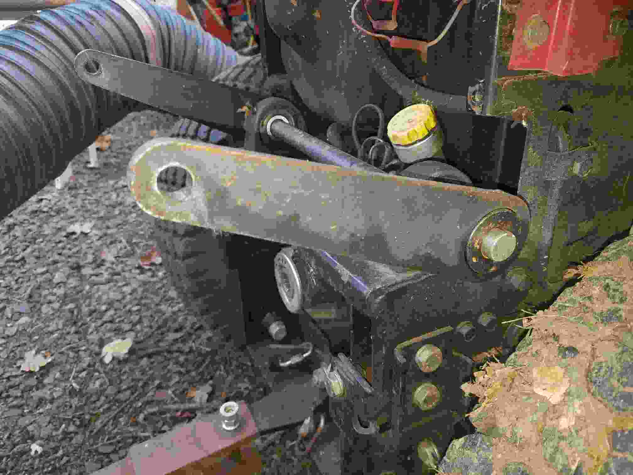

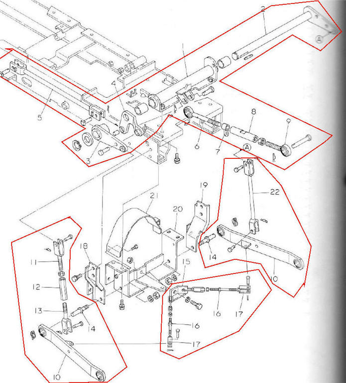

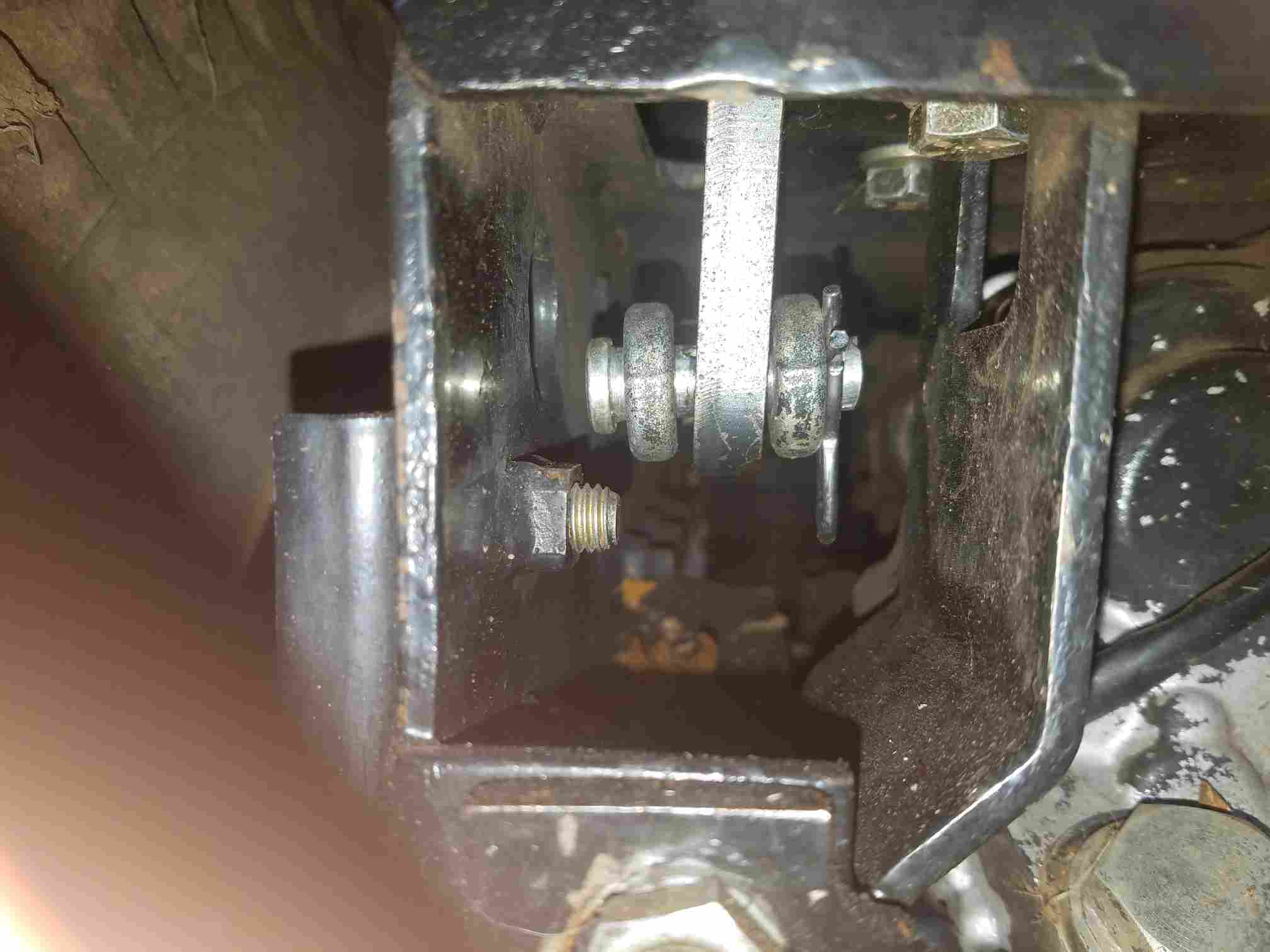

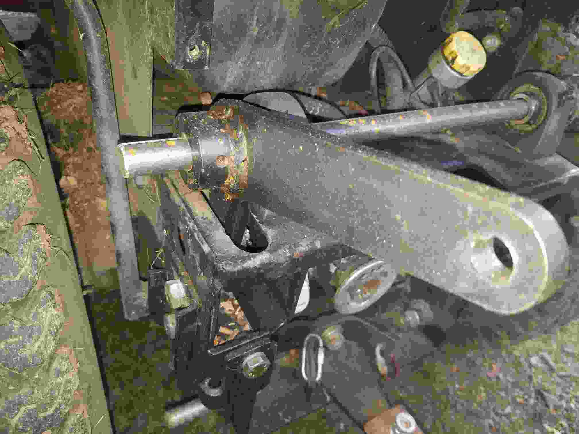

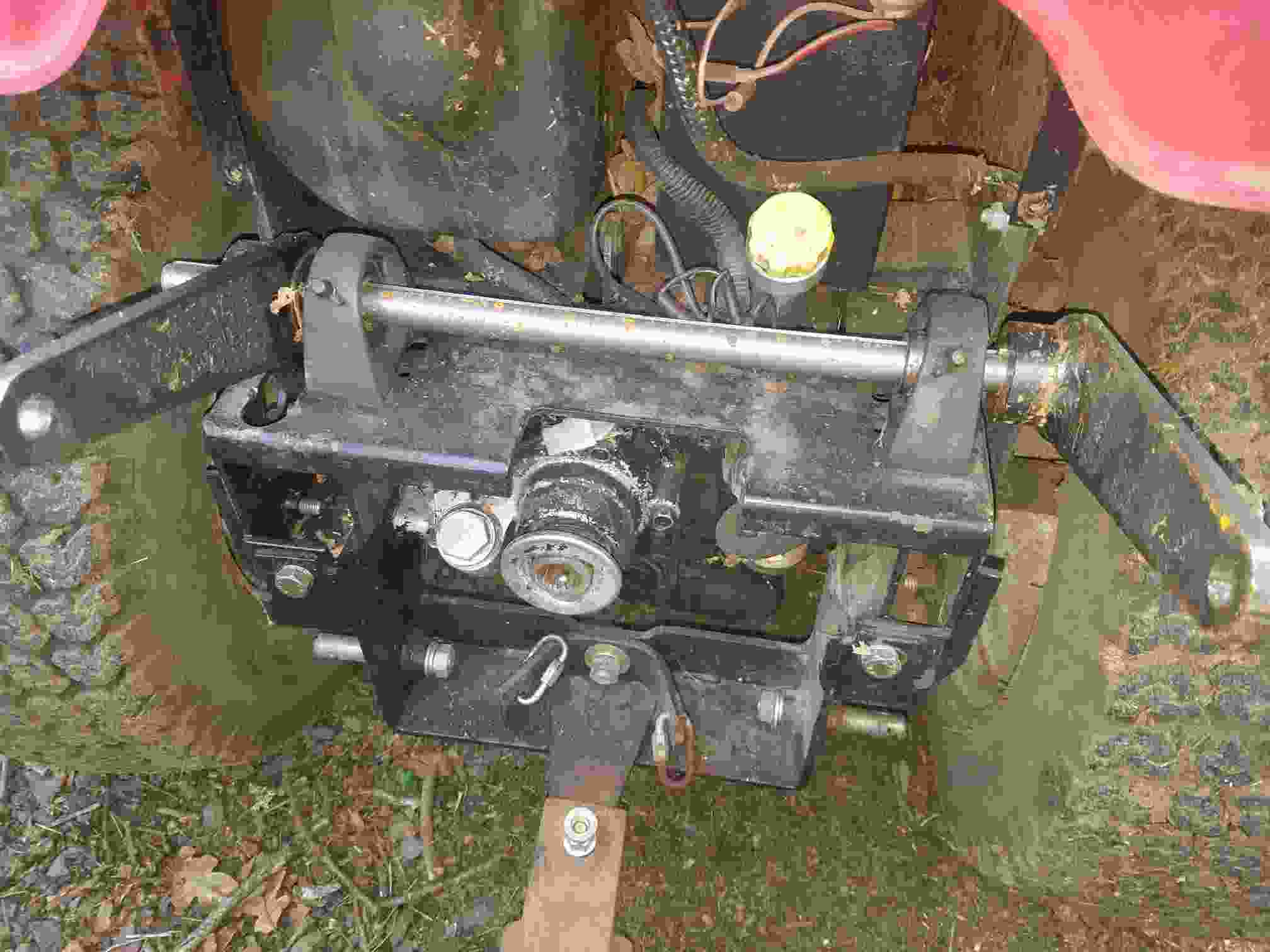

Ok here are some pics of what I have done. Years ago a forum member sent me a pic of the schematic. I used these to figure out a way to fabricate the hitch.

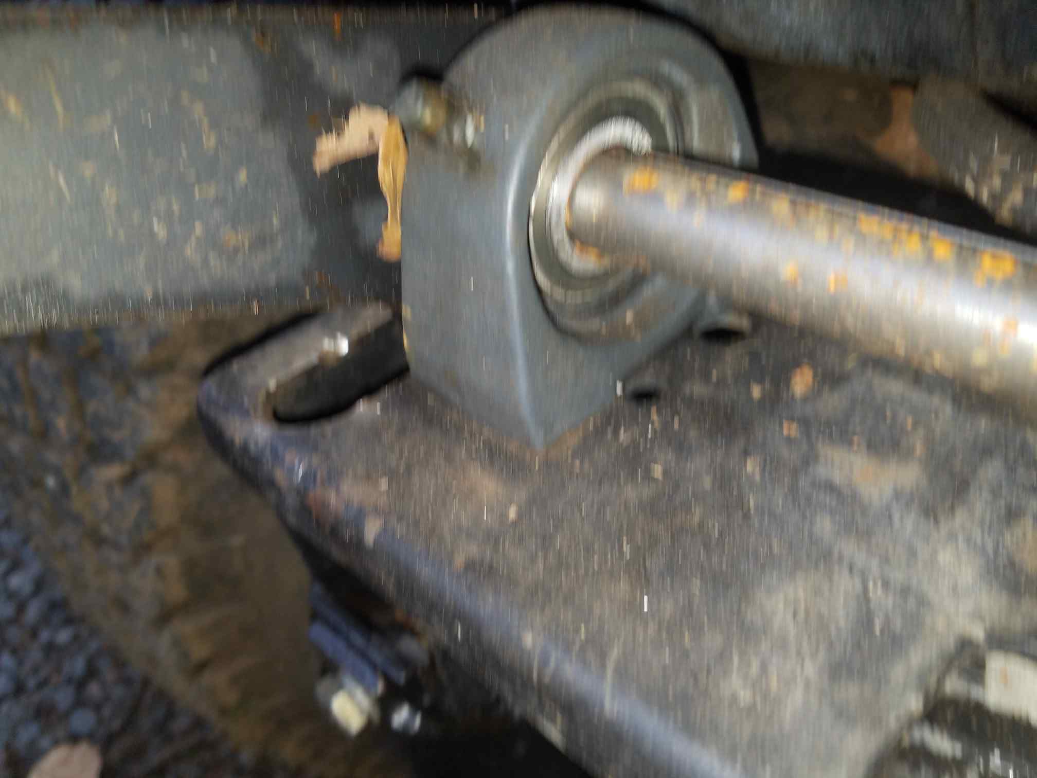

I started by using pillow block bearings to bolt onto the hitch of the tractor. I used a 3/4 round rod with a keyway as the shaft.
Next I had my high school use Cad to draw the lift arms then laser cut these parts. I then welded these lift arms to weld on hubs and attached to the round rod to lock in place.
