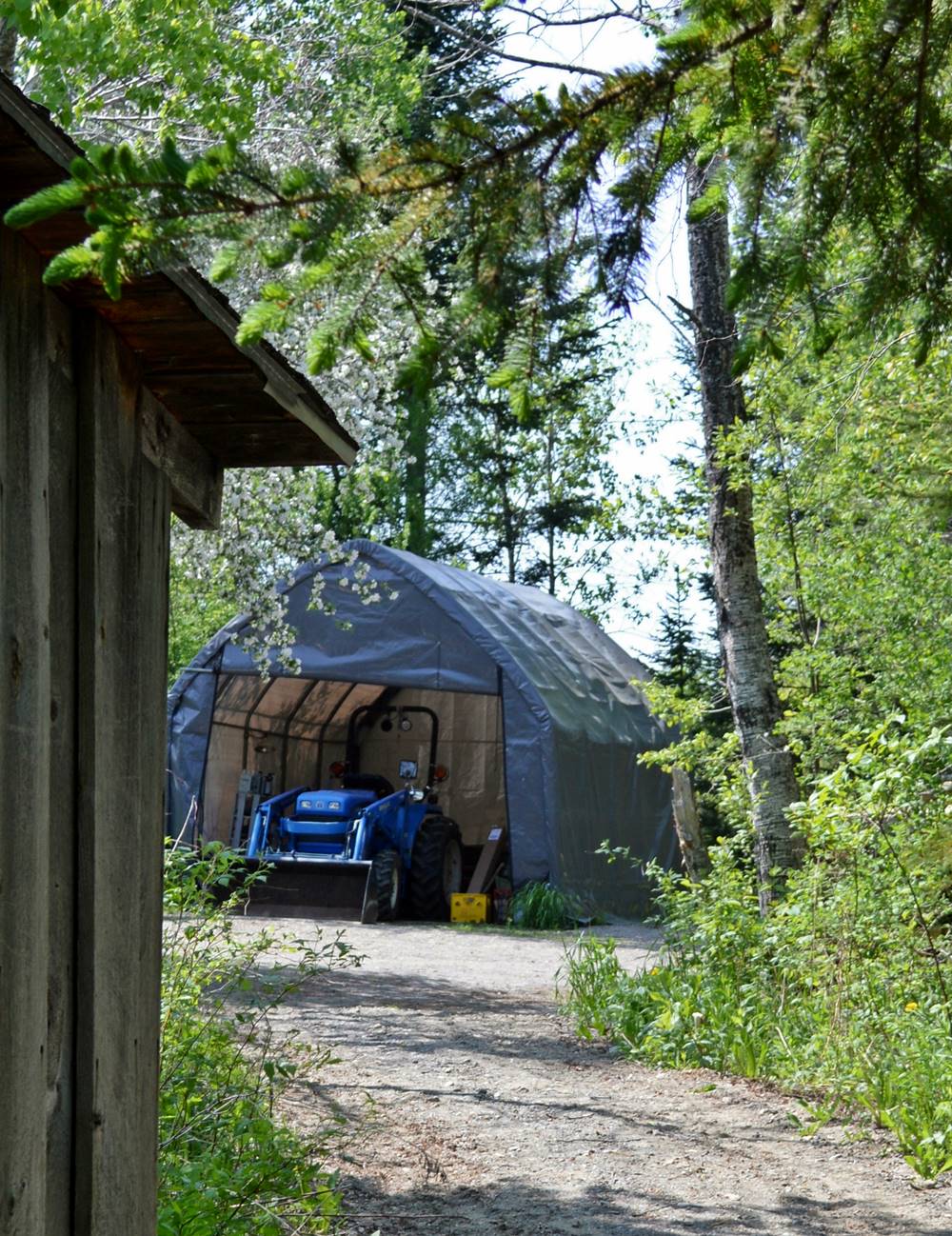

/ Fabric tractor shed #24
Helped my neighbor set up one of the shelter logic hoop type shelters this spring to use as a temporary tractor shed. The construction was a lot more robust than the gable end shelter of mine that flew away in the wind storm. The ground anchors were also much, much more robust.
We moved it recently from my place over to an area he had cleared on his property. Simply picked it up with ratchet straps hooked to the ROPS and chains hooked to the FEL, and drove off with it. Went slow, felt like I was a giant turtle with tunnel vision of only what was straight in front of me! We had to pull the anchors with the FEL, I was worried that the auger plates would get stripped off, but they came out with minimal damage.
I did note that the fabric cover seemed to rip fairly easily if not handled carefully, this was at some of the stress points at the seams and corners when we were installing it.
Covering it with metal as Ruffdog has done would certainly make it a lot more durable.

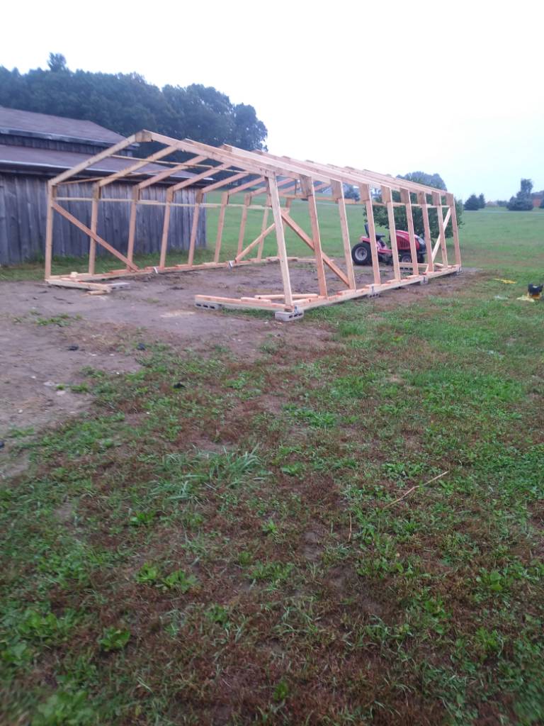

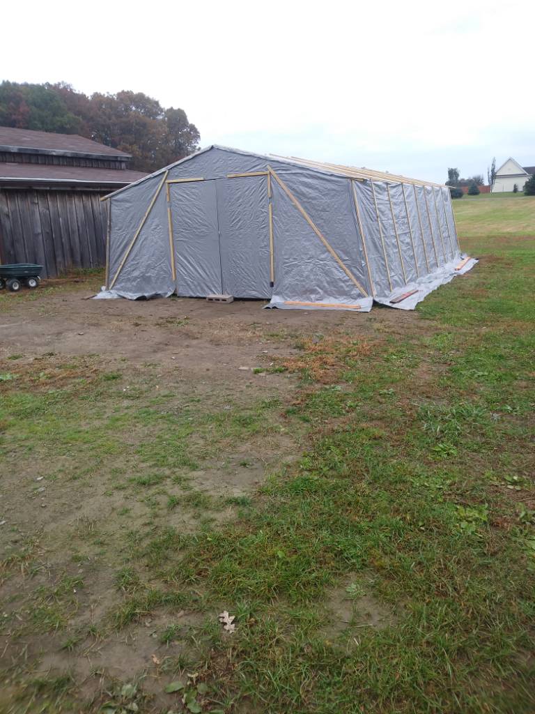

I am also in the process of a temporary fabric structure. Mine is a home brew 16x24 and I should come in on cost around 500.
/ Fabric tractor shed #31
Looks real good to me. What cha goin' to cover it with? Probably still should have some anchors though.
Cheers,
Mike
/ Fabric tractor shed #32
Currently I have all the the foundation blocks fastened to the structure with heavy galvanized strapping, I cannot budge the thing. I have some diagonal braces in each of the corners which I can run some ground anchors through for a bit of extra security or I can add some more blocks.
Cover? I went down to the local HF and bought a 28x39 9 mil tarp. The plan to fasten should be on the order of greenhouse film.

/ Fabric tractor shed #34
/ Fabric tractor shed #35
Thats such nice wood framework to just throw a tarp over it. Do you plan on puting metal on it?
/ Fabric tractor shed #36
Yes there is a future plan to have the building be permanent on a concrete pad with proper sheeting. I used nothing but screws so disassembly is possible without damaging anything. The only things not reusable are the tarp and the exterior roof ribs as I put adhesive on the ribs to bond them to the tarp.
