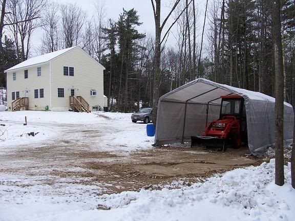

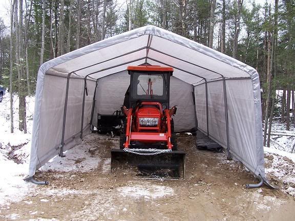

Timber,
I had the exact same one but different sized. I am sure you noticed that all the joints are just put together and the large tarp that serves as the roof and sides keep the tension on the whole thing. I noticed the whole thing was a little flimsy when I first set it up so I bought a box of self-tapping screws and put one in every joint where a pipe went into a connector. I highly recommend it.
Here it is covered in snow:
I couldn't leave the front door on because my cab is too high.
