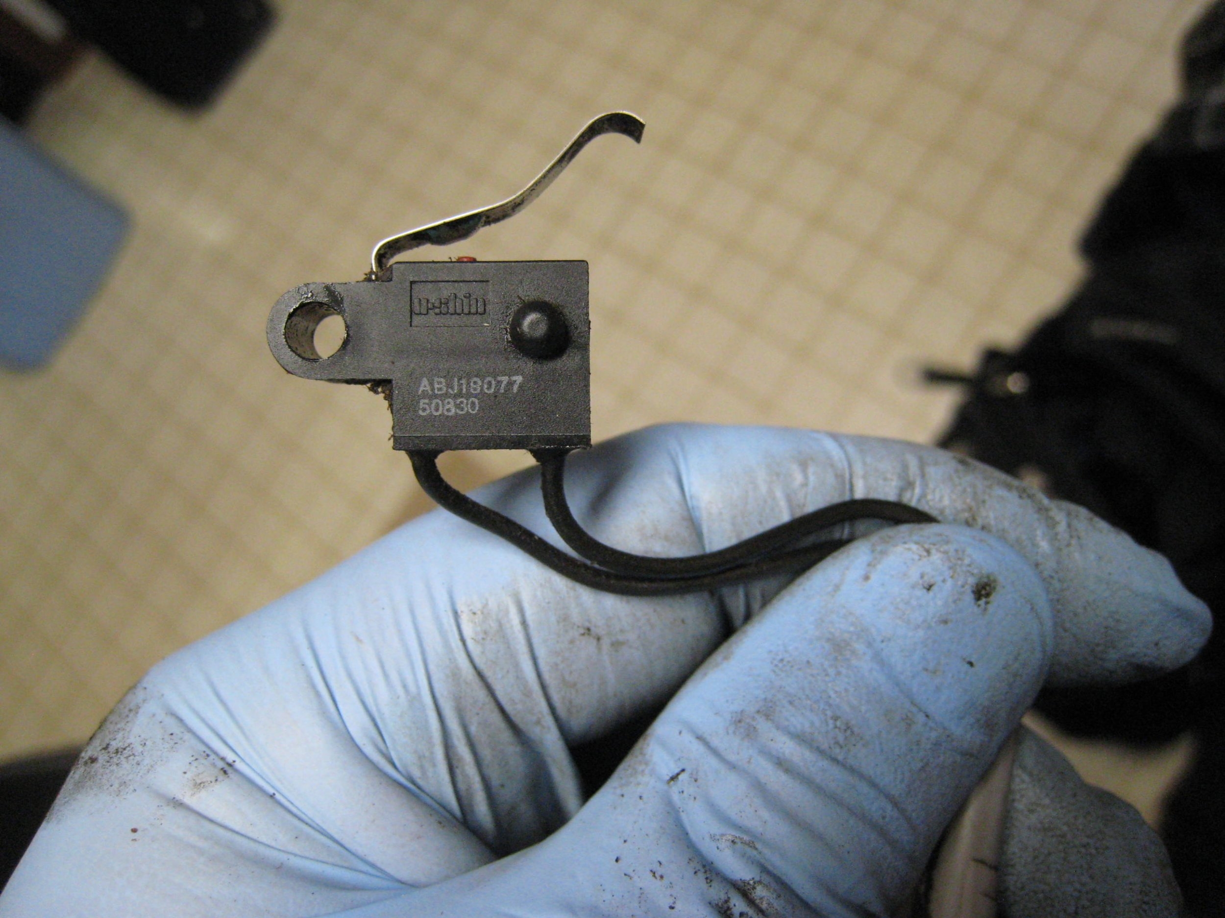

After mowing couple of hours little over week ago I had a no start from the key switch issue and had to take out a multi-tester & the WSM in order to troubleshoot - here's what I found out:
Since I was able to start the engine with a jumper wire from the starter solenoid, I decided to check the key starter (main) switch next and just follow the procedure in the WSM, but all steps checked out fine and the switch was fine. Oh well, I wanted to vacuum clean that area of grass clippings anyway.
Next on my list was checking the seat, PTO & brake safety switches in that order.
  • Seat switch had continuity when seated, which is how it's supposed to be.
  • PTO switch had no continuity when PTO was off, which meant it was faulty!
  • Brake switch had continuity when brake was on, which is how it's supposed to be.
It turned out to be a minor adjustment problem in the PTO safety switch "spring" arm - ordered new PTO & brake switches for the next time.
The PTO safety switch is in little awkward to reach spot, but it can be accessed and removed for testing & adjustment without removing the fender.
I have no idea how much it would cost to have this type of minor issue be diagnosed and repaired by authorized dealer since I have never used their services except getting few parts.
PTO and brake safety switches are very similar (same?), except the wire connectors.
Brake micro switch shown:
That switch looks similar to the parking brake light switch on my L48. The light was not working when I bought the tractor, but figured out it was just the spring adjustment was not allowing continuity when the brake lock lever was applied.
Doug
   / F3060 Not Starting From the Key Starter Switch!
Doug
Yeah, probably the same switch but a different wire connector & part number. I think that would make it little harder for the aftermarket competition to figure out & provide easy alternatives, but I am sure OEM would have a different explanation...
Oh well, suppose I should just be happy I was able to buy a spare switch for $35.50
19 different Kubota F & Z models use this same switch & connector IE. Have the same part No.
