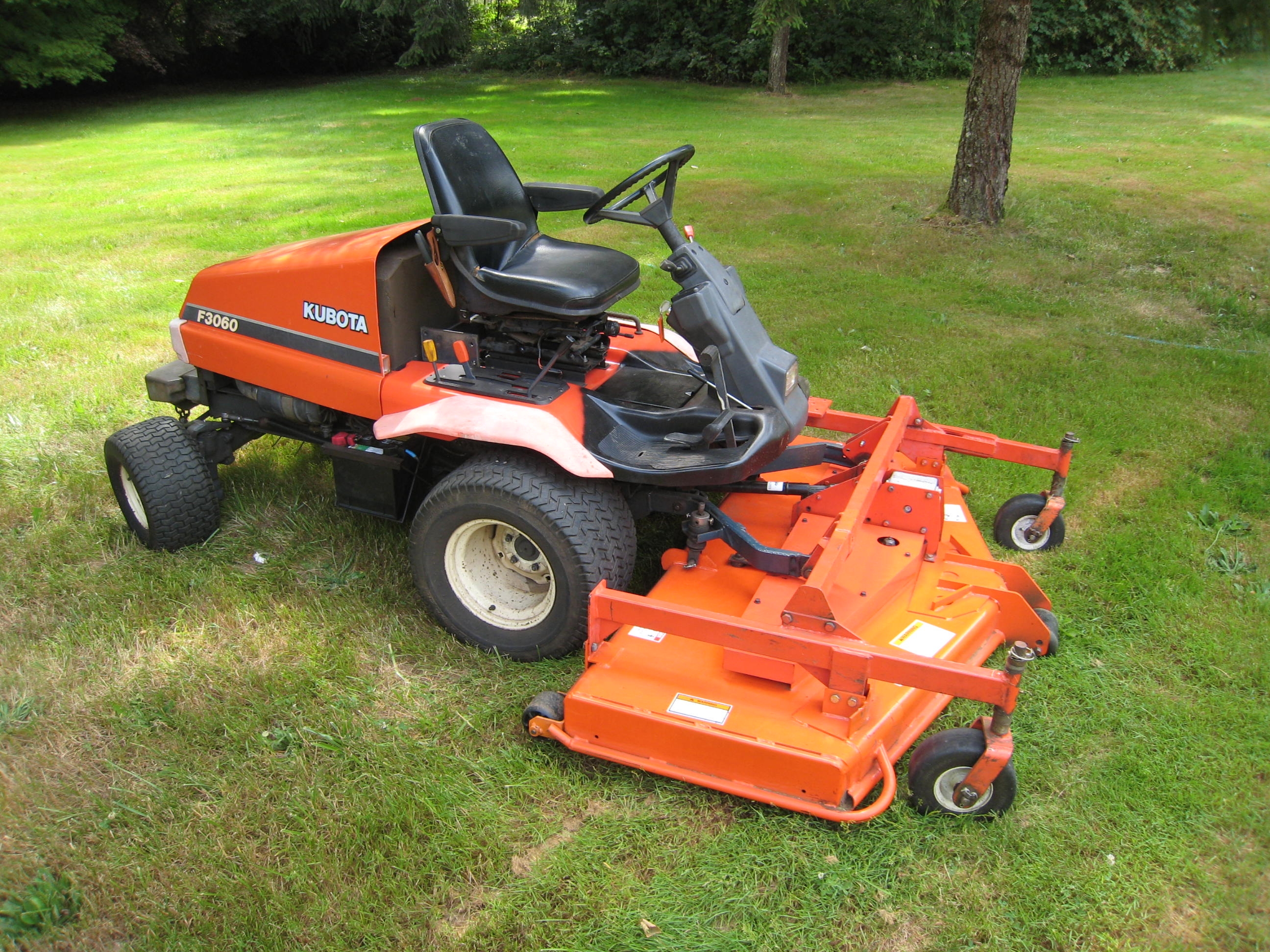

F3060, L3600 GST
Anybody do this and have any tips on how to actually get to both of them? My machine has all the options including the 24 x 13-inch-wide tires and the high dump grass catcher.
Looks like I may have to remove the grass catcher blower unit to even get near the darn things and maybe the front wheel as well.
Would be great if the tractor deck was easy to lift or remove!
/ F3060 Fuel Filter Change #2
The deck is easy to remove, if you think it needs to come off. The owners manual explains it pretty well, if you need explanation.
I don't have the optional grass catcher, but I do have the large tires. I don't think I had to take a wheel off. Or remove the deck for that matter.
It's a little awkward to do, but not terribly so.

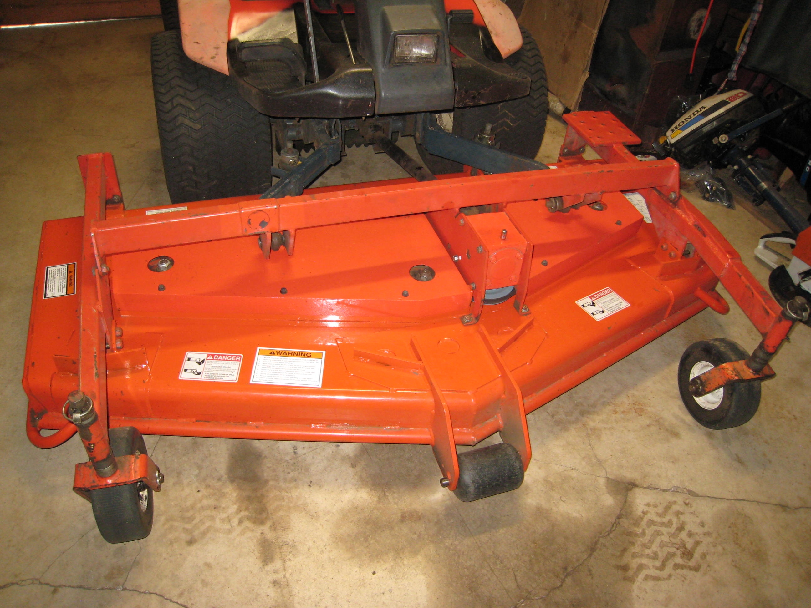

Mine has wide tires also but no grass catcher and getting to fuel filters is not really that difficult.
It's a 72" rear discharge deck with a generic 90 degree bevel gearbox and no need to change the gearbox oil seal, but you may have different model deck where the middle spindle is directly connected to the gearbox?
Yes- your deck is different than my 72-inch side discharge. Middle blade is mounted on the gearbox vertical shaft. Shop manual sucks regarding seal replacement- only shows gearbox disassembly. I would hope the seal can be popped out and replaced without going full disassembly. For now, will stick to more frequent checking of the oil level. Even synthetic gear oil is not that expensive for an ounce.
Boy your mower deck is REALLY clean.
