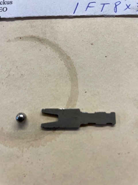

Good Day,
I replaced ps hoses on my f2690 and where they attach to the lower steering control valve the fittings that go up into control valve came out and so did a little metal plate and a steel ball. I put the steel ball and plate back up in and put hoses on and now I have no ps ,does anyone have a diagram ?

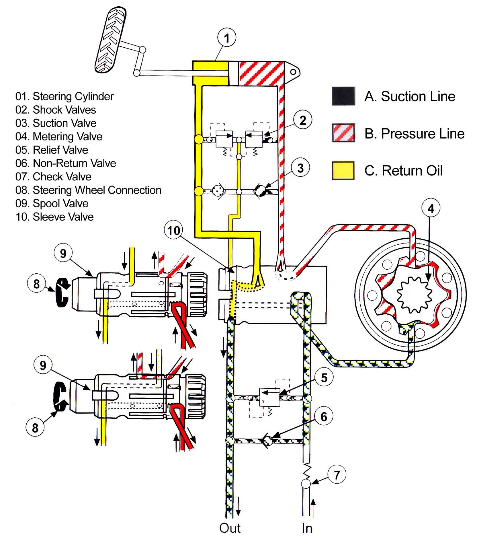

No diagram, sorry. And not a separate part apparently.
A generic diagram;

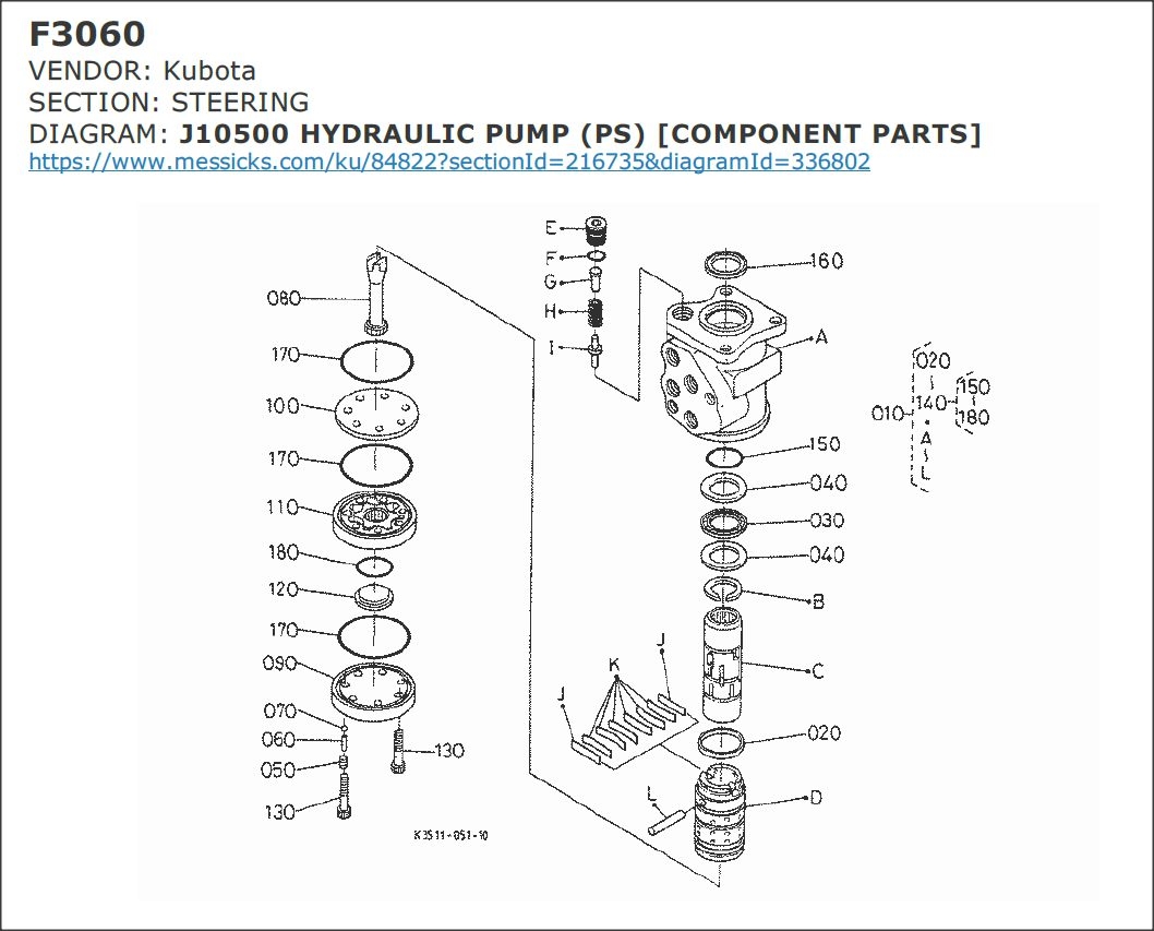

Not sure which make & model steering control unit you mower has?
The one in my F3060 is Orbitrol (Sumitomo Eaton Hydraulics Co. Ltd.) and the last time I checked few years ago the dealer price was about $1700 for new unit, so I would be be careful.
Seal kit etc. were available for Orbitrol from Midwest Steering (Midwest Directional Services, Inc.)
I would recommend getting a Kubota service manual (WSM) before proceeding any further!

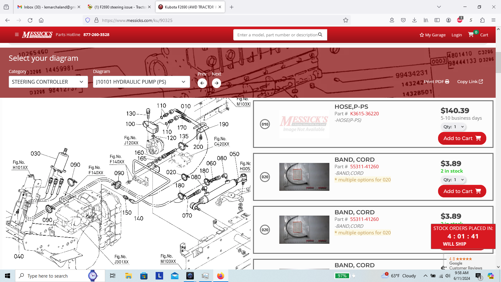

/ F2690 steering issue
Thank you , Kubota from the aftermarket is around 975. pn 6C200-41102
