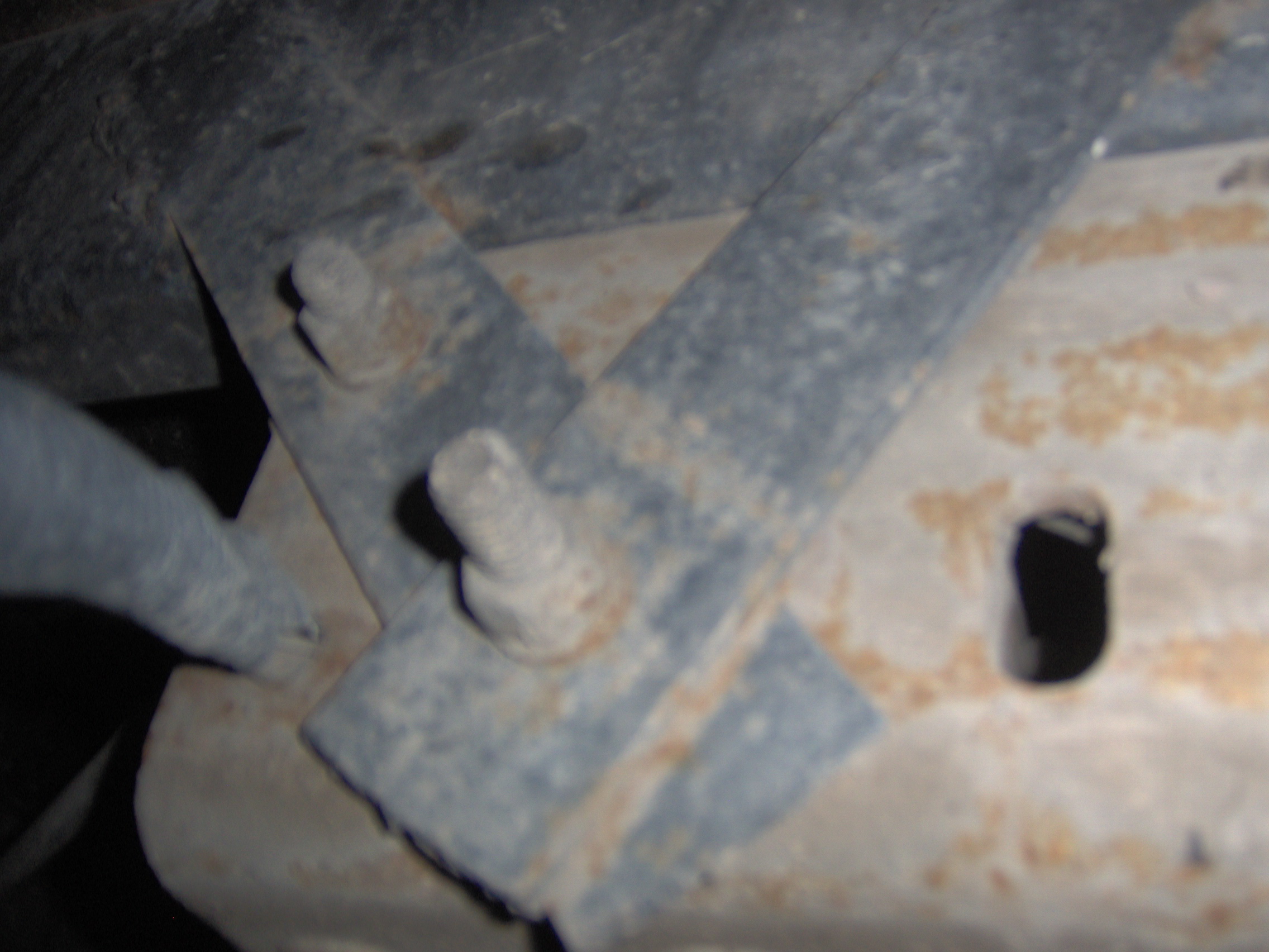

I would wan't the hitch bolted to the frame at least. As was mentioned above the straps mounting the bed should be angled rather than vertical. In use the straps are
going to be stronger in tension if the body is hit from the rear. When I build truck bodies I attach the straps at an angle using existing frame holes, you might be better off to simply add them correctly at this point.
Here is a pic I snapped on a service truck outside tonight.

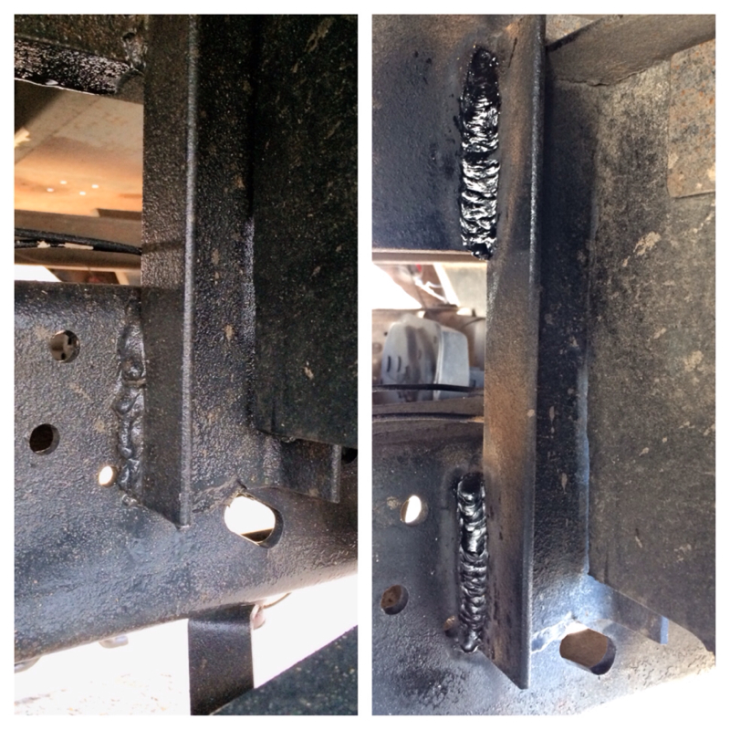

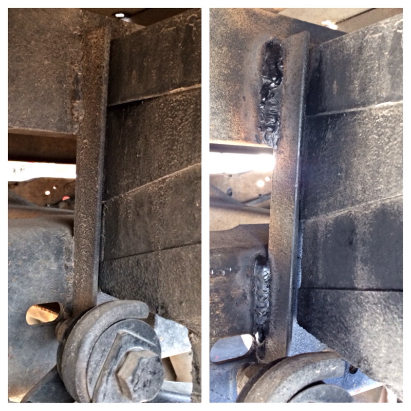

Well, had the welds redone on the truck this week.
Here are the before and afters, side by side. Easy to see the new welds are a LOT better. The shop guy said that when he started grinding down the old welds, pieces just began flying off. Clearly the original welds weren't too strong.
I feel a lot better hooking onto a trailer now!

Those welds look a little cold to me . Get that hitch reinforced , turn up the heat .
